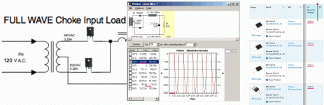

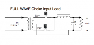

The hammond transformer rectifier guide says to select rectifiers that are 0.45 * VAC. In this case, the secondary is 1780VAC center tap (890VAC per leg). Should the rectifier be sized for 0.45 * 1780 or should it be 0.45 * 890?
Notice the attached diagram. Is the rectifier anode and cathode wired correctly? The anode is connected to the secondary while the cathode is connected to the choke. Is this correct?
Finally, will the hexfreds generate heat and if so, do they need to be mounted on a heat sink?

I believe you may want to read the guide again. I think it says when using a full wave rectifier the reverse voltagee rating needs to be greater than 1.4 X VAC That .45 X vac was refering to the output voltage across the cap.
tubesoiliron, if you don't provide any detail on why you want to make the change, and the power supply and amp you are making the change on, and the amp's operating conditions, then others won't know if any advise is good advise or bad advise, or have a clear picture of why you are choosing a particular design path.
Type 866 were always operated into a choke input, so you'll want to prepare for its inductive peak voltages under all conditions. Modern rectifiers won't safely handle big voltage transients without using several in a series string, each having a voltage equalizing (for the reverse voltage condition) resistor across it. Resistors also have a voltage rating, so you'll want to study up on that, and on some high voltage capable insulating mounting.
Old amateur radio ARRL handbooks are a great source of information about this - 1960s era maybe. And a schematic of what you're working with is essential for any real advice.

Here is a free program but it will take a little work to understand it. But as Chris just pointed out you may need a very high voltage rectifier. I just played with it but without a lot more data than you have like the resistance of the transformer, what size choke you are using and so forth it can't give exact reports. But one down and dirty simulation hinted that you may need a pair rectifiers rated at over 5,000 V.

890VAC rectifier choke, you need twice the peak voltage, so 2,516V PIV.
(The "Hammond chart" is wrong in several places.)
The wise designer adds LOTs of overhead to this to cover line-spikes and the unexpected.
The highest rated HEXFREDs I found in a quick search are 1,200V PIV. So even two in series may not do. (I'll grant the 16V over but I do not know if HEXFREDs in series will share voltage nicely; some series-strings the weakest link fails first and then the others burn.)

The voltage expectancy will not change much more as 0.9XACvoltage but the peaks you will have with choke input filter, needs many in series diode with resistor and capacitors in parallel.

At the price listed, you could also pair them up, use 4 of them for the circuit shown above. 2 on each leg, with a 2.2 MΩ resistor in parallel, to each one. Back current is 0.314 mA, peak. Each rectifier max reverse VR is about 1,400 V. Easily within specification limits. But if you're still worried about the choke-input do-wah down-wind and its reverse flyback EMF, well .. put 3 in a string on each leg, with 3 ea., 2.2 MΩ resistors in parallel.
The resistors need only be 1 watt devices.
