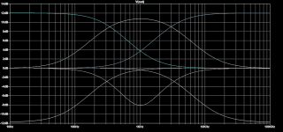

However, there's a crucial aspect I'm grappling with—namely, the impact of phase shift on the output signal. I conducted simulations of the circuit in the frequency domain using LTSpice, and the results showed a satisfyingly flat response but also a notable phase shift. To delve deeper, I decided to inject both square and triangle waves into the isolator, maintaining the knobs at the 50% mark. What I observed was a distinct alteration in the signal compared to the input waveforms.

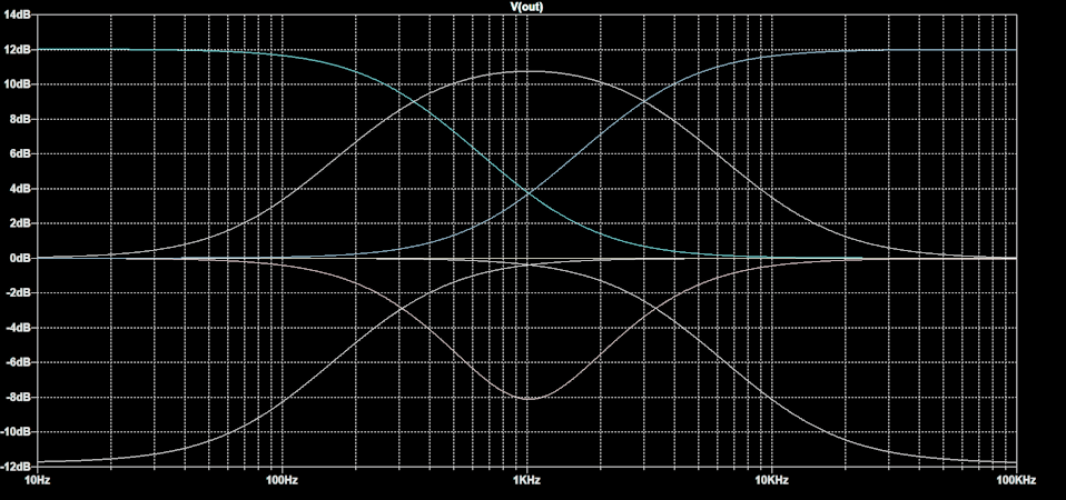

I've attached a zipped folder with two versions of a three-way EQ circuit that is inspired by an article in HiFi News many years ago called the Versatile Synthesised Tone Control. My version uses just two capacitors to derive three level-adjustable bands. The LF band is built on a simple low-pass circuit. The HF band is built on a high-pass filter. The killer feature of this circuit is that the mid band is created with no further filters, rather it is derived by subtracing the low and high bands from the wide-band input. When the three bands are mixed, if the controls are set for a flat response, then there is no phase shift.

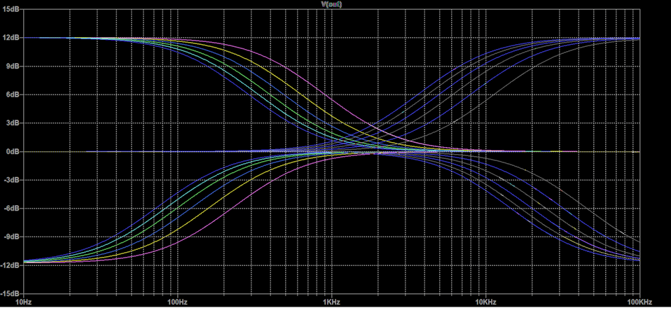

Version 2 expands on version 1 by making the crossover frequencies adjustable. This requires dual-gang pots for the two frequency adjustments, so the circuit would be difficult to make in a stereo version, as this would require quad-gang potentiometers. The circuit is, however, quite feasable for a mono mixing desk strip, or a mono instrument amplifier.

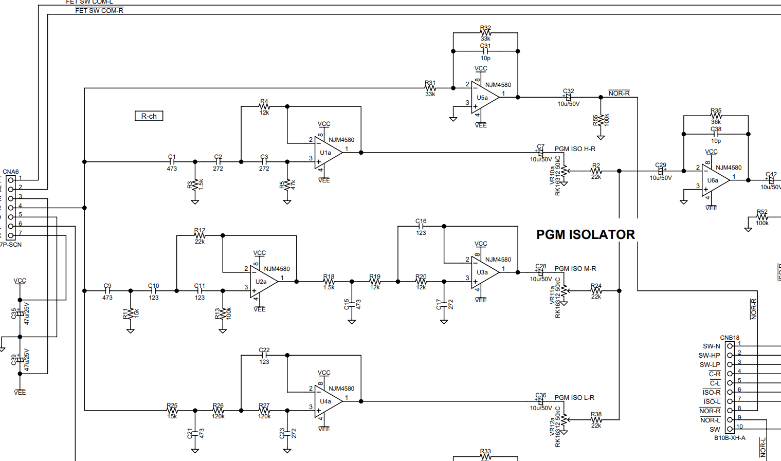

It looks like this approach keeps phase coherency. However, there is still something puzzling my mind. The fact that many well known commercial DJ mixers use the ESP circuit or a variation of it. Here the Vestax PMC-CX, one of the most respected products out there:
If you look for the Allen Heath Xone:42 service manual you will also see a very similar circuit to ESP. I simulated all three and they all have the same phase characteristics. I started reading some documentation on EQs and the common viewpoint is that all EQ introduce a certain amount of phase shift but in application like music playback this cannot be noticed.

My own version, FWIW, is a minor improvement on the original in that I reorganised/rationalised/simplified the filters and was able thus to get rid of one of the capacitors, but with exactly the same frequency response. This opened the route to adjustable turnover frequencies, which would be much more difficult with the original circuit.

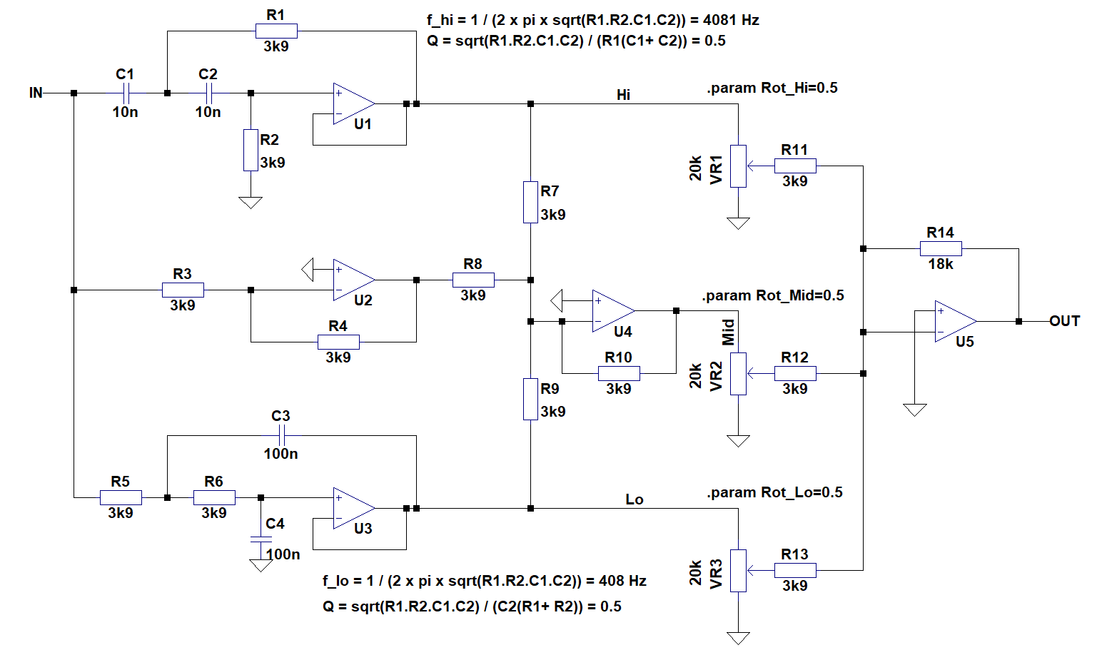

Looking at Rod Elliot's Isolator circuit, although the HP and LP filters are well-behaved equal component Sallen and Key filters, the mid section looks like a bit of a kludge, seemingly cobbled together empirically to get the flattest response with all controls central. It is the mid section that causes the large phase distortion.
It is, however, possible to derive the mid section by subtracting the HP and LP section o/ps from the unfiltered signal. The mid section only has first-order slopes, unlike the HP and LP sections, which have second-order slopes, but one is now guaranteed: a) the mid section exactly fills the "gap" between the two outer sections, regardless of the frequencies chosen; b) the frequency response is guaranteed to be ruler flat with zero phase distortion with the controls all controls central and regardless of the frequencies chosen. Moreover, dual pots can now be used to control the turnover frequencies - the mid section automatically expands or contracts to "fill the gap".

@Ludus Tonalis forgot to comment, the drawback I see in this alternative circuit is the fact that it is made of first order filters, with 6dB per octave. This would give different results compared to the common isolators used in mixers.
Personally, I don't think that first-order filters are a drawback for EQ - but the circuit posted in my previous reply mostly gets round this.
