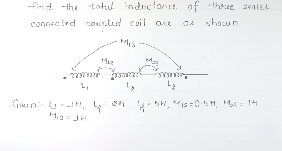

Assuming a transformer with a split primary and a known end to end inductance, I feel pretty good about the following.
Total primary inductance is made up of L1+L2+2M
M = K √(L1 L2)
Where I get lost is more than two series primary windings on the same core
Assuming I have 4 windings in the primary and want to work out M, would it be
M = K √(L1 L2 L3 L4)?
Is total end to end inductance then L1+L2+L3+L4+2M?
Assuming I am wrong with the second half (Likely) can you help me with corrections to the formulas?

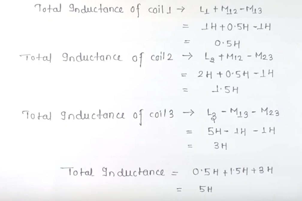

Not necessarily. If, in example, one set of turn is reverse wound, inductance is null.
What you need is to write down an entire set of equations and solve then. If you have L1, L2, L3 and L4, each one of them will have a particular k to the others. Assuming that all them are wound in the same sense and in a common core, k will be close to 1.
The formula squaring root of the product of the 4 inductances is wrong as it gives values of Hy^2 which ovbiously isn't inductance. At first time I would be near the sum of the dual products and sqrt of the 4 members added.
