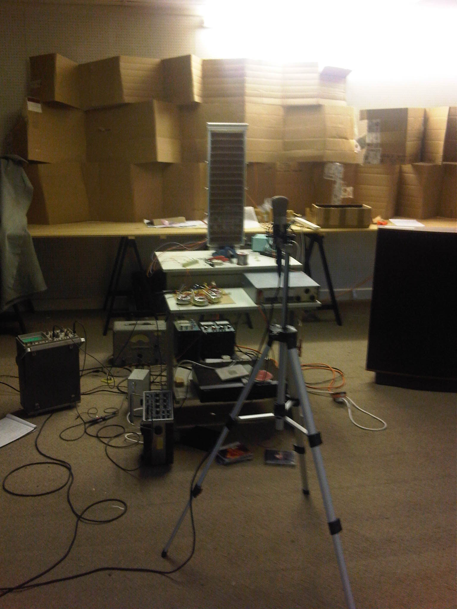

I have finished my esl panel Which Im very happy with, its 5kv biased, 200mm x 600mm and performs very well 700 -20k cycles. under 700 its down and under 300 its very down - due to its small size. I could add more and more panels (like my esl63's) but I want a small pair of speakers.
Im thinking of having 6" drivers under my panels
can someone recommend a suitable driver?
how should I do my cross over? I have so many ideas that now I need some input and advice.

Could you test the panel in a much larger baffle and see if the drop-off is the panel or the non-enclosure? Far easier to add plywood than to add panels, even if you need to add some boost.
Could you establish if the SaranWrap is flapping at 500 Hz or where ever or where is the necessary bottom end you could play down to?
BTW, the Dayton-Wright panels look like yours. Each D-W speaker has 8 mounted on the surface of a sphere - to simulate a point source (the "origin" of the sphere). I did a DIY speaker with 6 such panels and had no trouble playing down to 100 Hz, as I recall. They panels were mounted a few inches apart on a curved board about 30 inches across by maybe 50 inches high. Nice.

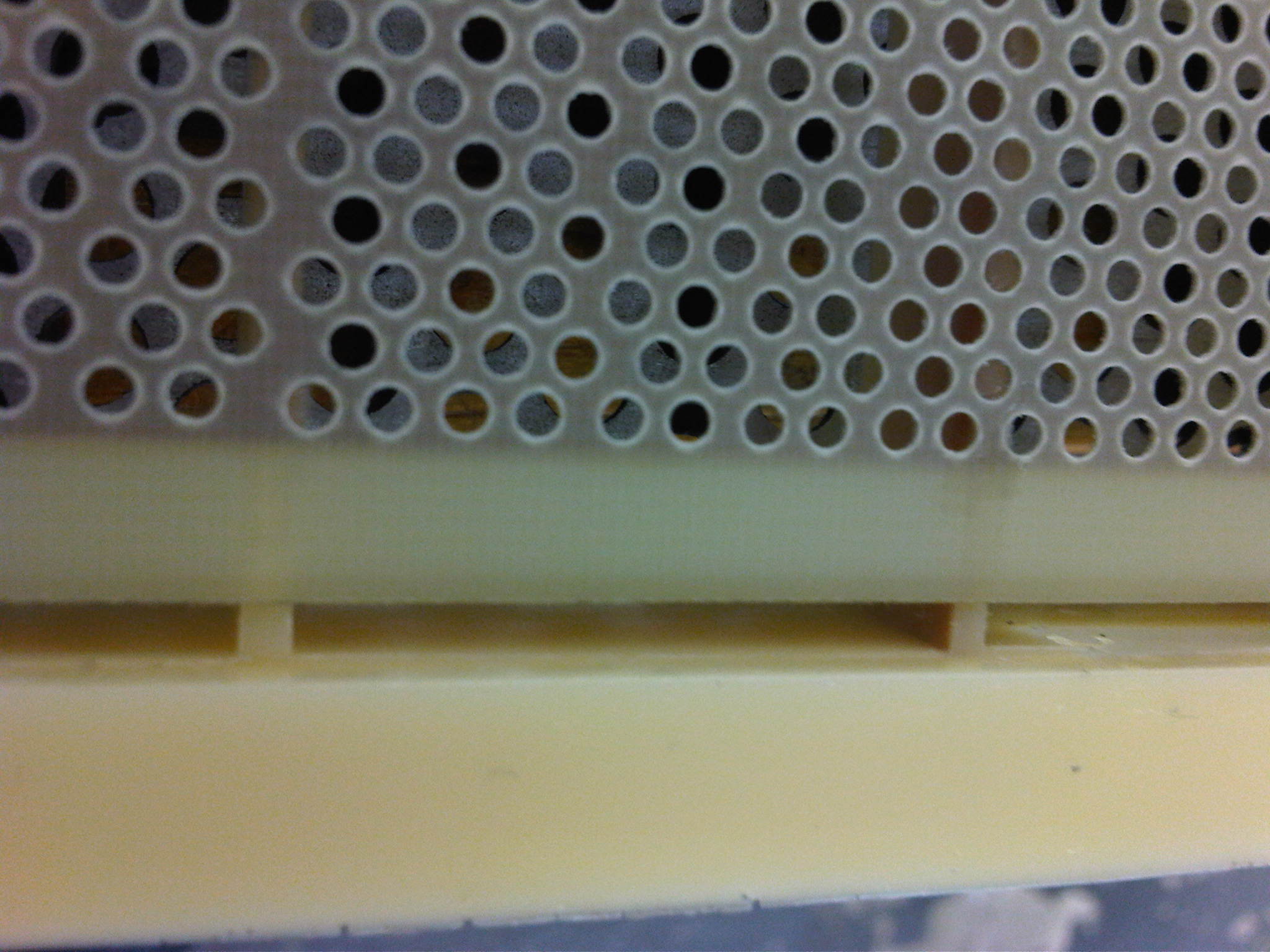

Hi Electros,
Your panel looks nice. Could you tell us what is the thickness of you spacer?

Hi Bentoronto -the panel plays down to 50 cycles(where the trannys saturate), it has resonance at 70 cycles - but aparts fron the resonance its well down below 300cycles.
I want to keep the panel dipole like the quads
Chinasettawong - the spacing is 2.5mm
