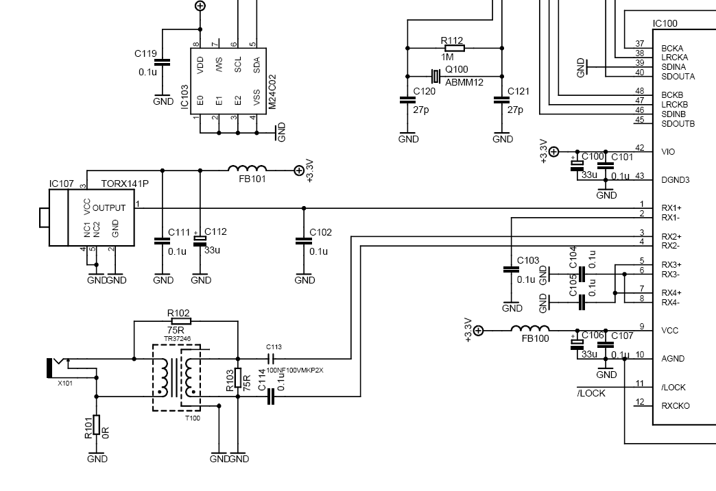

Hello all. I find myself in a puzzle.
I am using a DIY DAC built arround SRC4382 and PCM1792A.
I have used the DAC since 2 years without problems. I recently swapped my Audigy PC sound card for an M-audio delta 192.
The problem is that my DAC does not detect the SPDIF of the delta 192.
The DAC works with every other SPDIF output i can find at home ( old Audigy sound card, motherboard sound card, CD player ).
Also, the Delta192 outputs SPDIF correctly, because i connected it to a commercial build receiver and everything is in order.
I took a look on the SPDIF signal with the oscilloscope and everything seems to be in order, both on the SPDIF cable and on the SRC4382's input.
Between the Audigy's spdif output and the Delta's output i can only see a slighty lower p2p voltage on the delta 0,4V compared to a 0,5 V on the audigy.
I attached the schematic of the SPDIF input in my DAC

Other issue could be the slightly lower level. When I ran into this, I threw together a little box that took things to AES/EBU levels and the problem went away. You could certainly modify this for 72 ohm output if you want. Total parts cost was well under $10.
@Bill Fuss. The trafo is not defeated. R101 and R102 are not fitted. But the output windings are tied together by 75ohms. This is the connection example from TI's SRC4382 datasheet. I will try to remove this resistor when i get home and see what happens. You might have something here.
@SY. The level is more than 50% lower, but the thing is that the SRC4382 datasheet states that the minimum acceptable voltage ( unless i am mistaking ) between the RX+ / RX- input pairs is of 150mV. I can measure at least 400mV here. A level boosting unit would be my last resort.

R103 is the proper termination for a 75 ohm line, unless you used other than a 1-1 pulse trafo.
