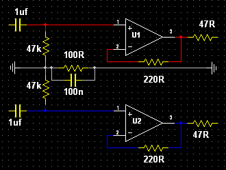

Im building an opamp buffer for my Icepower 50asx2, as suggested by the designers manual.
Im having trouble deciding what type of cap's and resistors I need to buy for the circuit, The costs are starting to add up rather fast.
I'm planning on running 2 OPA2134's
What sort of caps should I be using (mylar, polly ect)
and what wattage resisters should I also use.
The circuit is going to be fed from the 25v +- aux supply via a 25-12v +- regulated power supply once again, from the designers manual.
Here are some schematics of said circuits.
Thanks !

Hi
Resistors considering this is a preamp need only to be 1/4 watt, which are readily available.
You could also use surface mount if these are available and you have skill to solder them ie 0805 size
Caps if saving cost can be electrolytics, otherwise Jaycar sell crossover part poly caps. Ideally with audio path you need to avoid having polarity change with caps, which can be achieved with 2x 22uf electrolytics in series + - - + to make 11uf, or poly caps which are bipolar. Other smaller caps can be MKT types.
Suggest you make separate boards for PSU and opamp components.
Hope this helps

Hi, you don't need the other OpAmps & components just to buffer !
You are dividing the signal by 2, then amplifying it by 2 = same out as in
Here's all you need, unless you Actually need some gain ? If you do, just say how much & i'll let you know what to do.

I actually need low-noise preamplifier with amplification of 5:1 to connect to IcePower 50ASX2.
The reason is that the 50ASX2 has only 20.5 db gain and it's obviously not enough for some devices.
I also need volume control in front of 50ASX2.
This preamp (I replaced ne5532 with lt1364) sounds good,but is a little bit noisy:
"www.ebay.com/itm/NE5532-Amp-preamp-PCB-board-Components-Kit-F-TDA7293-LM3886-Small-Potentiometers-/300719020966?hash=item4604401ba6"
I also read somewhere in this forum, that if you connect volume pot directly at the input of 50ASX2 the input impedance will be substantially jumping along the audio frequency range....
So, any alternatives are more then welcome

I know I'm asking a very stupid question, but what the hack do we need the buffer?
There are no stupid questions, but there are certainly teachers who don't get it.
Generally speaking, in audio the purpose of a buffer might be one of two, and they're related:
- To get from high impedance to low impedance.
- Separation between stages, to prevent components over there from affecting components over here.
This very high Zin is accomplished by running 100% feedback, which is called "a Beta of 1." To give a for-instance, an NE5532 all by itself has a worst-case Zin of some 30k. But wired as a buffer its Zin shoots up into the megohm region. A TL072, which already has megohm Zin, wired as a buffer effectively has infinite Zin.
Note that only 100% feedback and unity gain identify a buffer. Others might argue this point.
i am also preparing to build this opamp buffer. my question is if i want to add volume control, can i just add a pot between buffer and the source?
You'll get different opinions on this. I vote yes, it's OK to just hang a pot on the front end, as the expression goes. The two classic values are 10k or 50k, maybe 10k would be better unless you have others lying around, in which case run what ya brung.
If you're buying, don't forget that you need dual pots for stereo, and volume controls are customarily log taper, not linear taper.
