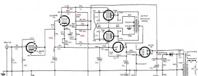

I'm currently getting all the parts together to make a valve amp and I am a little stuck on the output transformers.
The specs say to use 6600ohm push-pull transformers rated at 30-40w.
Here in Japan, it's very difficult to find that value. 5000 and 7000 ohm are everywhere though (I can literally buy about three or four different brands of them off the shelf from multiple shops in Akihabara...)
I have 7591 output tubes, but I'm not sure if I can use the 5000 or 7000ohm transformers and what modifications I'll need to make to use them.
Can someone educate me? I'm new to all this tube amp stuff.

Yes, the tube manuals say to use 6600 ohms for a general purpose push-pull output stage with 7591A's. But this is a design center value and some variation is allowed. Since 7000 ohms is quite close, I would use that one. In general a lower impedance match will provide slightly more power along with a little more distortion. Conversely a higher match will give slightly less power with a little less distortion. These differences are small but measurable. The difference between the 6600 and 7000 will be difficult to hear if at all. No damage or strain will will occur from using a little higher or lower primary impedance match. For the 7000 ohm transformer no modification is required.
FWIW, I'm not impressed with that design, as it appears to be needlessly complex. The only thing I like is regulated 7591 screen grid B+. Net gain rates to be excessive, for use with modern, digital, sources. OTOH, the basic topology of voltage amplifier DC coupled to a "concertina" phase splitter and on to the "finals" is valid. That style of circuitry was used by many manufacturers of note. You can snip circuitry fragments from several old and not so old designs to get a very nice end result.
The O/P transformer is inside a global NFB loop and, as stated previously, 60 + W. rated "iron" is in order. Do the transformers you plan on using have ultra-linear (UL) taps?

This design has clearly been optimized at high frequencies for the original OPT. It's safe to ignore a small gain difference due to the 7K vs 6.6K primary impedance difference, but OPT substitution frequently introduces BIG changes in leakage inductance, stray capacitance, self-resonance frequency and Q, etc. You will probably be compelled to re-optimize the values of C1, C2, C3, C4, R7, and R8. This calls for a squarewave generator, scope, and dummy loads, as well as some skill at the test bench.

It might oscillate vigorously on your first attempt. If so, you will need to open the feedback loop and then add feedback incrementally as you adjust the HF tweaks. Check it without load and with some capacitive load as well. It should be free from oscillation up to 0.1uF at least, but it's more-or-less normal to see some overshoot and ringing with a hard C load.

Eico ST 70 uses 7591 and the OPT is 6K6 . I've a pair on my shelf for years.

I would not always trust the original design values....
I believe the 6.6K was chosen mainly because it was a very common plate load back in the day ...
Also because the Sylvania 7591 data sheets recommends it at those voltages to make 45W..
Examining the plate load for 400V screen...
The plate load choice depends on how solid the plate voltage will be during full power output....ie how much of a dip the plate voltage go down from 475...
Assuming your plate voltage will dip to 425V, a 5K plate load looks like a good choice...
Assuming a droop to 450V...still your under 6K for nice fit plate load...
Calculation comes up exactly 50W...
The 6.6K is a bit safer for average plate dissipation on the tubes during AC operation..
