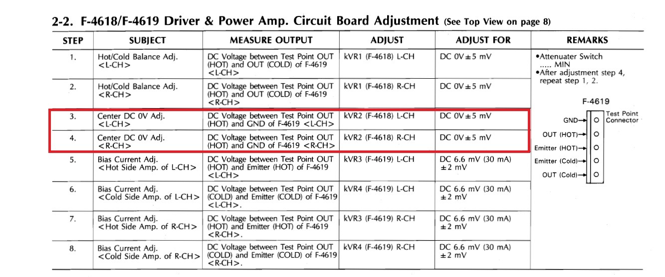

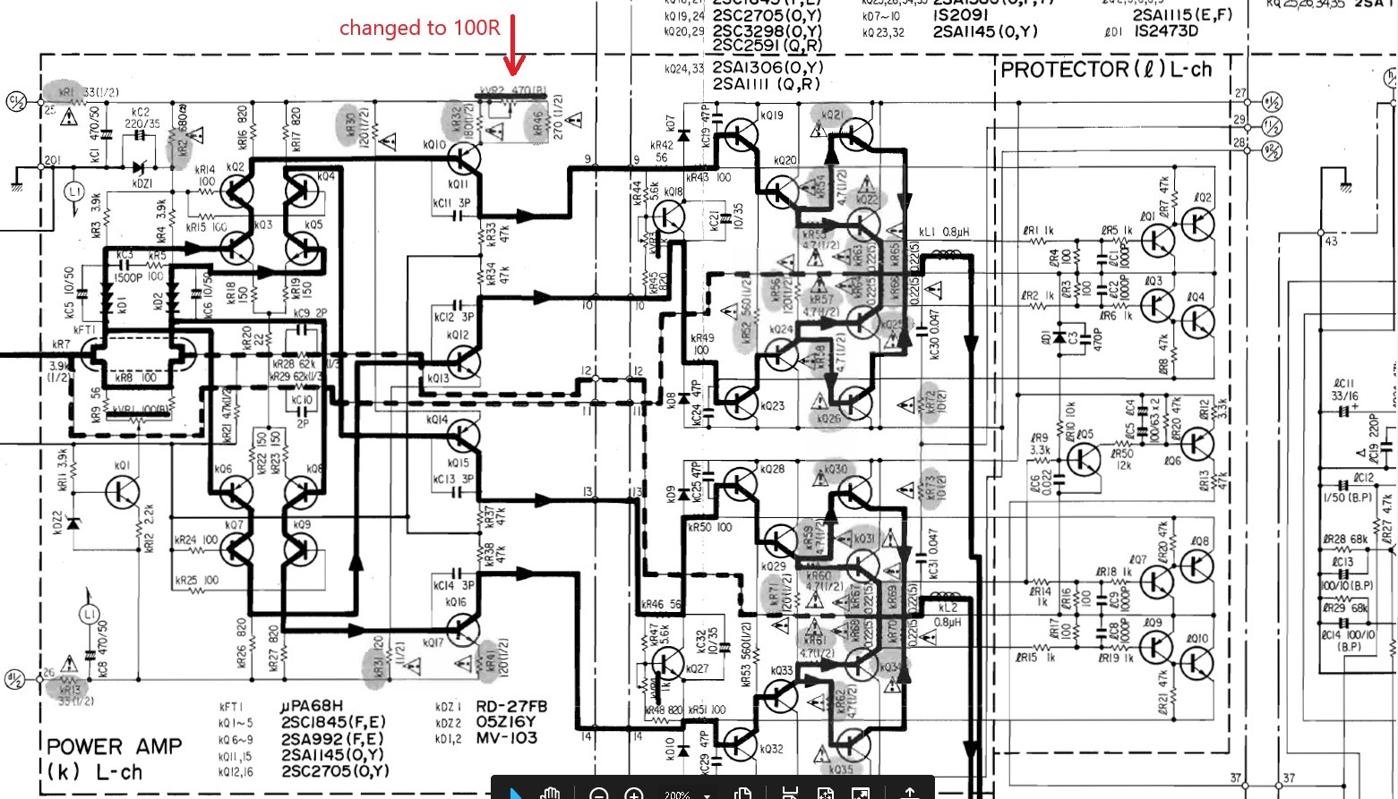

The main problem, is the center dc 0V adjustment with VR2. There is no stable value to get. I have already exchanged the variable resistor for a 100 Ohm type because the fluctuations during the adjustment were too severe. However, I can only bring the voltage to around 0V and then the voltage starts to drift. The smallest changes on the controller let the voltage run away immediately. The adjustable range between +/- 200mV is only about a 10 degree radius.I can no longer imagine a solution.So here's my question to the real experts, is this possibly a design error or how can this happen? Is there possibly a solution that saves my day?
Attached are two pictures of the manual to understand what I'm writing about.

This power stage has a very unusual design. Note connection of R33, R34, R37, R38 and their path to ground. Make sure this path is intact.
The amp has DC coupling of bridge drive, i.e. flat gain to 0Hz; each side of the bridge as gain of 13.2 (eg. R28/R21). Each side of the bridge has the same gain, so total DC gain is 26.4. That will make the the amp more susceptible to drift issues than more typical designs that have unity gain biasing designs.
Because of the gain of 26, it's sensitive to any applied DC bias. So look carefully at the signal source at the emitters of Q6-Q7--- there's a convenient TP nearby and a pot to trim voltage to 0V. But study it's stability; its drift is multiplied by 26 and presented to the speaker terminals.

So, back to the drift issue. Would you report how many mV of drift you observe differentially across the speaker terminals, i.e. the test in steps 1 and 2? Don't neglect to look at the DC present at Q6-Q7 emitters. A 100mV amp output offset can result from less than 4mV mV at that input.
With closer scrutiny of the schematic, I've discovered that the preamp stage from Q6,Q7 to input at JFET1 is also DC coupled with gain of 3.25. So the total DC gain from JFET1 to the speakers is 84.5 or nearly 39dB. IMHO, this is excessively large; just over 1mV of offset error at JFET1 will produce 100mV across the speaker. You will find that tweaking the VR1 pot near JFET1 will produce big changes at the speaker terminals.
A diagnostic test would lift the driven end of R43 and instead connect it to ground, say at board terminal 6. Then you'll be able to assess drift in the output stage independently from drift contributed from earlier stages. Again, I would attach little concern to the drift in the step 3/step 4 measurement. Error there only impacts centering of the common-mode bias which in turn has only minor effect on clipping amplitude; what matters most is undesired DC drift across the speaker.

I have now checked the voltage at the speaker output (VR3 ignored) and only changed JVR1 (Step 1,2). An increase of 1mV at the TP changed the voltage at the output by about 10mV.
If I adjust the voltage to exactly 0mV in step 1,2 and cause a change of 10-100mV with VR3, the voltage at the output only changes by a few mV.
