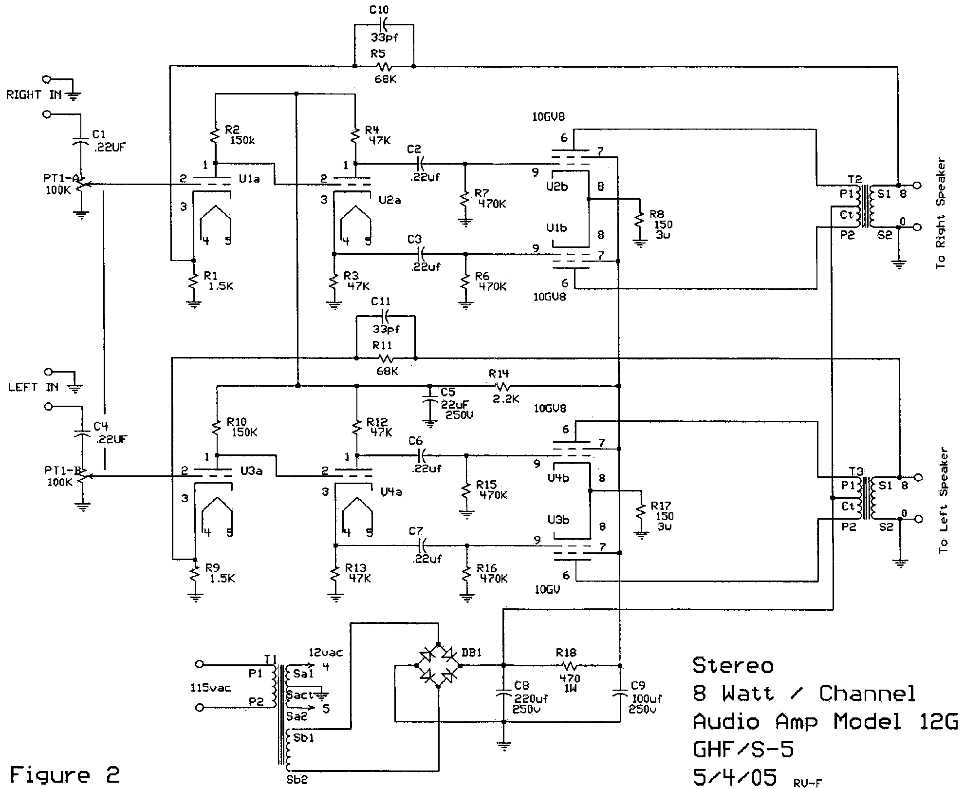

Hello everyone,
I have been lurking around the forums for a while, and eventually got interested enough to buy a tube amp kit. (S5 electronics, K12-G) The kit arrived in the mail yesterday and I spent the evening putting it all together.
However, upon testing it, I have discovered a very strange issue. My problem is that, after connecting a speaker (an Audio Nirvana Super 8) and a source (an mp3 player) and turning the amp on, I am getting a loud buzzing noise coming out of the speaker. The buzzing noise does not occur immediately, but rather after the amp has been on for a couple of minutes. (Until then, the amp sounds perfect.) The noise is so loud I have to pull the plug.
I have also noticed that the main transformer is making a buzzing noise, although, it is fairly quiet.

I believe this a schematic of your amp. I assume you have attached a pair of speakers and the increasing buzzing sound is equally loud across both channels.
Yes, that's the same schematic that came with the amp.

Operating your amp without speakers may damage your output transformers (OT's). The channel that had the speaker attached during your initial test should be fine, the other OT may have been damaged ( or not, you may have been lucky 🙂 )
Is the problem confined to the channel that had no speaker attached ?
Final proof of a faulty OT is to swap them over and see if the fault goes with it.
( The problem might still lie elsewhere, it could be oscillation of some sort )

A lot can be done without an oscilloscope. Remember this is a new build so the most likely fault is a component(s) in the wrong place, or back to front or missing. A dry joint ( or short ) may be present. Make sure OT primary and secondary wires are correct. ( This usually causes an unmistakable wail of a noise so isn't that likely.)
Check R5 (and R11) is correct as this sets the amount of negative feedback.
If all seems fine then we need to check voltage levels with respect to earth at various points within the amp. Each channel should have similar voltages at similar points. Different voltages should help to narrow down where the fault is. Valves should be removed and no music played while testing.

As Rmyauck says-
You only need to worry about getting C8 and C9 in backwards. It doesn't matter which way round the rest of the caps go in as they are non polarised. C8 and C9 help to filter out the mains " buzz " passing through the mains transformer so are important.

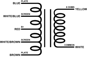

Okay, so after switching the output transformers the problem channel moved from the left to the right. I think that's good enough evidence for me. I'm going to go ahead and buy a couple Edcor GXPP 10-8-10.

The wires on the GXPP output transformers seem to be a little different than the ones that I have now. Could someone please tell me how to properly hook them up to the amp? Thanks. 🙂

Looks like the Edcor GXPP 10-8-10 has ultra linear taps. ( white/blue and white/brown wires) These should be insulated and left unattached for the moment. In the future you might like to try the ultra linear mod. Or you could build a new amp using these taps.
Not sure if the colour of your OT wires are the same as my stock OT (SA0734). The centre tap (Ct) of my primary is red and would be the same on the Edcor. My P1 is brown and my P2 is blue. According to my reading of the above Edcor diagram you would use the blue wire for P1 and the brown wire for P2. Getting this wrong would result in positive feedback instead of negative feedback coming off the 8ohm secondary. The amp would go into oscillation and you would quickly hear this "wailing" sound I've talked about. (You'll want to turn the amp off right away 😀) The phase problem is easily solved by either reversing P1 and P2 of the primary or reversing the secondaries, whichever is easiest.
Perhaps others who have experience of this Edcor transformer could confirm my advice.

Okay, so Red goes to Red, Blue goes to Brown, and Brown goes to Blue? I looked in the manual that came with the amp and it seems to confirm that.
