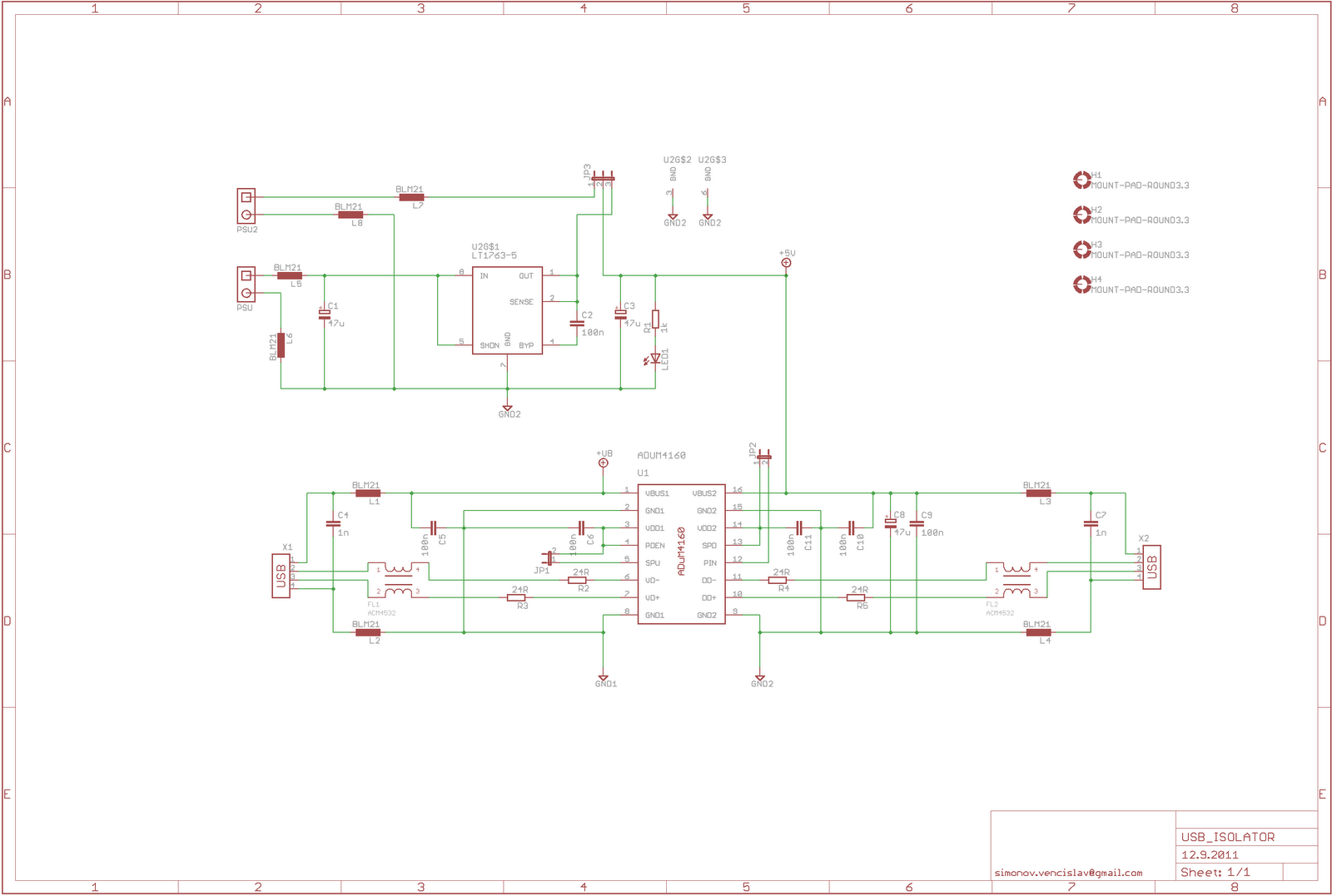

I am wondering if someone can help me with a small project for USB isolator. I tried making a board with Eagle but had to gave up.
The schematic is attached ,I would like to skip the 5volt part in the schematic and would like to add 4.7uf and 0.01uf capacitor in downstream part. Also looking for suitable replacement for CMC and ferrite beads. Can anyone help?

Go to the Analog Devices web site. Since you are looking for ready made stuff, you can order the assembly there: ADuM4160 USB Isolator Evaluation Board. You can use the board as a guide for layout in Eagle.
