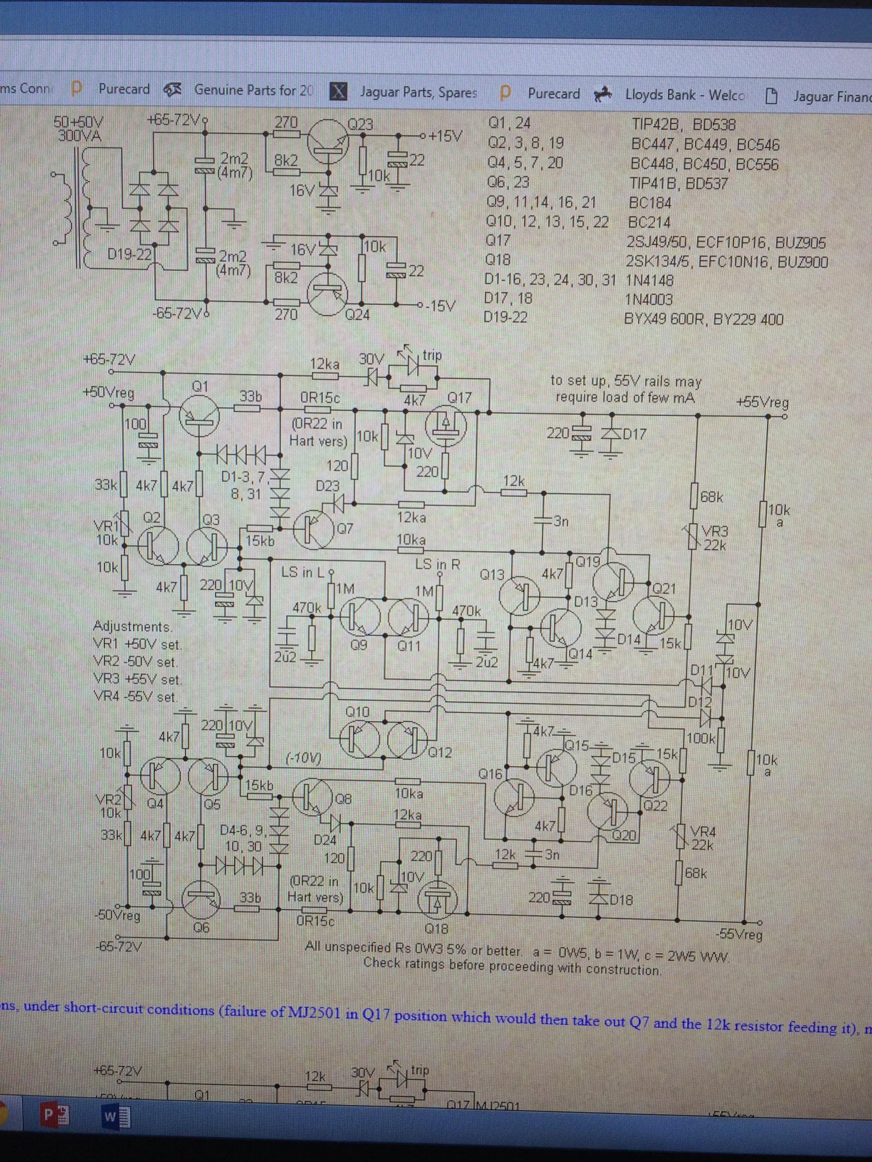

Thought I'd revisit this one!
I've attached a copy of the PSU circuit if that helps!!
With some other help, was initially directed towards Q20 and C8
Found that a 3n0 capacitor (C8) in the regulator circuit had gone awol...and on replacing this, regained control of the -55v rail!! 🙂
THEN....noticed that...when PSU was switched OFF then back ON again .....volt age would either : return immediately to -55v...OR....creep slowly, and settle around -27.5v.
So...on first switching on (cold!)...goes to -55v....but after short time, switching OFF/ON, rail only reaches -27.5v.
Using a bit of a scatter-gun approach...I've replaced some diodes (all 1N4148's) in the area (Why not...I thought!)
...to no effect!
I've tested Q20 with a DMM...and it looks OK.
Just don't know what to try next.....anyone!!???
...to no effect!

Thanks for venturing your thoughts duncan2...much appreciated 🙂
Having now removed/tested/replaced transistors in that 'bottom rhs' area, (BTW...what is the 'gate'?) find myself wondering if it's possible for a semiconductor to test OK on a DMM, but actually be faulty in circuit???? (Thinking of Q20 here )
Have re-flown solder joints, and checked for continuity all over the PCB.
Notice that Q19/Q20 are BC449/BC450, and these are considered 'obsolete'.
Any knowledge please on current equivalents for these...should I need 'em??
Found another complimentary pair of BC450/BC449 on the board, and swapped them for Q20/Q19.......same problem, so appears that Q20 is fine!(?)
Have re-flown lots of solder on the PCB.....hasn't changed anything.
With a 2K load on each 55v rail....these go to +55v and -55v when first powered ON ......THEN.....these settle at +12v and -7.5v when the unit is switched OFF...and back ON again.
I noticed that when I switch PSU OFF...from it's 55v rail 'stuck' at 12v stage, the same peculiar (to me) thing happens.....DMM voltage falls to 0.4 volts, then display 'stutters' and climbs instantly to around 3.5 volts, before then falling to 0v. Only at this stage do the 55v rails return to full potential when unit is switched back to ON.
Because this behaviour is so predictable....it's hard to believe that the problem is due to anything other than a component!....Does anyone think that a 'dry joint' or crack in the PCB track could behave so consistently?
Any thoughts please??

The "gate " is the mosfet equivalent of the base in a bjt (bipolar junction transistor ) --ie- the signal control part of the active component or grid as in a valve (tube -triode) .
I now see in your later posts that both rails drop to low values not just the minus 55V rail ,while still pointing to faulty component it could also be a fault in the safety control components .
Of course ,as you say it could be a dry joint ,if you did not build it yourself that's possible and down to bad soldering flow techniques, a crack in the PCB would mean testing with a low reading ohmmeter or the non technical way of powering it up and with one finger on a bare section of the board pressing it up and down with a test meter connected to the rails .
Checkout the gate components on both pass mosfets, one part of this design that's goes faulty can affect the other rail due to the safety design to limit fault conditions affecting the output and therebye causing component failure in the actual power amp, John was very safety conscious in this regard.

I would be looking around the power supply and see if volts are what is expected and where the volts start to go wrong.
Zeners quite often fail or go dodgy.
Thanks for commenting Nigel! Wouldn't know where to start with this.....but I'd like to!! 🙂I would be looking around the power supply and see if volts are what is expected and where the volts start to go wrong.

Update....After waiting 9 days for a selection of Zener diodes (will be sticking to next day delivery with RS-online where I can, from now on) was able to attempt a scatter-gun approach to problem.
Zener diodes can misbehave (apparently)...so I replaced ALL of them with 'new'. Also renewed Q13/Q14 (part of clamping circuit) for good measure!
(took opportunity to check each item removed with a DMM and couldn't find any fault!
Powering on...seems this has had no effect...and symptoms I referred to in my post #10 continue un-changed.
Perhaps my scattergun approach should've been wider!! ?

Got there in the end!!!
Thought I'd update folks here!! 🙂
While reading through the 'JLH 80w mosfet power amplifier - modifying it' thread, I came across a contribution from vac231....who had also removed/disabled the components for the 15v bar-graph power supply. It emerged that it was also necessary that 3 x wire links also be removed to achieve correct function.
So...finally got there, and now have 2 fully working PSU's 😀😀😀
Love this forum...and thanks vac231
