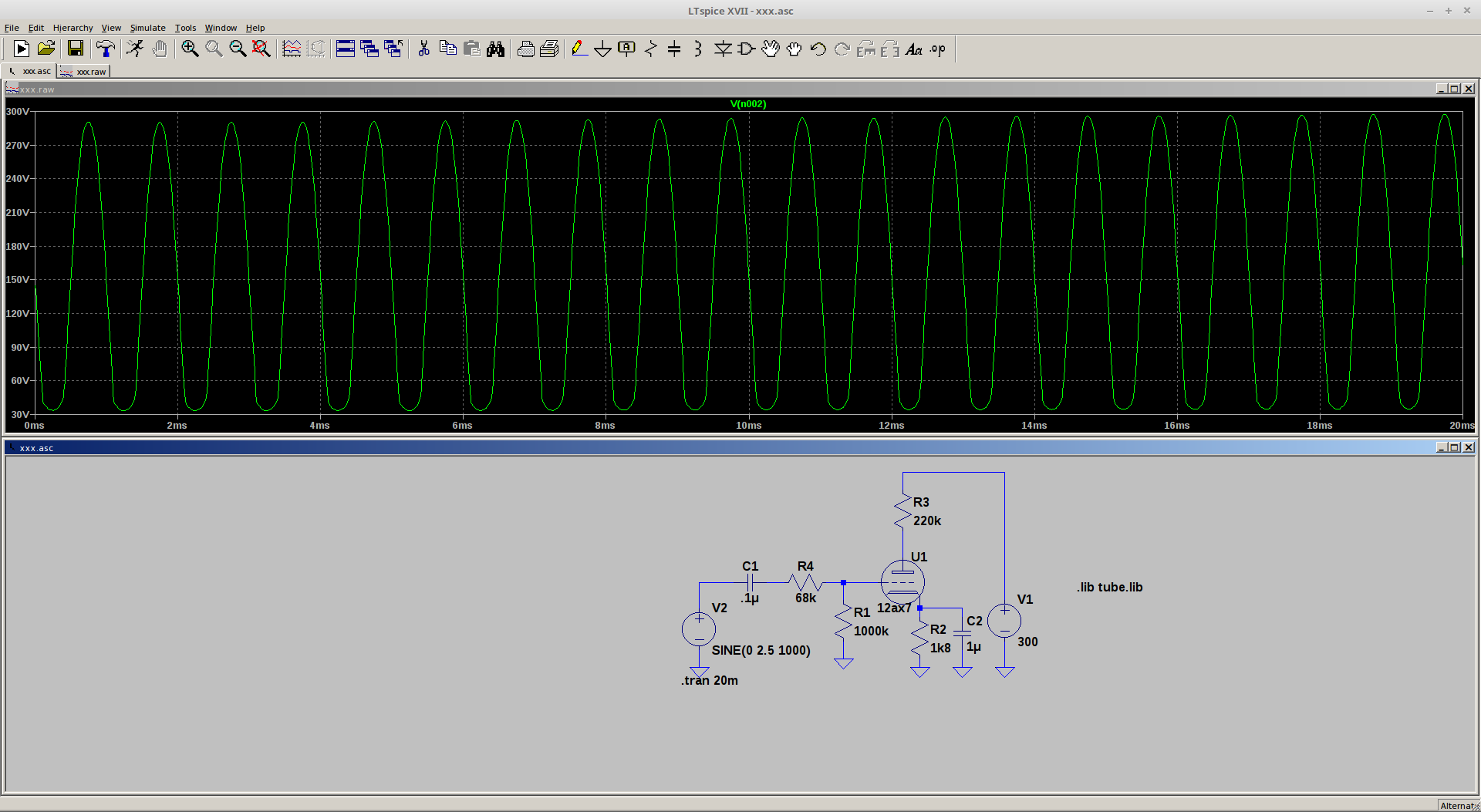

If you wanted a higher input guitar amp you could swap the 12ax7 for 12au7 and adjust the cathode resistors. That would give you a lot lower gain/bigger headroom. I have to say grid blocking is not a good sound and should be avoided -- maybe that is why the mod was suggested so you cannot charge up the DC input cap.a Are the penny has dropped thats why the grid resistor is 68k.

Can you explain what you mean here? Particularly the sound of grid blocking and charging of the DC input cap?

I'm going out on a limb here, in reading 'between the lines', but I think what Baudouin0 was referring to was the grid current that is sucked into the valve when its grid momentarily 'goes positive relative to the cathode'. This specific condition is to be avoided as much as possible, except possibly for tube guitar amps!

R₂₇ = protective discharge resistor, for when C₁₅ is carrying a significant DC charge, and the plug is pulled from J₁₀ (the input jack). Note that J₁₀ has internal short-circuiting of the input to ground when a plug is not inserted. When DC is impressed on the C₁₅ (for whatever reason, laudable or criminal, makes no difference), when the ¼" instrument cable is pulled out, the DC needs to discharge somewhere. The 10 kΩ resistor is a safe current-limiting path for that discharge, allowing the poor J₁₀'s shorting contacts not to wear out so rapidly.
R₂₇ also serves as the first level RF-filtering damper, which another poster talked about.
C₂₀ is the “other side” of RF (radio) input filter. Tho' not specified, it ought to be a fairly high voltage device, due to the possibility of the input taking some HUGE A/C voltage hits from extraordinarily badly wired up house wiring. (That goes for C₁₅ too).
The combination of C₂₀ + R₂₇ gives:
Z = 1/(2πFC) … rearranges to
F = 1/(2πCZ), with F=Hz, Z=Ω, C=farads, so
F = 1/(6.28 × 39×10⁻¹² F × 10×10³ Ω)
F = 410,000 Hz
That's the –3 dB corner of the RF filter. All frequencies above that are increasingly attenuated. Of course, 400 kHz is well above any conceivable audio signal. Thus … logic alone makes this an RF filter.F = 1/(2πCZ), with F=Hz, Z=Ω, C=farads, so
F = 410,000 Hz
R₂₅ (1 MΩ) is the tie-to-ground that gives the 'input impedance' to the amp, as well as that 'leaks' bad-actor DC developing across C₁₅ to allow it to charge up. It is typical for instrument amps to have impedance from 220 kΩ to 1,000 kΩ. This is pretty standard stuff.
R₂₂ is an “aggressive” grid-stop resistor. Grid-stop means “quenches a high-gain valve's desire to oscillate in the radio frequency band”. Necessarily for these little gems do do their job, they need to be attached to the valve socket's grid pin as closely as possible. On circuit boards, no problem. On point-to-point setups, very close indeed. The qualitative “aggressive” means that in normal service, the grid-stop resistor of a 12AX7 stage is usually closer to 1 kΩ to 10 kΩ. However, as this schematic is clearly highly protective of all possible bad-actor inputs and ground loops and everything else, 68 kΩ allows R₂₂ to take full mains voltage if need be, and still protect the poor input valve. Using
P = I E (watts equals volts times amps) and
E = I R (volts equals amps times Ω), then combining them
P = I²R or
P = E²/R
One can see that E = I R (volts equals amps times Ω), then combining them
P = I²R or
P = E²/R
P = (110 VAC)² ÷ 68,000
P = 0.18 W.
Not very high. The amp's front end will survive. The valve won't be happy, but won't burn out.P = 0.18 W.

OK grid blocking is when the grid starts taking current on the positive cycle of the waveform. This causes the blocking cap to charge up. This then causes the grid to become more negative in bias and eventually biases the valve out of conduction.
Solution small blocking cap and increasing resistor in series with grid. However increasing resistor will increase noise from resistor.
If you look at other gain stages the values of the grid resistors are > 100K to stop this effect.
You can see the effect of using 1k instead of 68k the bias shifts. This would be bad as it will effect the decay of the plucked sound in actually blocking the signal in a very bad case if the valve was driven out of conduction.
