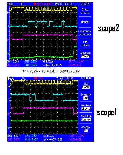

Hi guys!
I 'm trying to connect AD1851 to a UC.( ATmega 128)
The I2S system is OK (I have see on scope that the Clock,Latch,Data signals are timing like figure 6 pag 7) but on PIN9 (VOUT) of AD1851 there is always +5v signal so I have thinked that there is a wrong thing in the scheme.
The Uc send to AD1851 a 800hz sine signal.
If I short Pin10(Rf) with Pin11(Sj) the +5V signal become a "strange" (-5v+5v) signal (like a sine but with noise).
I'm comfused
or i'm a donkey
This is my scheme (Like fig3 pag 6 datasheet "POWER SUPPLIES AND DECOUPLNG")

I think that the data format is correct ( i2s format )
This is the data streaming .
C = clock D= Data
Ldw= Latch Down
Lup= Latch Up

about my data format .rfbrw said:Is the data in the correct format ?
I send a wav file of 800hz for 1ms (I loop it so i have a continuos sound ) generate from a Software for Generate Tone I have cut the fist 44byte (according the wav format Header,time long etc etc ) so i send only the data byte.
This are the bytes of "data wav file"
char Str1[]={
0x00,0x00,0xC9,0x06,0x44,0x0D,0x23,0x13,0x24,0x18,0x0C,0x1C,0xAD,0x1E,0xE9,0x1F,0xB1,0x1F,0x08,0x1E,0x01,0x1B,0xC0,0x16,0x76,0x11,0x60,0x0B,0xC6,0x04,0xF4,0xFD,0x3B,0xF7,0xE6,0xF0,0x42,0xEB,0x90,0xE6,0x06,0xE3,0xCE,0xE0,0x01,0xE0,0xA8,0xE0,0xBD,0xE2,0x26,0xE6,0xBD,0xEA,0x4C,0xF0,0x91,0xF6,0x44,0xFD,0x16,0x04,0xBA,0x0A,0xE0,0x10,0x43,0x16,0xA1,0x1A,0xC9,0x1D,0x97,0x1F,0xF4,0x1F,0xDD,0x1E,0x60,0x1C,0x96,0x18,0xB0,0x13,0xE3,0x0D,0x76,0x07,0xB0,0x00};
In Scope2 the Pin11 is connect to Pin10 of AD1851 (Vout is -5v+5V)
In Scope1 the Pin11 and Pin 10 of Ad1851 are nc (Vout is +5V)
Yellow is the Clock (n°1)
Blue is the Data (n°2)
Red is the Latch (n°3)
Green is the Vout (n°4)

asl please.
Connect the IV the proper way
Elso Kwak said:
asl please.
Sorry I don't understand
How I do Connect IV (Pin9-Vout).
Sorry but I'm confused.
Tnx
Tnx
As a genral rule for connecting an opamp as IV see f.a. the AD1865 datasheet. Admittingly it is not very clear in the AD1851 datasheet.
