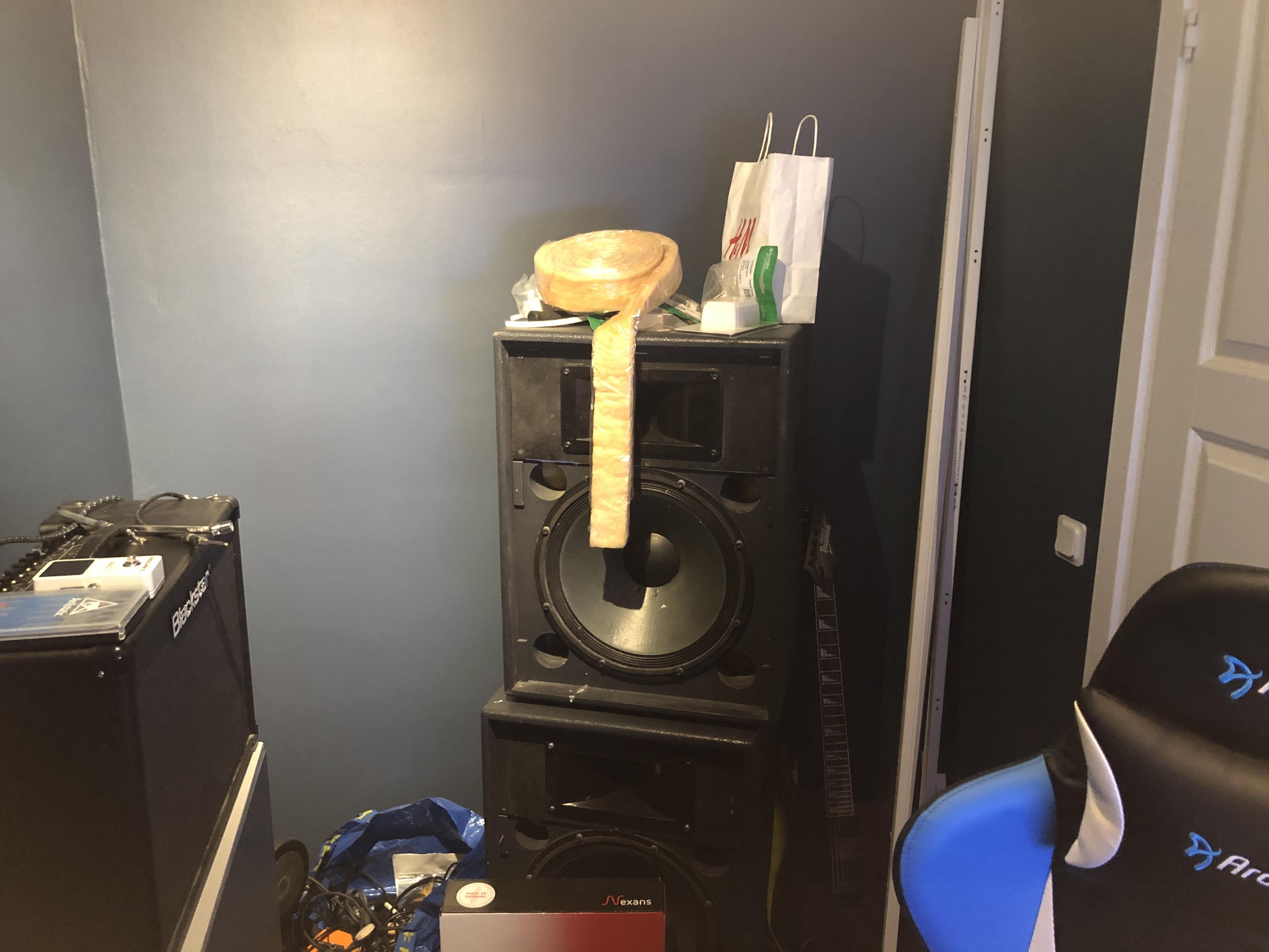

I need some help with choosing speakers for my little room. And when i say little its really small, dimensions: 1,75x2,75x2,30 ^^
I want to make a cheap system around 50-150USD if possible.
I have amp (citronic plx 3600) and 5band mixer collecting dust. However i dont think i want to use PA speakers on this but unless you feel like i should then go ahead and please tell me why 😀
I listen to everythyng, but mostly powerfull rock or metall
So aiming on a system that will play rock, heavy metal. and if possible id like to feel the punch in my body but maybe that is hard to achieve with this price tag. If that is the case then please let me know and i will go higher
Biggest outer dimension is 30cm in width, speakers will be placed on a table 1 meter away, I feel like there is room for a 10" bass driver

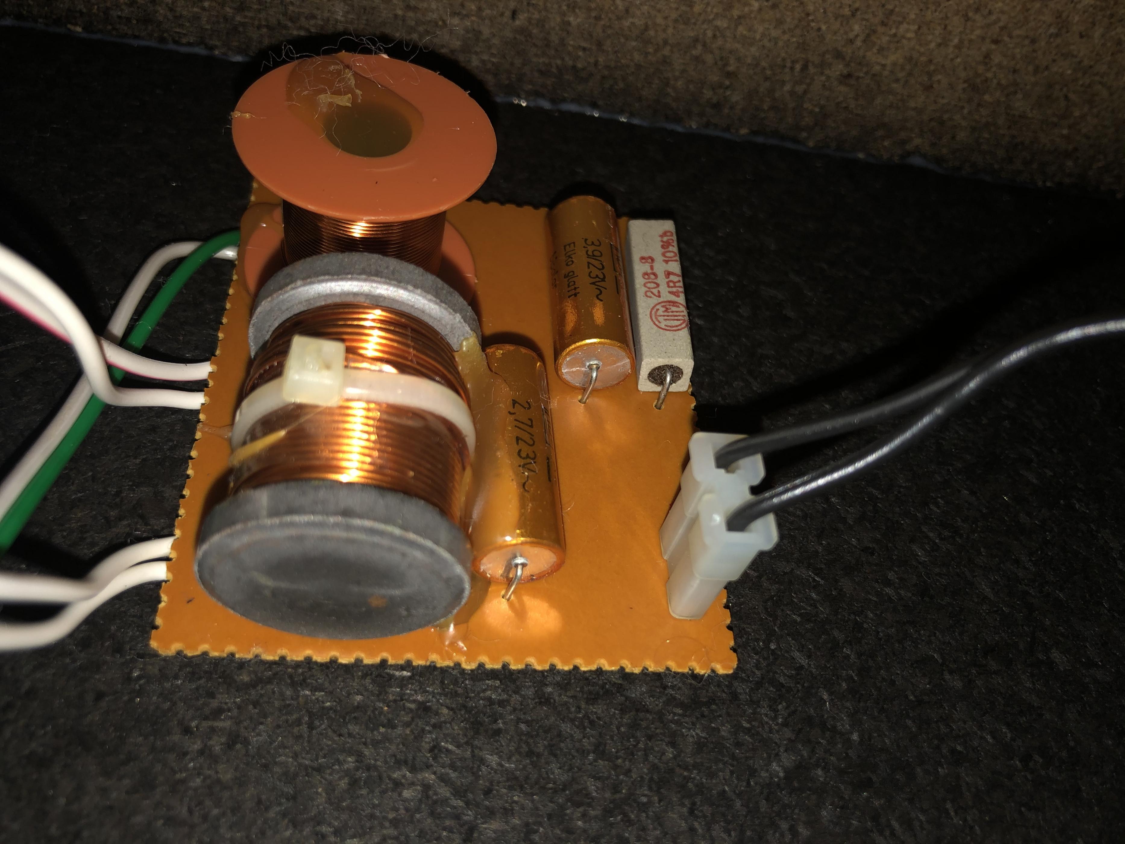

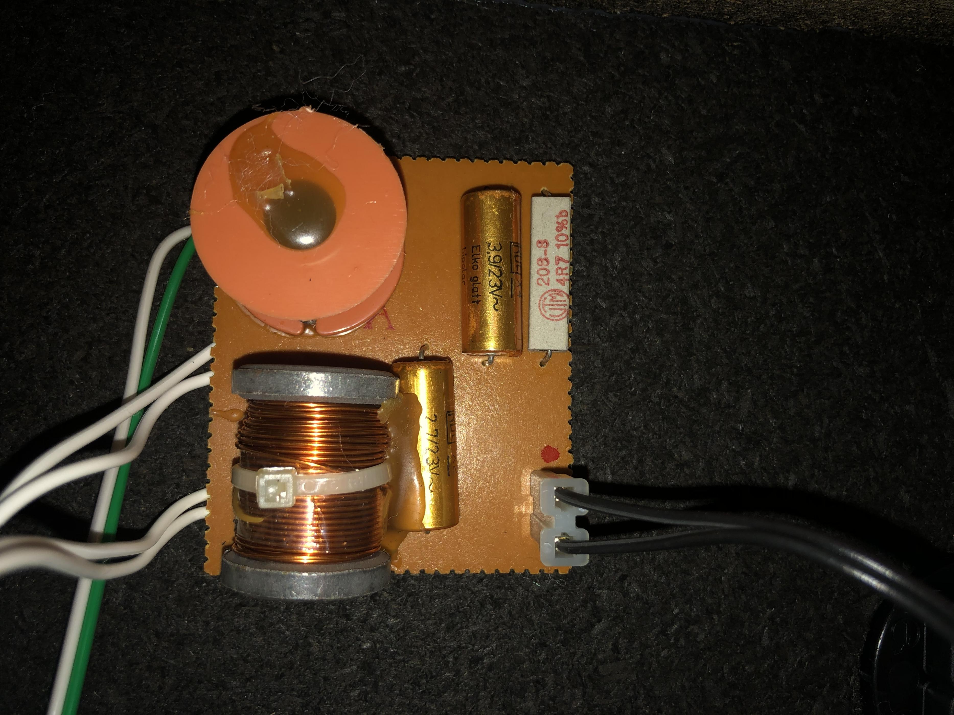

Having played with a lot of similar boxes myself there may be some easy tweaks. Also it may be as simple as a failed glue joint and air leakage.
Those boxes usually ran the woofer full range with a single cap on each of the tweeters; which are normally sealed back.

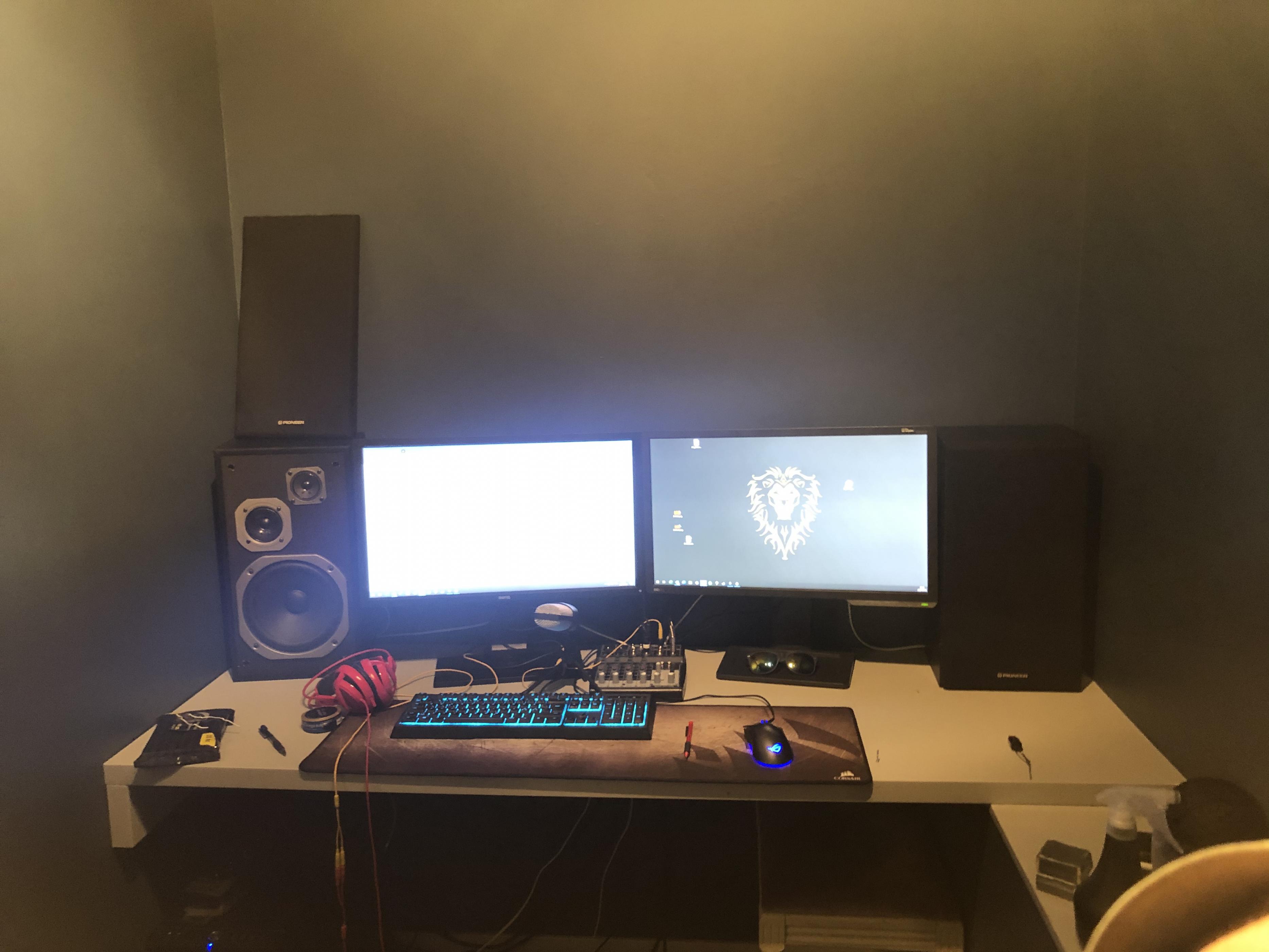

I'm not sure what you mean. Could you upload a photo or drawing of your speaker position options?
I think i figured it out with the pictures now 🙂
Beware we just moved in here and havent really figured out the layout of this room just yet. they used this room for coats and jackets so i only just fixed it up with my computer desk
SO i attached pictures of the table.. as you can see i dont have alot to work with, and my question was what you think of placing the speakers in the back instead. but i think that would sound wierd with the sound coming from the back i guess..
But size wise like i said in the beginning of the thread, i got 30cm to work with wich means a 10" would fit but depending on the L requirement of the driver the enclosure will get too high

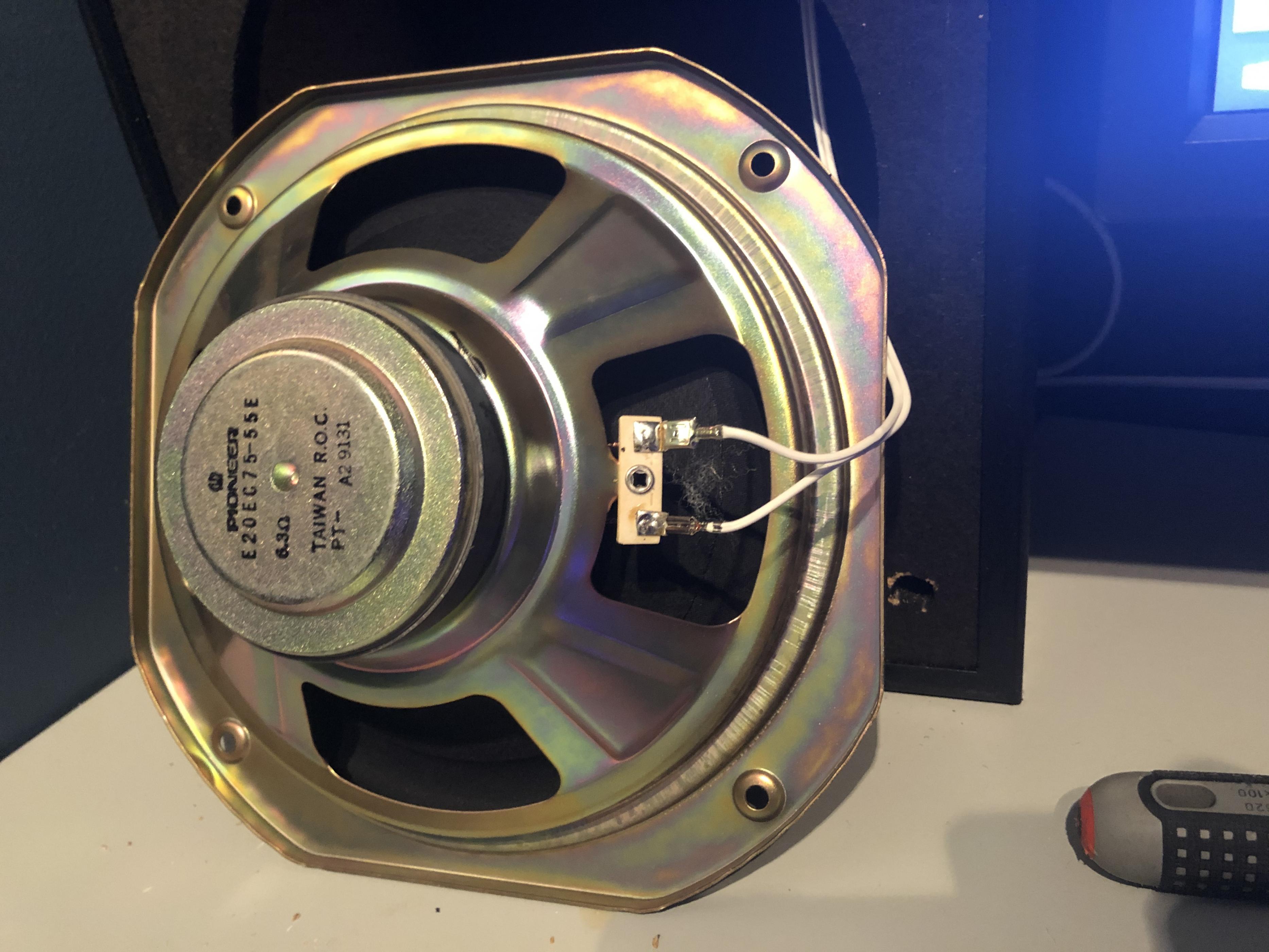

This driver feels really thin and weak in both construction and magnet so im thinking that this is a pretty cheap model
So i dont know if there's alot to do with the speakers guys
Other than replacing all the drivers and the crossover with something else that would fit well in this enclosure size (liter)
