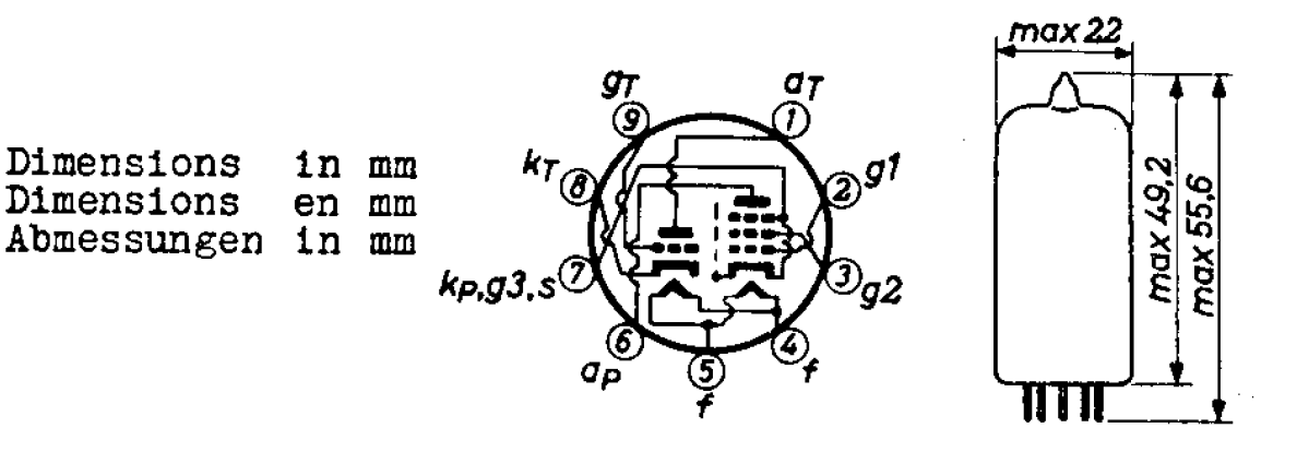

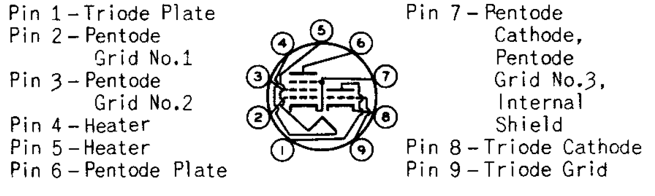

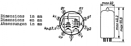

i forgot to mention that it has 3 tubes..
one is 6X4/EZ90
but the pots were connected to two other tubes, one says ECF80 and im not sure about the other one because most of the marking faded, i can tell it said Amperex and after i searched amperex the web to find it, i found that looks exactly the same as 6GH8A, so i guess thats the tube.
these tubes are somehow connected to one another, and one pot was connected to one of them and the other pot was connected to the other.
one is 6X4/EZ90

Pin 9 is the grid of the triode,
So it could be an input...however what is conected to it? does it have a capacitor connected to it and a resistor or just a resistor?
You must get this correct because if you connect to the wrong pin you could have high voltage on it and your guitar will become live!
You need to have more help from an engineer you cannot just take a guess!
Regards
M. Gregg

yeah i thought you guys may help me as engineers
pin 9 is connected only to the ground with a resistor.

i dont know what that means
is it possible it was connected on pin 9?? i think i see that something on this pin was disconnected from there but im not sure
can it harm the amp or my guitar if i try soldering it to pin 9?
