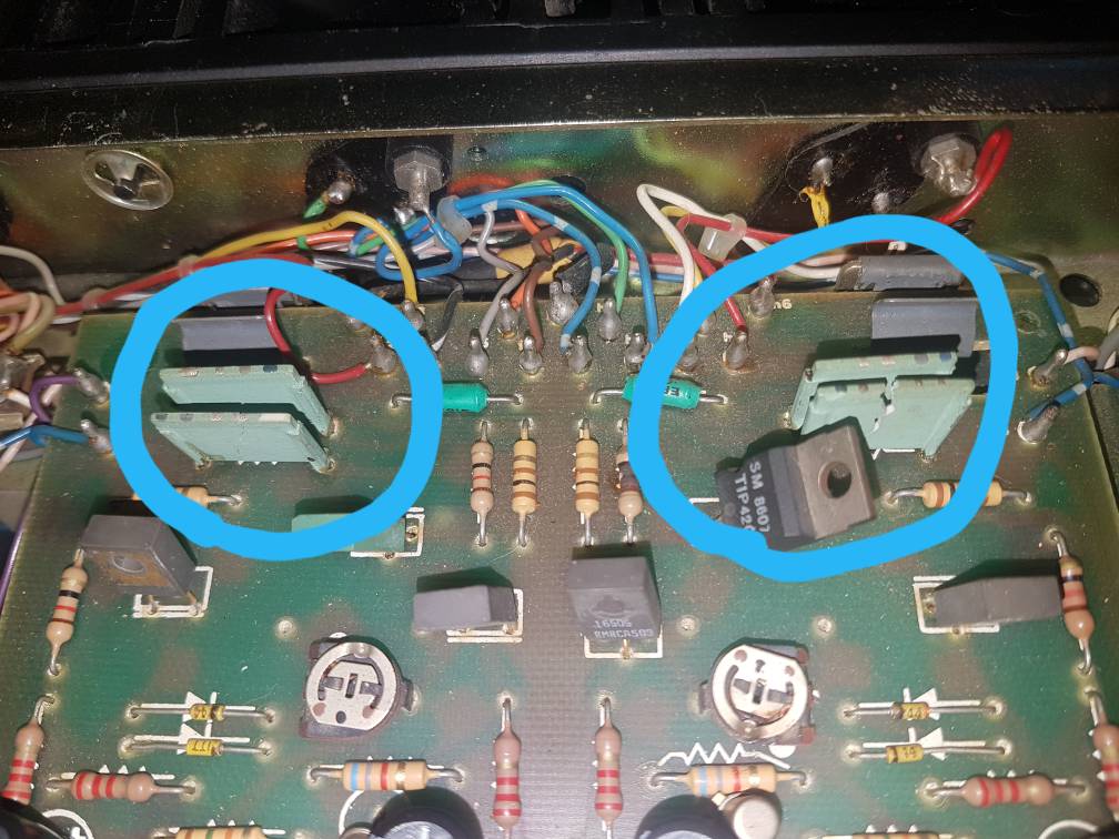

Are they faulty?
At the right one is clearly broken, surely by a severe overload. Check transistor prior to replace them.

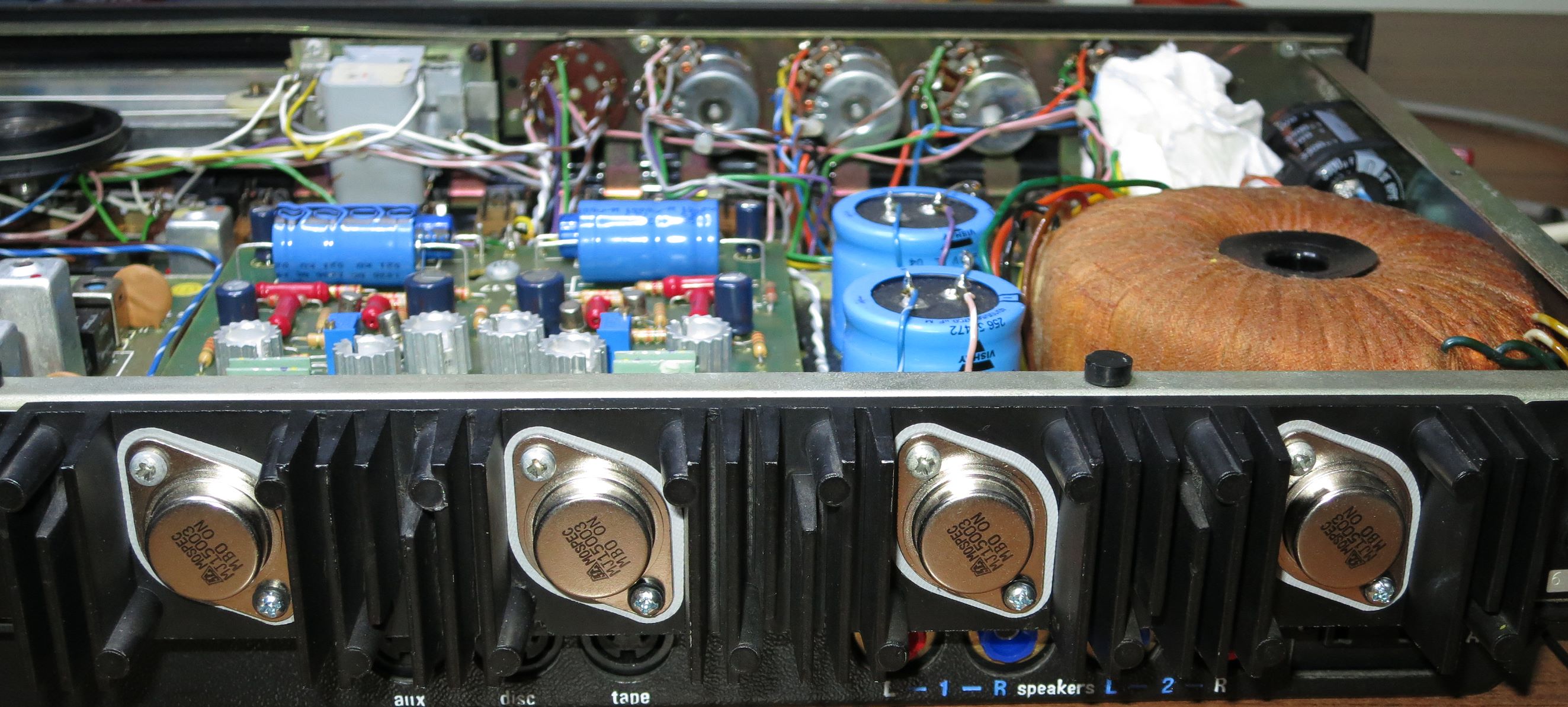

Amplifier with blown fuses.

Yeah, the one on the right is split in two. The one on the left has a crack as well. Thanks for the advise about the transistor. Will try to replace those as well.

Those ceramic resistors usually are printed in a ceramic tile, and they break as a sudden thermal overload, or mechanical abuse. Prior to replace them, check transistors and bias of the stage. Again, use a limited current supply like those detailed in the mentioned thread, to prevent major damages to he amp and for safety for you.
You could probably replace them with what are called metal plate resistors. These resistos feature a serpentine track of thick resistive foil with leads welded on the ends, potted in a flattish ceramic case in a similar manner to the cheap ceramic tub wirewound resistors that are ubiquitous. Typical manufacturers are people like Micron, Fukushima Futaba, and Noble. I've found most of my plate resistors on E-prey.Use "plate resistors" as a search term, and you'll see some pop up.

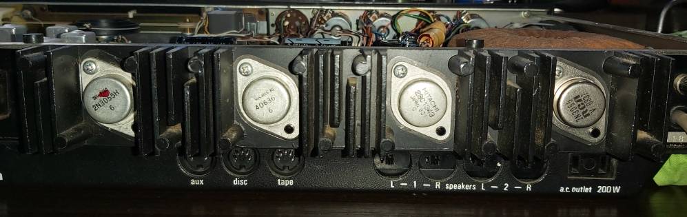

It seems almost all have been replaced already at some point with whatever was available. Saw on another forum that the original transistor used for all was the SGS 40636. Has anyone encountered this particular unit? Can he/she confirm if that was indeed the transistor used?

The original power transistors appear to be RCA 40636/2N3055 that you see on right side. I have an Armstrong 626 receiver in storage and as I recall, it is also fitted with the RCA originals though SGS could well have been an alternate supplier to Armstrong. I believe these are hometaxial transistors, similar spec. to early 2N3055 product but unlike the epitaxial equivalent types such as Motorola's 2N3055 that several other manufacturers are still producing today.
What that means is we can't just replace the transistors with any old 2N3055 version that you find. Since hometaxials are relics of the 1960s-70s and rare in working condition, the bias arrangement which includes the plate resistors will need to be redesigned to suit epitaxial transistors. That's not simple if you expect the sound to remain good but it's also an opportunity to try much improved, multi emitter TO3 types like MJ21194.
