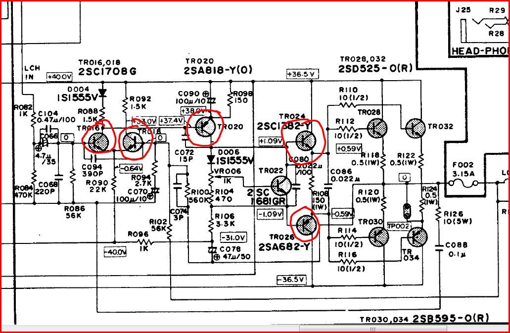

1. The amp in question is Toshiba SB-420
2. Noise not affected by volume setting
3. Noise not affected by choice of input
4. Noise not affected by physical movement of amp
Appreciate very much for your help.
What kind of noise is it - hum, hiss, crackling, what?
Mike
cracking noise from the tweeter.
Different circuit but should give you an idea of whats involved.
http://www.diyaudio.com/forums/soli...ba-330-power-amp-problem-possible-repair.html
This picture shows your amp. Check the transistors marked for poor soldering and possible intermitent failure.
Hi Mooly,
Thank you for all your efforts to help.
I have checked and resoldered any possible loose or dry joints including replacing most of the capacitors at the output stage as in the circuit you attached. The right channel cracking noise still persists.
I am prepared to replace the transistors if necessary. Which are the transistors do you think need replacement? I am not familiar with transistor and not sure the equivalent type since most of the existing transistor you indicated in red already obsolete.
Appreciate very much if you could help me to narrow down the parts that need replacement.

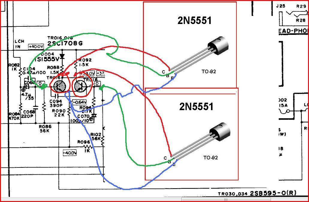

Those transistors can be replaced by general purpose generic types.
The 2SC170's can e replaced by 2N5551 or BC546
The 2SA818 can be replaced by an MJE350 or BD140
The 2SC1382 can be replaced with an MJE340 or BD139
The 2SA682 can be replaced with an MJE350 or BD140
There are many suitable devices. The above are common and generally easily available parts.
The pinouts of the 2N5551 and BC546 are different from each other and different from the originals. You can get all the pinouts etc here,

Hi Mooly,
I managed to purchase the following transistor:
1. 2N5551
2. BD140
3. BD 137 instead of BD 139 that you suggested.
I am not train in electronic so could not quite understand how to check the DC offset. Are you able to guide me through step by step after replacing the above transistors.
If I have to replace the speakers with electric bulbs for testing, what is the voltage and wattage of the bulbs? Should I connect the bulbs similar to the way the speakers are connected?
I had bad experience replacing transistors for another amplifier which caused the amplifier to "burnt out".
Your advice is greatly appreciated.
First thing to do is to familiarise yourself with the pinouts. Get the data sheets for each device from the link I posted.
The BD137 is only a 60 volt device... its not enough because the amp runs on around 73 volts total and although under quiescent conditions the devices only see half that, under drive they see more, approacing full supply. You can still replace the others and lets where that gets it all 🙂
On diagrams the emitter is always the one with the arrow, the collector is the one above or below it and the base always the one in the middle.
The light bulb (ordinary 100 (or 60) watt mains filament bulb goes in series with the mains supply to the amp. Bearing in mind safety... you can solder two wires to a bulb and solder these across the main fuse holder in the amp having first removed the fuse. You haveno speakers connected for all the testing and work done on the amp.
DC offset is the DC voltage that is present at the speaker output and it should be near zero.
If you are unsure with anything then ask 🙂
Most important is to get the pin outs correct on all the transistors.
1. 2N5551
2. BD140
I noted from our local supplier the following:
1. MJE350 - 0.5A, 300V, HFE 30V; while BD140 - 3A, 80V, HFE25V
2. MJE340 - 0.5A, 300V, HFE 30V; while BD139 - 3A, 80V, HFE25V
3. 2N5551G instead of 2N5551; there is no BC456 at all (is there a typo error)
Since the spec are quite different between MJE and BD, should I go for BD instead?
Is there any equivalent for 2N5551? BC456 does not exist.
