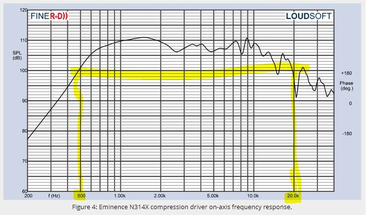

Thanks a lot for your quick response.
Maybe to clarify myself, with a 3 way I was referring to using a coax + 12" woofer, as I need a 3 way crossover, while a 2 way would be a normal CD + 12" woofer. I indeed do not intend to use a dedicated midrange also as I like the idea of having a points source for the higher frequencies, as based on my limited understanding so far, higher frequencies are much more directional with a much narrower dispersion compared to lower freq. Again, this is just my noob opinion based on what I learned so far.
Indeed, the n314t uses Titanium, which is one of the reasons the n314x is being 'hyped' so much as they use textreme which gets also . The 4590 uses Polyester (so they don't have the titanium sound either?) and the dcx354 uses 'polymer' which sounds to be similar to the 4590. Honestly I have no clue if this is really important. As I'm not as interested in max SPL I don't need the latest word in efficiency but the least distortion and the smoothest flattest curve.
https://audioxpress.com/article/test-bench-eminence-n314x-textreme-compression-driver
https://audioxpress.com/article/tes...-8-with-h14ea-horn-and-n320t-8-with-h2ea-horn

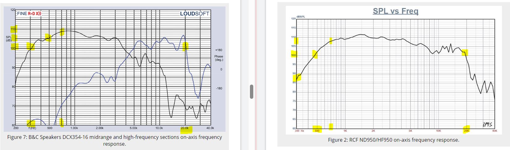

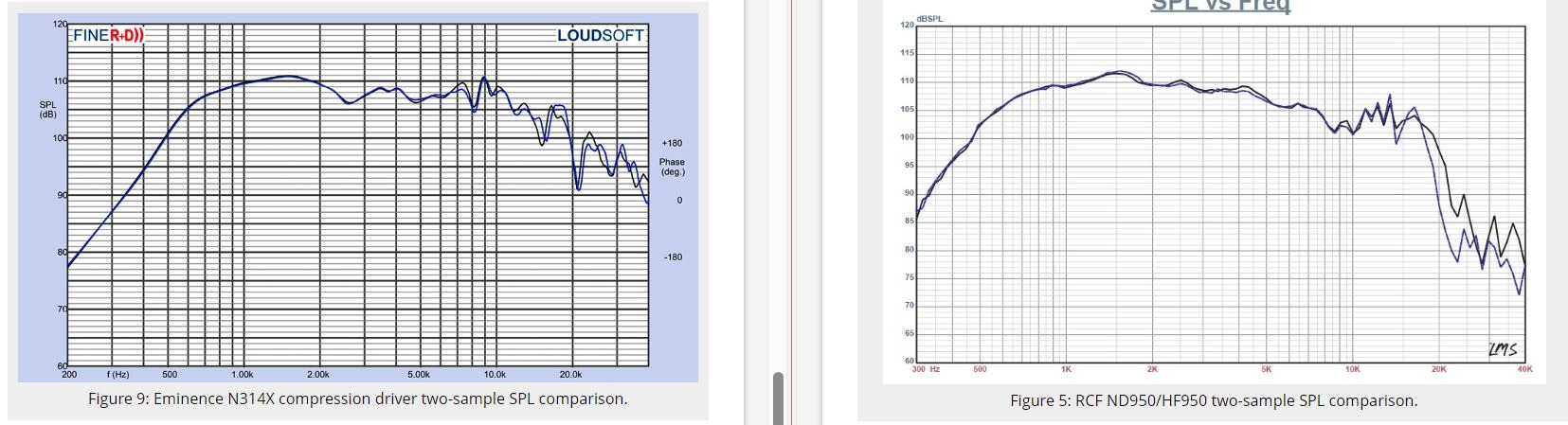

The n314x seems to have good extension even +20kHz but not sure if it's really as simple as adding some EQ as also the horn has to be able to cope with it? This really confuses me, the combination horn + CD and how to eq them. I drew a line below, this is all pure theory, so not sure it's that easy to just eq them down in minidsp to get to this flat curve:
eq'd to 95db it goes from 400-25kHz. Nice but my woofers down low have a sensitivity of 95db but can take 400w total, so this will bring down the whole system
eq'd to 100, goes from 500 to 20kHz, which should be plenty

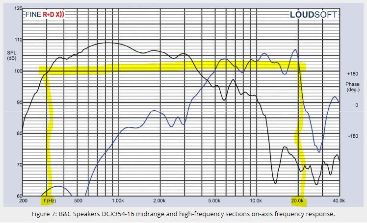

DCX354 eq'd to 100db (doesn't make sense to do 95db as I will not gain any top end). Goes from 300Hz to 20kHz, so a crossover at 600Hz would be an octave above the dropoff, so seems good to me?
All of them have more than enough SPL for me not to worry too much about the extension to 20kHz, they can be eq'd down and all reach it, it's the bottom end mainly.

- How important is the material of the diaphragm, is textreme or polyester or polymer important or should I just look at the waterfall, freq response and other graphs?
- If I want to crossover at 700 Hz (which I do) do I need a flat response to 1 octave below or is to 500Hz just fine?
- how much of a factor is the horn in all of this? Are the yellow 'eq' curves I drew up top realistic or total bs as the horn response is fixed and can not be corrected?
- What will be the effect on the off axis response if I eq down in the mid part? will it beam less or more?
- Coming back on all of the above, is the n314x a good solution for my needs?

It is usual to roll off tweeters above resonance 12 db/octave or more, as they can be damaged by too much excursion in the resonance frequencies.
Woofers can be rolled off 6 db/octave to prevent cone breakup, but 12 db/octave is what I am listening to in my music room. SP2(2004) crosses over at 1800 hz. That is rather high for 15" woofer but Peavey made the case trapazoidal with a narrow back to extend the horizontal dispersion. Previous SP2-XT crossed at 1200 hz with a parallelapiped case and 300 watt rating (limited by the 70 w tweeter). 1985 SP2 crossed RX22 to 15" at 800 hz, and had a 175 watt rating.
If you can boost 15-20 khz by 5 db with bi-amp and a dsp, then the N314x should do well in a house. I'm entirely satisfied with the sound of the SP2(2004) but their high cash value at any pawn shop or flea market means they may disappear some day, along with a broken window or door.
The H14ea horn is specified at 60x40 degree dispersion, so unless one is a recording engineer in a 6' deep room that should be enough dispersion for any music room. Beaming can occur above the wavelength of woofers, but the wavelength of 12" is about 1150 hz so should not be a problem with a horn producing 20000 to 800 hz. I do not know why one would want to use a H2ea horn with a 1.4" exit tweeter. Sharp edges can lead to diffraction effects.
Some people are passionate about beryllium diaphragms, or polyester, or anything but titanium. As I have said, the titanium diaphragm RX22+1508-8 woofers are the best speakers I have ever heard on top octave piano tinkly bells, brush cymbals. I am quite annoyed by distortion by reproduction of instruments I have played personally. I have heard a poly diaphragm in a used Peavey 1.4" CD+horn from the nineties, and I did not hear anything special. I have heard Meyersound range size boxes at Brown theater, which has I don't know what tweeter but they are expensive. I found the violins screechy, although the recording of Swan Lake could have been at fault. I also listen to rock/pop music and bluegrass on my speakers, but with electronic recording one has no idea what the original was supposed to sound like. String instruments like acoustic guitar and mandolin are not demanding of speakers, being between 500 to 6000 hz. The top and bottom octaves of a Steinway piano are very special, and very difficult to reproduce with any accuracy. I've owned various failures of speakers at this task over the years. Certainly the Yamaha & Bose PA speakers at various churches I have attended have been miserable failures at reproducing even the *****y yamaha console piano they had.
I would find 700 hz crossover of a N314x violates the recommended 800 hz lower limit. If using passive components, I would start cutoff at 1000 hz, to avoid very high component charges of 24 db/octave filters. As I said, the 12" woofer doesn't beam until ~1150 hz. I prefer passive crossover to biamp+dsp to avoid running 2 or 3 stereo amplifiers 14 hours a day. There is such a thing as global warming, and I use my hifi system a lot of hours. More amplifiers means more air conditioning load, also. Also dsp means replacing it every 5 years or so as cell phones update and the driver software for the dsp becomes obsolete.

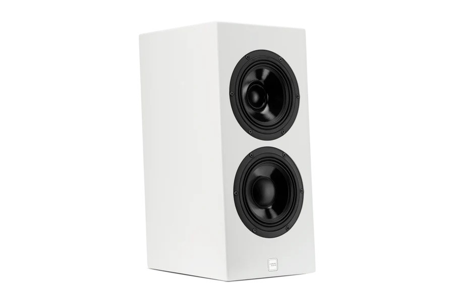

I currently use freestanding horns for watching TV. I like them a lot because they are highly intelligible with spoken dialogue so I'm not trying to move you away from horns. I'm just showing you these coaxial silk domes as an example for home theater. Even though these speakers are designed for music they require use of a subwoofer (i.e. like a home theater typically uses). They are able to reach 110 dB with a silk dome tweeter. They are coaxial so all vertical listening axis are good but the BEST listening axis is tilted down a bit so Sigberg angled the enclosures back a touch (for music listening). But in a home theater if you built them as regular non-angled enclosures the BEST listening axis of all the good listening axis would point down to your seated listening height in front of a TV.
https://www.sigbergaudio.no/products/sigberg-audio-sbs-1-aktive-hoyttalere
My free standing horns are just a little narrower directivity than these coaxials. However, I don't wall mount my freestanding horns. I pull them out and toe them inward. Neither are they very WAF friendly. Pretty darn ugly, actually. Obviously, that doesn't work in your situation. But these little Sigbergs are able hit 110dB (low distortion) because they offshored the low frequency heavy lifting to subwoofers by design. They aren't designed as speakers to maybe or maybe not use with subs. You must use subs. Tricky to convince audiophiles to do that but home theater guys love subwoofers. He achieves the low distortion through a 2.5-way configuration and locating each driver in its own small chamber within the larger enclosure so the woofer cones barely move, maxing only about 2mm by 100Hz near to their low frequency cutoff. Granted, he uses expensive DSP Hypex amplifiers in them. The depth of his enclosure is used to control directivity in a bookshelf on speaker stands situation while also housing the Hypex.
Anyway, I'm using these little Sigberg speakers designed for music as an example of the advantage you have when building custom speakers for a home theater.

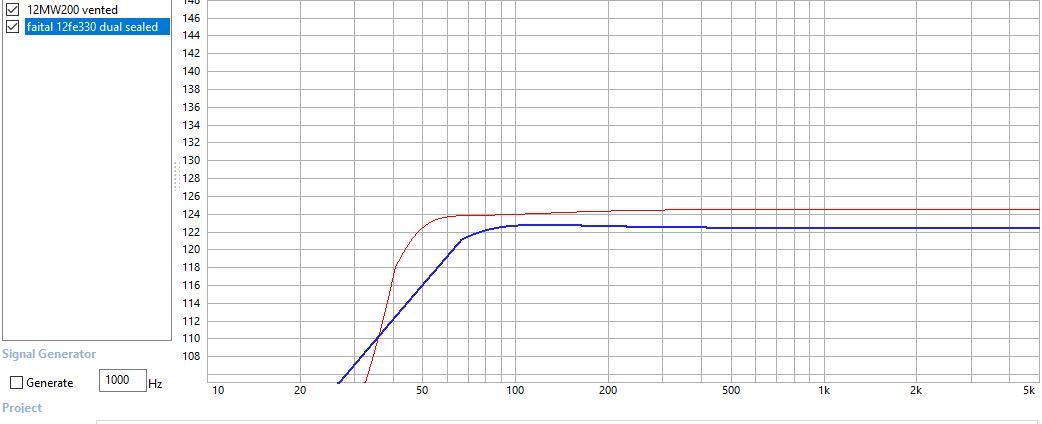

So decided on 2x12", SB Audience 12MW200 is flat to 60Hz in winisd vented 150L tuned to 50Hz and below 100 euro a piece. Would use the MTM configuration, if I cross over at 700Hz according to the d'apollito design I need to be max 13520/700 = 19" center to center, which will be no issue with a 12", so that also fixes my desired crossover at max 700.

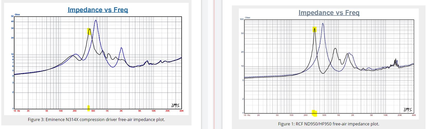

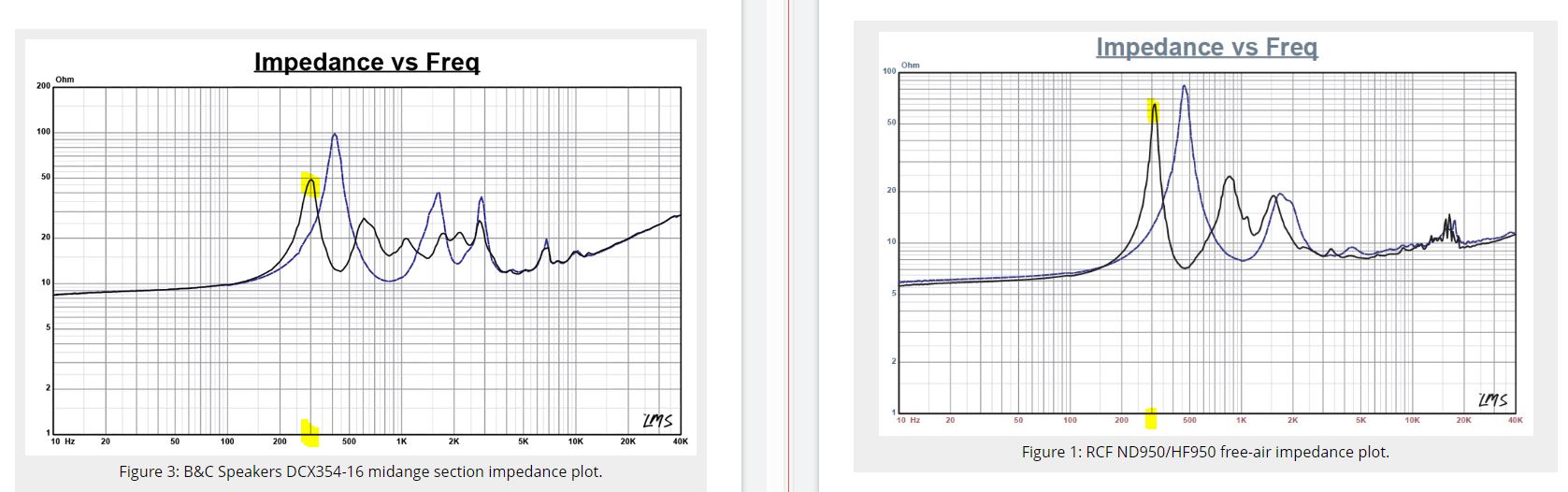

Actually, the ND950 has an FS of 350 so crossover at 700Hz should be no issue. It is also literally made for the RCF HF950 so very smart designers have matched these. The DCX354 can be crossed over at 650Hz (probably even lower if volume is not huge) and has about the same Fs as the ND950. The top frequency extension looks very similar between both as well. Only big difference (I see, I'm no expert) is the low extension which goes to a usable 300Hz on the DCX354 and 'only' 500Hz ons the ND950. Is this an issue, will i notice with a crossover at 700Hz?
Fs of the n314x is above 400Hz so they don't seem suited for a really low crossover.

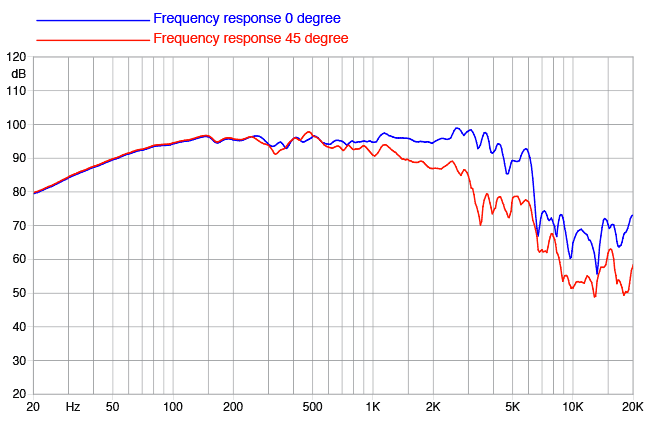

Some graphs:
Some graphs:

I would be happy just to be able to decide on this, the more I read and learn about it, the more I realize it's often down to physics, no miracle CD driver exists, there is always some compromise to improve the efficiency or extend the low or the high end.
The B&C DE990TN also looks like a good candidate, used in the JTR 212HT (the 'lowest end' in the line up). It's within budget at 360 eur. Also a lot of other options pop up
Compression driver FaitalPRO HF1400, 8 ohm, 1.4 inch (toutlehautparleur.com)
Compression driver Radian 951PB, 8 ohm, 1.4 inch exit (toutlehautparleur.com)
18 Sound ND3SN compression driver, 8 ohm, 1.4 inch exit (toutlehautparleur.com)
Compression driver Radian 636PB, 8 ohm, 1.4 inch throat (toutlehautparleur.com)
The Radian claims to go to 22kHz (the only one I know which claims this). The faitalpro has a 'softer sounding' diaphragm (?) and so many other review stuff I've read...in the end I guess they all have their merits, but as I have a budget of about 4-500 euro for the CD (and for a coax this needs to include the passive crossover) I would like to spend once, cry once, but off course not overspend if not needed...

Looking at the faital series woofers, I actually think it's better to switch the woofers to faitalpro 12fe330, it's almost ruler flat to 2kHz compared to the sb audience, and still below 100 euro a piece so pretty cheap. I preferred the sealed graph on this one, goes nicely to 60Hz and with DSP easily to 50Hz in a smaller box of about 120L.
(this is the max SPL graph, in red is the 12MW200, still it's more output, though the sealed faital will still be too much anyway for my room so totally fine with it, faital in blue. group delay etc will be better sealed but more power needed)
So looking at this, I think it's safe to take the advice of the experts and take a quality CD which covers 1kHz - 20kHz as flat as possible with as little distortion as possible. Would like to have a final decision on that to move forward so I can present the result to the budget approver, my dear wife.
