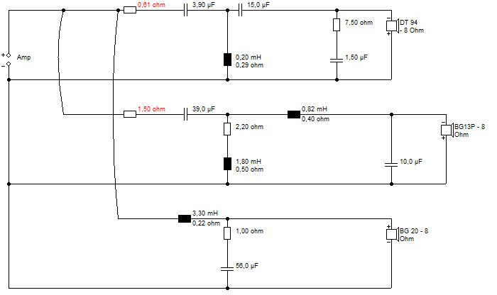

Visaton Drivers? Not hard to run this combo up the flagpole! 😀
Downloads
With no effort to optimise at all, it looks promising. If a bit bass light. Which is fine for Jazz and Bluegrass. Nothing awful in the impedance. Most amps could cope with that. 😎
Downloads
Downloads
I do not know about this interesting thing. thank you . You can consult 1 amp saba or not telefuken
Just a first order low pass on the woofer?With no effort to optimise at all, it looks promising.l:
Thanks System7 for your design. 🙂
I *fear* Miss just connected all 3 speakers in parallel, maybe used a small cap in series with tweeter, that´s why he´s finding the (now very low impedance) cabinet hard to drive, too midrangey and bass shy.
Hope to be mistaken.
Just the BG20 alone , with its whizzer cone, can be a decent full range speaker ; a real tweeter will extend range upwards; hope that midrange speaker both is fed from a proper crossover *and* lives in its own tiny isolated "cave" , away from woofer backwave pressure.
Miss -
Is this a commercial speaker ?
Or is it a home built design ?
What size is the cabinet ?
Can you show us the crossover and its schematic ?
Can you describe to us just what you think is wrong with the sound ?
What is the rest of the audio system ?
The more information you give us, the better the help that can be provided.

My thoughts, too. In one of the photos there seems to be something inside the cabinet that could be part of a crossover. Maybe just a cap for the tweeter. My suspicions of no crossover. or bad crossover still remain.Hope to be mistaken.
