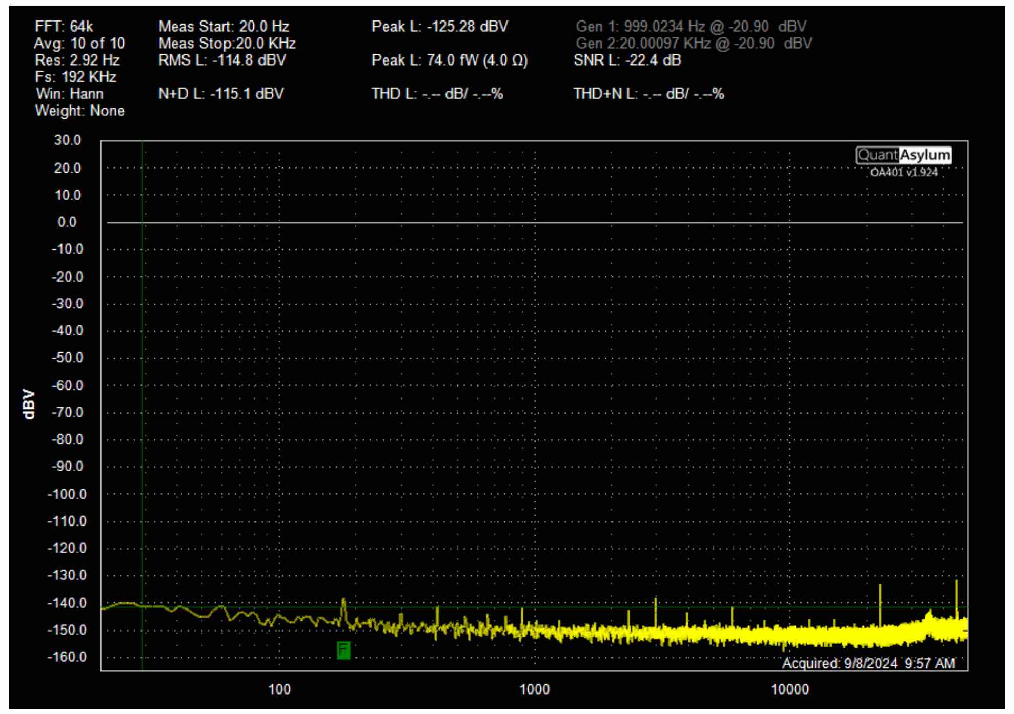

Not sure if this is the evaluation 1audio was suggesting, but here is some more data:
With the QA401 in differential mode and the two + and two - shorted, the background noise level is shown in attachment 1
The amplifier’s input was shorted.

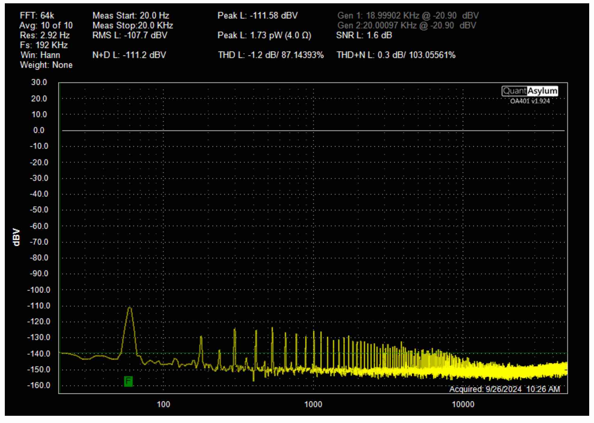

Now, connecting the two QA401’s positive inputs to the amplifiers negative output. The two QA401’s negative inputs were connected but otherwise floating. Attachment 2 shows the power-line noise spectrum on the amplifiers negative output.

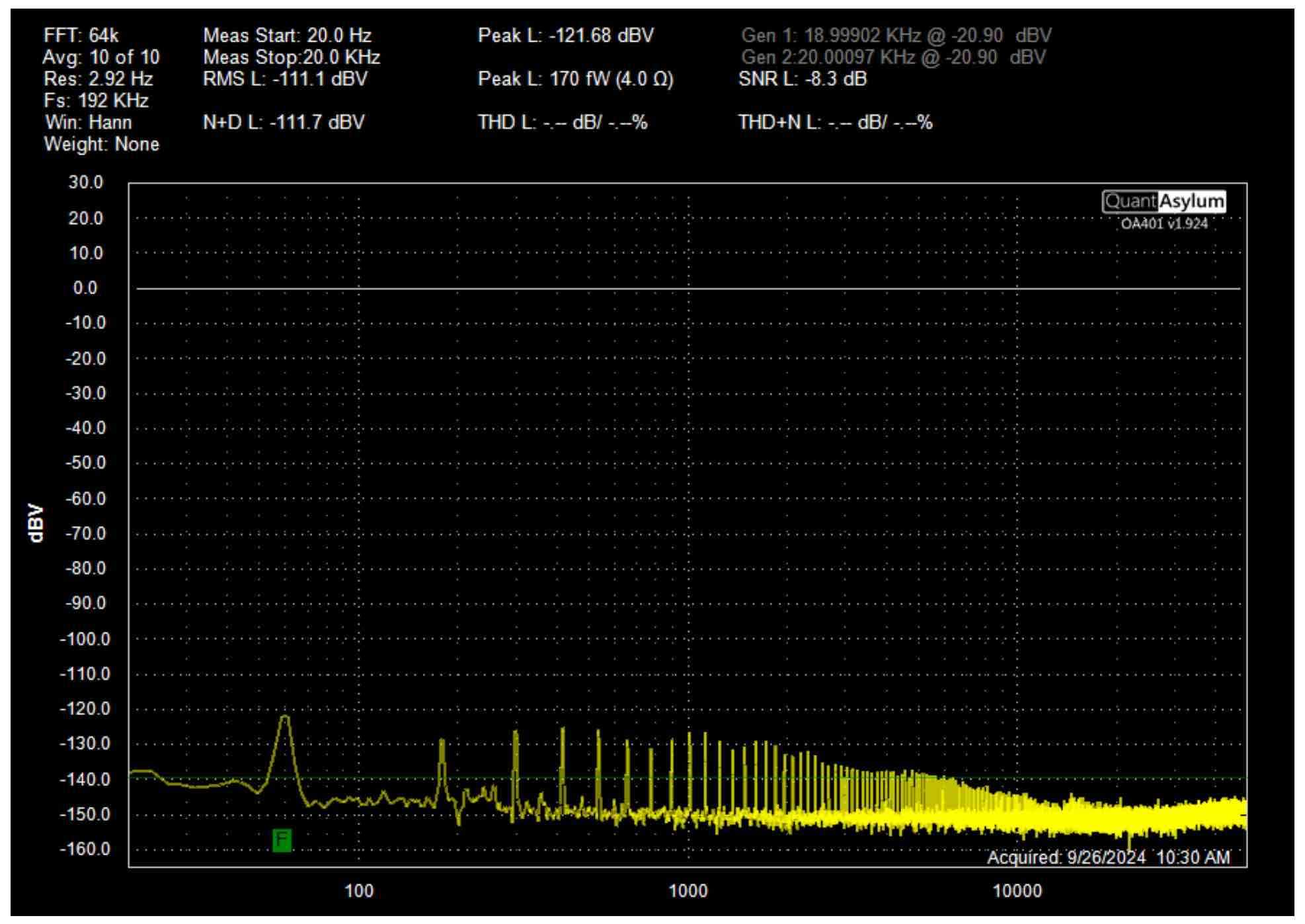

Maintaining those connections, attachment 3 shows the noise spectrum if a connection is made between the amplifier’s negative output to the QA401 ground. Clearly, the power-line related noise is reduced, but not by much.
Not sure what this tells me. At 60 Hz the amplitude is at -111dBV, with the added ground it is down to -121dBV. Can this really be the source of my problem?

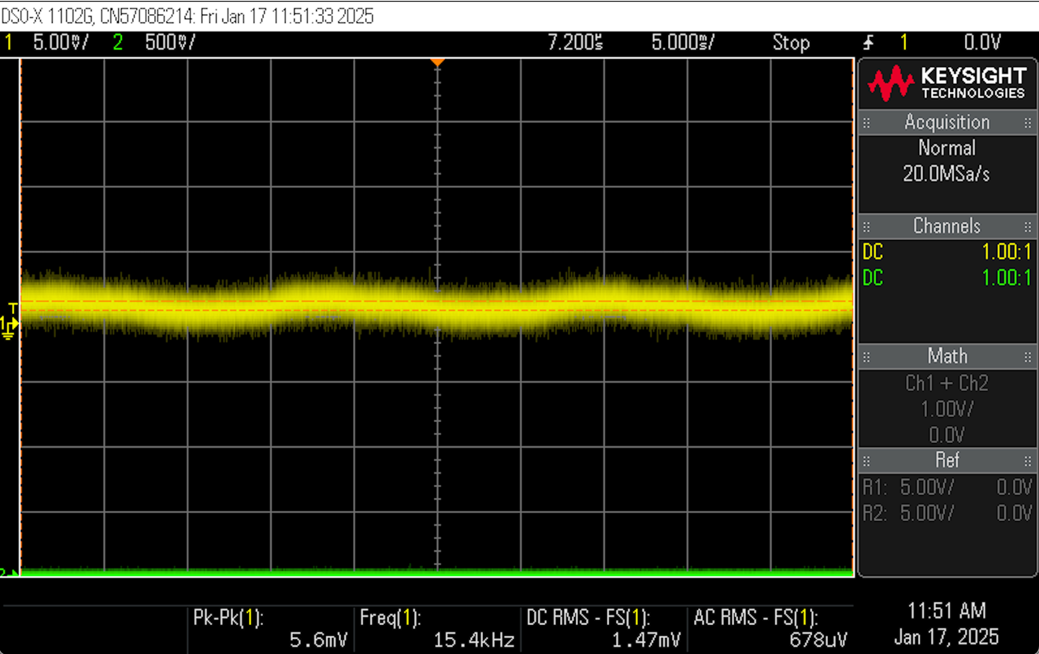

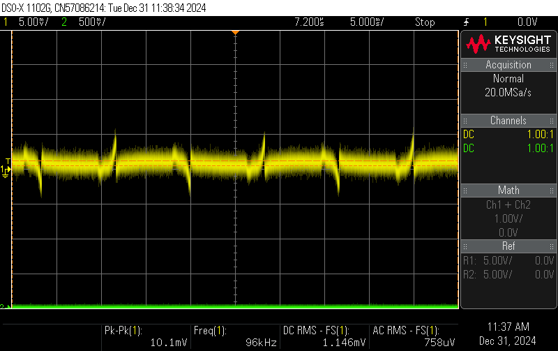

I installed that module, and repeated some of the measurements made back in Post #1. The second attachment shows an oscillograph of the amplifier’s output with the same measurement conditions used for the oscillograph in attachment #4 of Post #1. There is very little difference. So, separating the PCBs for the positive and negative power supply rails is not the source of the apparent ground loop problem.
As I continued to work this problem, I did stumble on the solution, rotating the transformer! The third attachment shows an oscillograph after rotating the transformer about 60 degrees. I had considered this the least probable cause, because previously I had a 500 VA transformer, without a flux band, installed in this amplifier, and I spent a lot of time checking for rotation effects, and found none. Go Figure!
