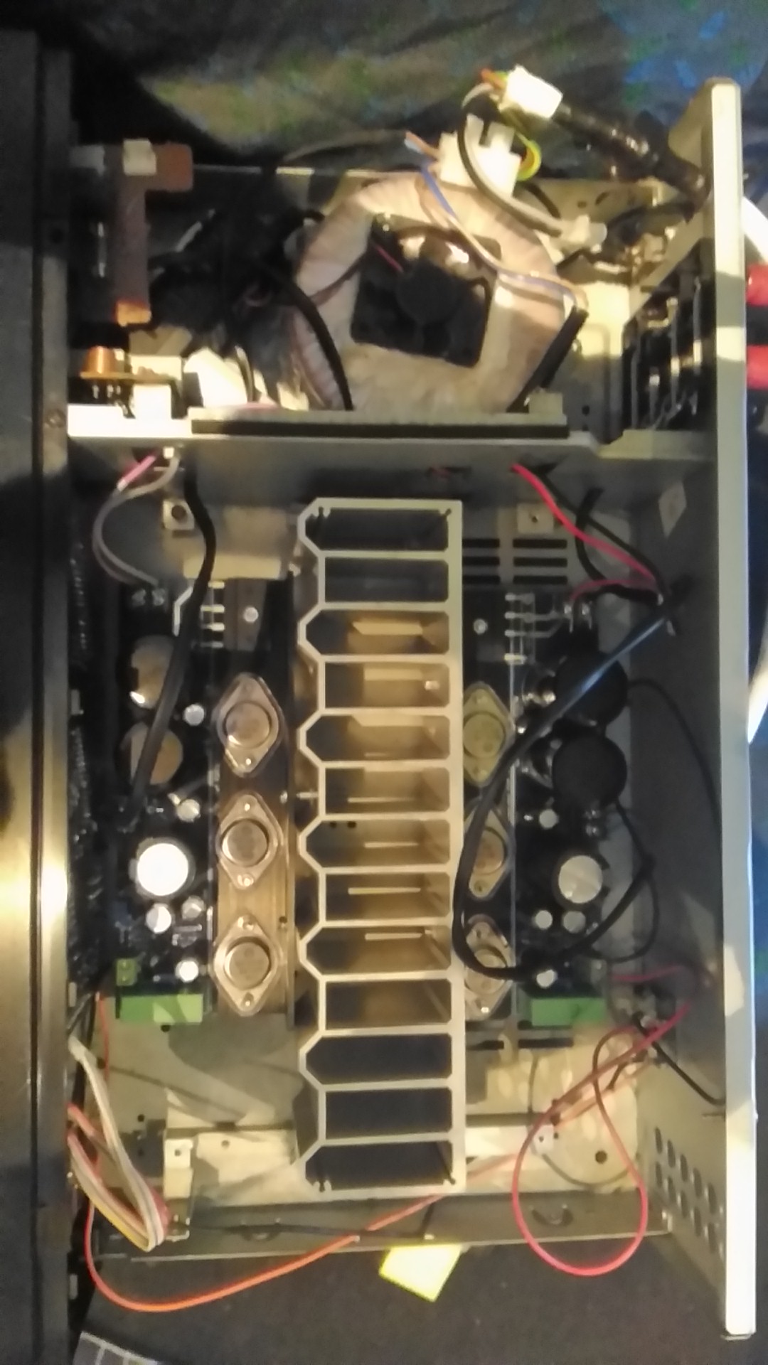

I bought this assembled modules on eBay , they only hummm through the speakers , I think it's a grounding problem but I don't know how to ground them. Is it a problem that both modules share the same dissipator? I have 4 fans on the chassis to prevent heating.

How have you wired them up?

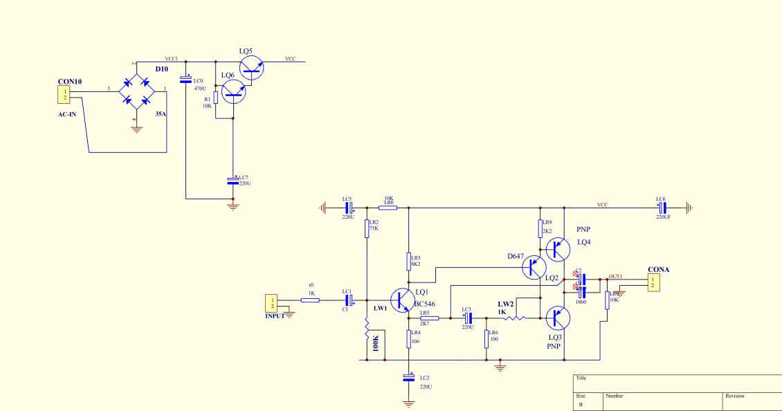

Could be they just don't work, often the transistors in these are fake

Maybe I need to adjust the Quiescent current to the 30v a.c. I'm using, still I think there should be a connection from ground to the chassis
Yes ground should be connected to chassis, usually at the inputs.
But you need to set the quiescent current and bias.

Thank you Ubergeeknz for all your help , it's working fine , just had to connect input ground to chassis , my first amp build I'm still a newbie
