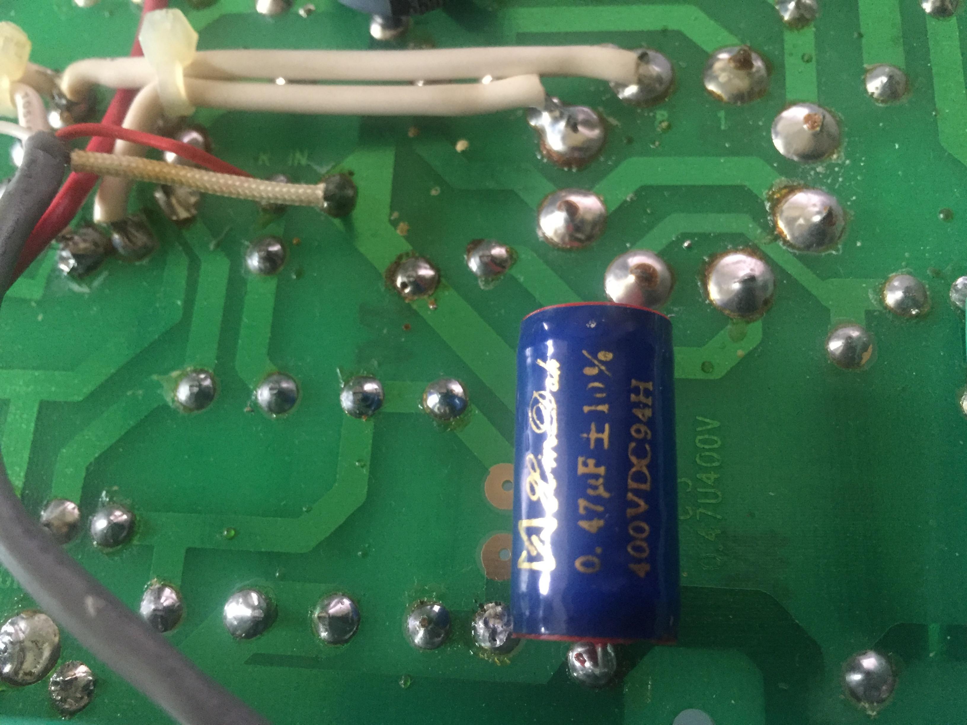

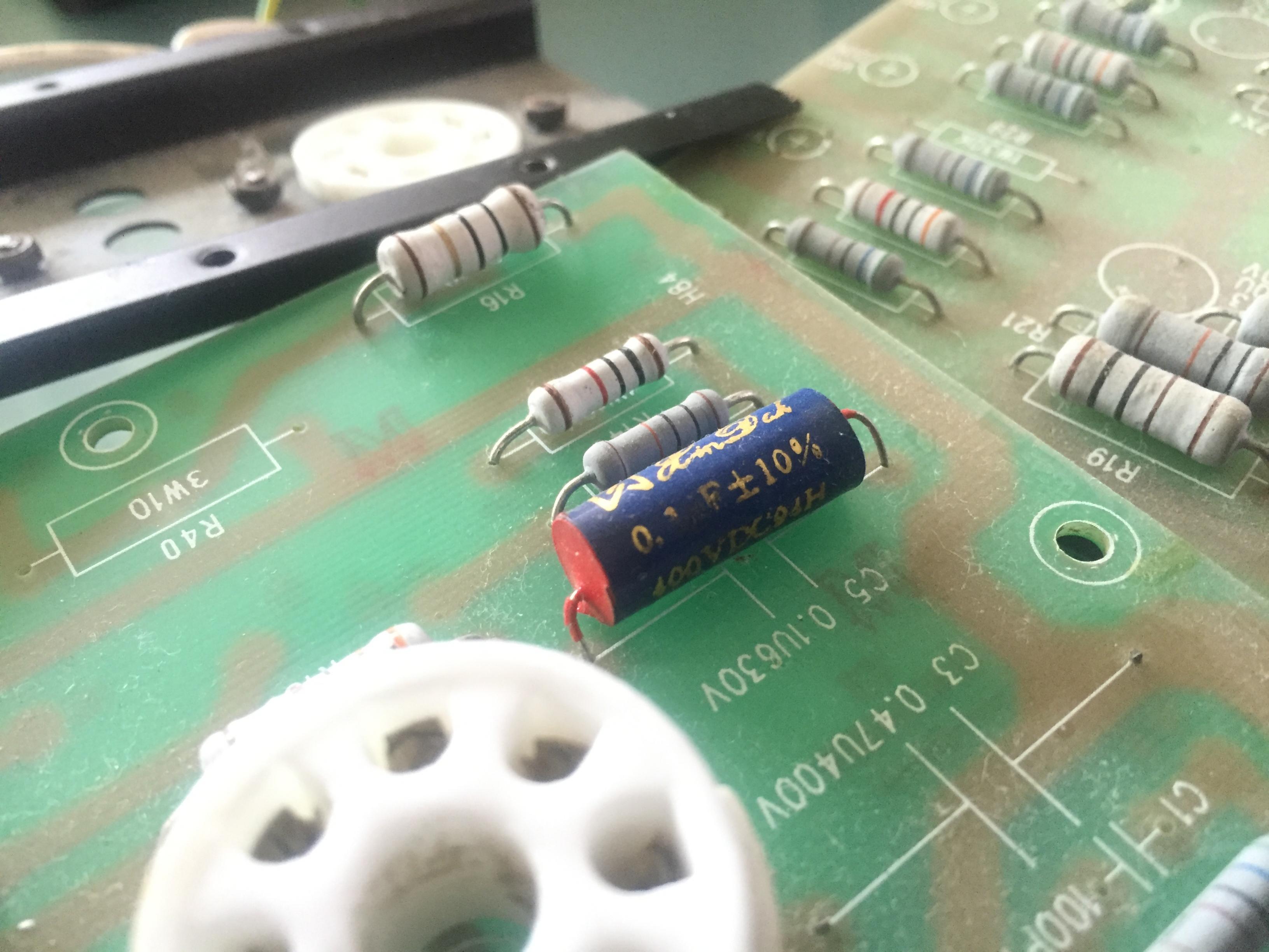

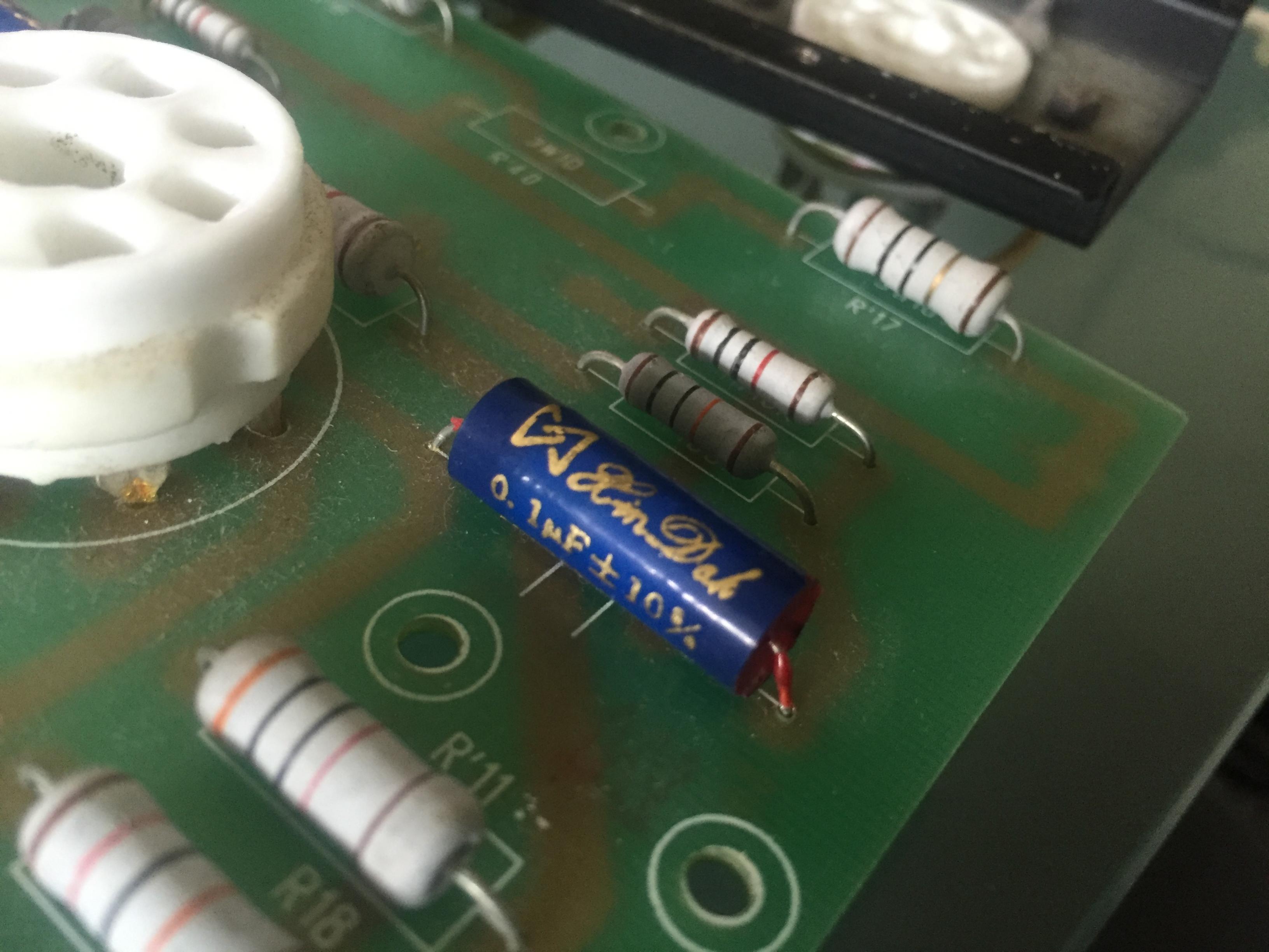

Hello,
Need help identifying the capacitor brand in the picture? Any opinions or experience with the capacitor would be super.
The project started off as just breaking down my tube amp so that I could get the case powder coated to a new color. Well like all projects one thought leads to another and I am considering updating a few of the capacitors since the amp is all broken down.
Thank you in advance for any input shared.

The 47 uf 400v 1% will be unpurchaseable in quantity one. If the seal is deteriorated you would have to buy come commercial 47 uf. hope you get a low value one, then parallel 1 uf or so caps up to the correct value. If 47's you receive are too big you would have to buy 33 uf then inch in with 10 uf, 3.3 uf, 1 uf etc.
The .1 630 v one should be plastic film if built after ~1966, and should not be deteriorated by age.
Brand here is just a (poorly) silkscreened bit of paint on the outside , a distributor may order a lot of the-same-capacitor-everybody-else-uses , ask for any "fantasy brand" printed on ot and sell them as something "different/special".
FWIW, a well known generic cap brand is SanWa , made by Sam Hwa Korea ; its president is Kim Tae Hwa, I can easily imagine they used his slightly altered name : Kin Dak, as a special order brand, maybe implying better quality product.
Or maybe there actually is some small capacitor company, called Kin Dak, symbol 2 stylized angular "D" , turning out these.
The point is: do they work?
If so, don't mess with them.
You might junk a very good but unknown cap and place an average but "mojo loaded" one there.
Don't "fix" what's not broken.

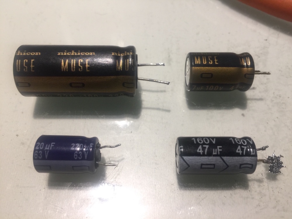

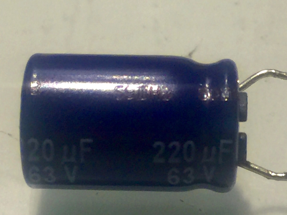

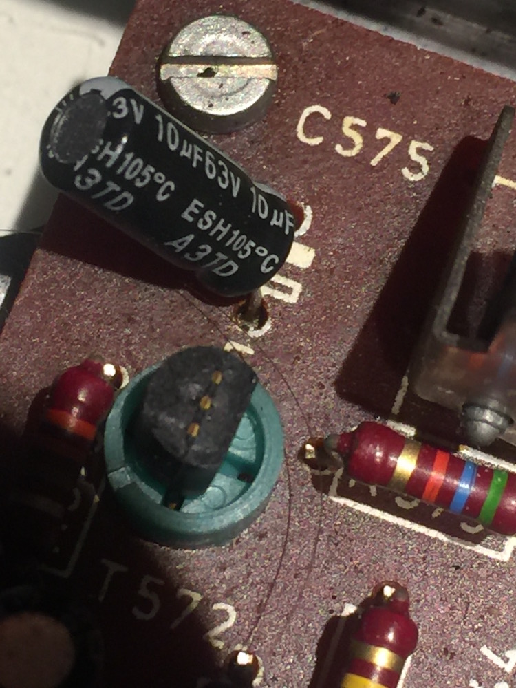

I need also help identify 3 capacitor brand and series
One cap on board and blue and black . (Black gold this is KZ Nichicon)
