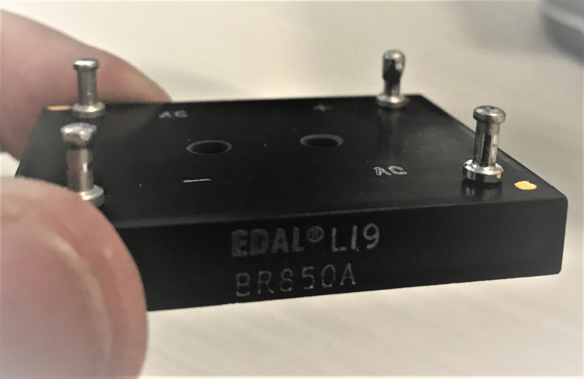

The bridge rectifiers that came with the system are BR860A. They are no longer available. Supposably HVPFR6 are the subs they say should work. Over a few months of operating, the HVPFR6 blows and shorts closed. Anybody have any advice on a better Bridge that can handle these voltages. F101 and F102 are 5amp slow blow.

Thanks for the input... We can get the BR850A for $248.82 ea. I'll have to bring this up to my shop...
Appreciate
the help...
Appreciate
Bit expensive i would say, 12 of the BYW96 should cost less than 10% of that, but its a beautiful bridge.
Btw, Semikron SKA1/17 is still in production, and 2 of those serial in each leg (each diode has 1.7kV avalanche voltage) .
A total of 8 would set you back €6 or so, plus shipping
Or 4 Diotec BY6's - 6KV, 1A, $1.79 each in single unit quantities.

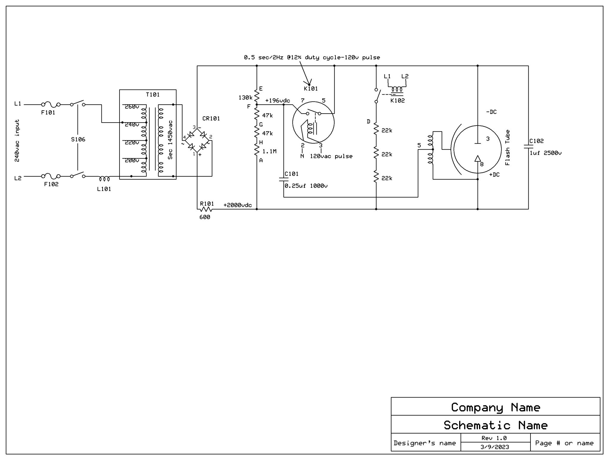

L1 L2 240V AC
Do you hook this on two phases of a triphase mains power. Is this common at your place ?
Just curious.
The only place, I know in Europe where they do this is Belgium where they keep a 3X230V electric distribution network.
Just curious.
No, its standard 240v US. Same as what goes into every house. They call it 240 single phase but I call it split phase because all US houses use L1 for one side of there breaker panel and L2 feeds the other and for 240 appliances L1 and L2 feed a 240 breaker.
This is actually part of a MALSER system, (RAIL), that airplanes use to help them land. It's a visual aid, the 5 strobes flashing toward the runway that pilots can see as they are starting to land. It's been in service since the early 60s...but rebuilt many times.
