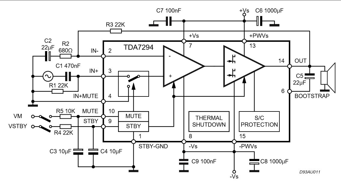

When you desolder the chip, power up the board and check voltages at the pins. It's easy to figure out what the voltages should be by looking at the schematic. If one of the voltages is off, your amp still won't work right.

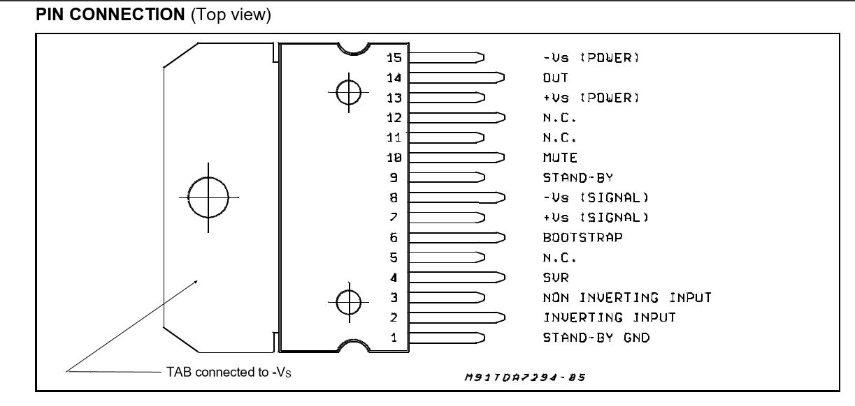

Have you checked the supplies to the TDA ? It will use a circuit similar to this.
Pins 7 and 13 should be plus say 40 volts (whatever it runs on) and pins 8 and 15 should be same but a minus voltage. Be very careful not to short anything... and you really need to measure at the chip to rule out broken/cracked prints and so on.
I don't mind giving it a whirl. Which pin is 1 on the TDA? I couldn't tell from the diagram I saw online if it was the front side or back (back being the side that attaches to the heatsink) can I measure from the back side of the PCB instead of on the chip I know it doesn't rule out a bad pin or solder joint but the heatsink wraps around the chip so i can't get to anything. Sorry for being a total noob here. I've done lots of soldering of speaker crossovers but that's the extent of it for me so anything amp related is a total mystery.
There was no washer on the amp. The ic is clamped to the metal heat sink via a metal plate and screws.
I did power up the amp and test those pins. I assumed pin 1 was on the left side of the chip if you are looking at it with the plastic side with the chip number on it. I got 0v on both those pin sets so I either did it wrong or something is messed up.

my assumption is the pin i circled in red is pin 1
