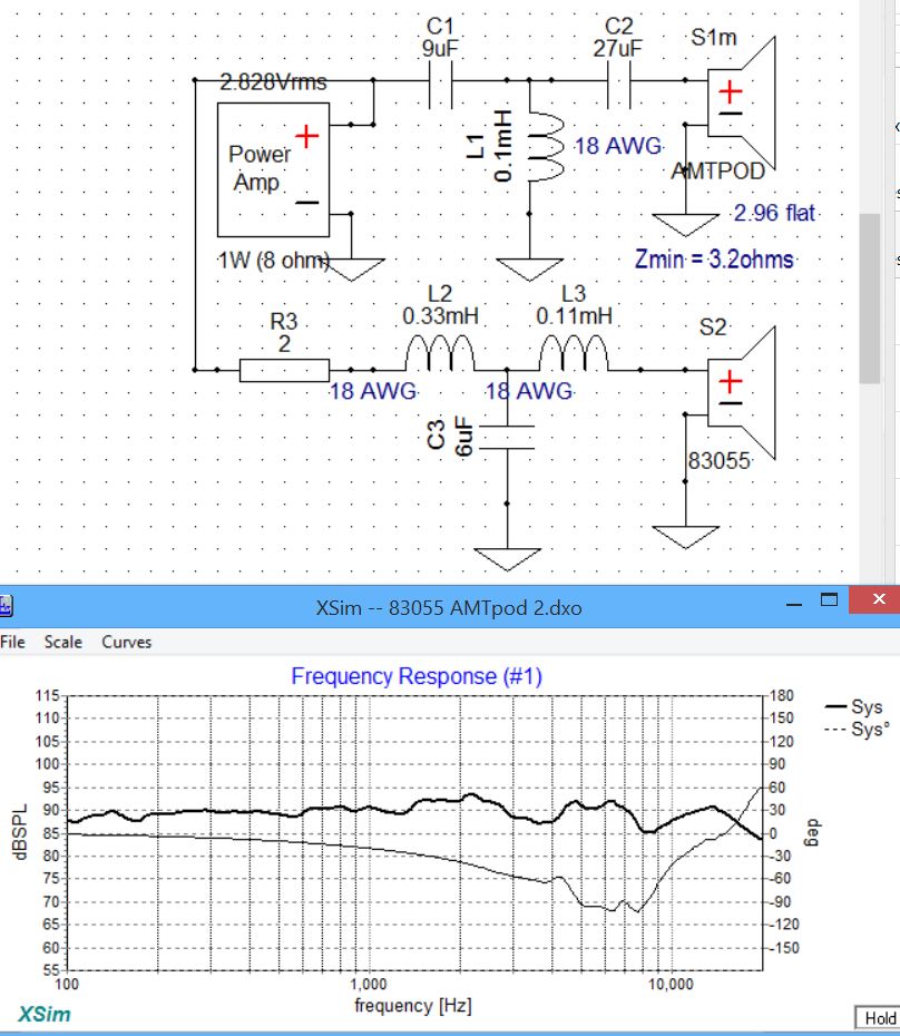

Can someone please help me with a crossover design ? Or point me to an off the shelf crossover I should use ?
SHORT TERM SUGGESTION:
Use your current 0.5cuft SDS 830855 Speakers by adding a mounting board for your AMTPOD and adding a 5,000Hz crossover. Do not invest in passive radiators. Attached crossover based upon Dayton FRD ZMA data. CROSSOVER parts are EXPENSIVE, and I do not have any measurement data, so you will get less than optimum results from just datasheet FRD ZMA values.
The Dayton Audio AMTPOD-4 are super tweeters which require a crossover above 4,500Hz. The SDS 830855 shows breakup above 5kHz.
The successful Pioneer BS22 speakers are a traditional 2-way design in a 7.1W*12.8H*8.5D (0.3cuft)cabinet. The waveguide on the tweeter provides controlled directivity and allows a smooth M->T polar transfer at a lower crossover frequency. Solid engineering. Build a similar 2-way KIT and you will be HAPPY with the sound.

This is probably the reply I was hoping for. Someone pointed out I was pointing to Dayton units instead of Tymphany for the Woofer. Is your suggestion valid for the tymphany ?
Jenni, you name the woofers peerless yet the link leads to Dayton.
Thank you for pointing this out. I have corrected this.
If you look at the FR plots of the AMTPODs and that Peerless woofer....
- The AMT doesn't seem to like <5KHz.
- The woofer has large peaks/breakup a little past 5KHz.
Looking at the Bantam driver ND91-4, that holds on until 9-10KHz and has seems to have a more benign breakup.
I'd also suggest that one 3.5" PR is not enough for a 4" woofer.
WinISD suggests that an ND91-4 in 2.5L ported enclosure can achieve 60Hz.
Would that be small enough/suitable?

It looks like my drivers will not work for the task at hand. Thank you for pointing this out.
