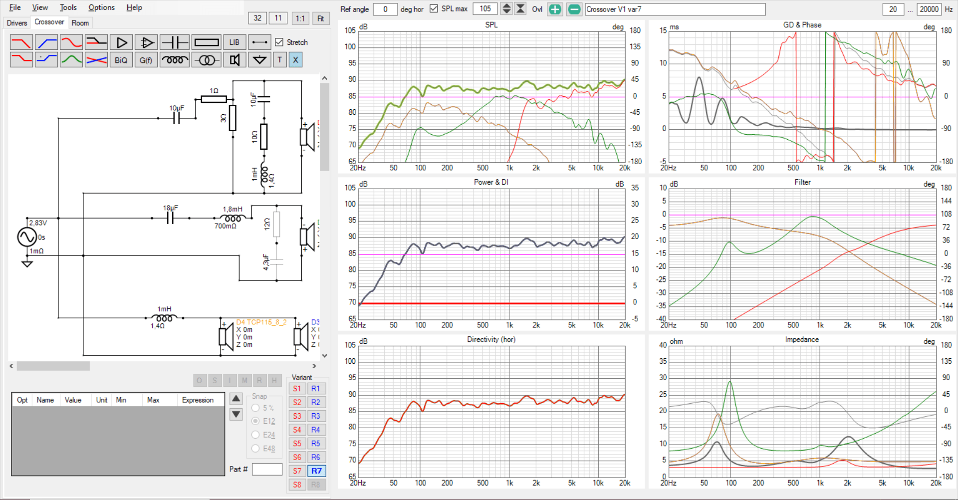

Hello, as the title says im building a 3way loudspeaker and im having trouble with using or not a lpad in the tweeter.
The tweeters has a sensitivity of 94db
the midrange is 87db
and the bass driver is 81.9 db, (also i should add that im using 2 bass drivers in parallel wich should give me a +3db boost).

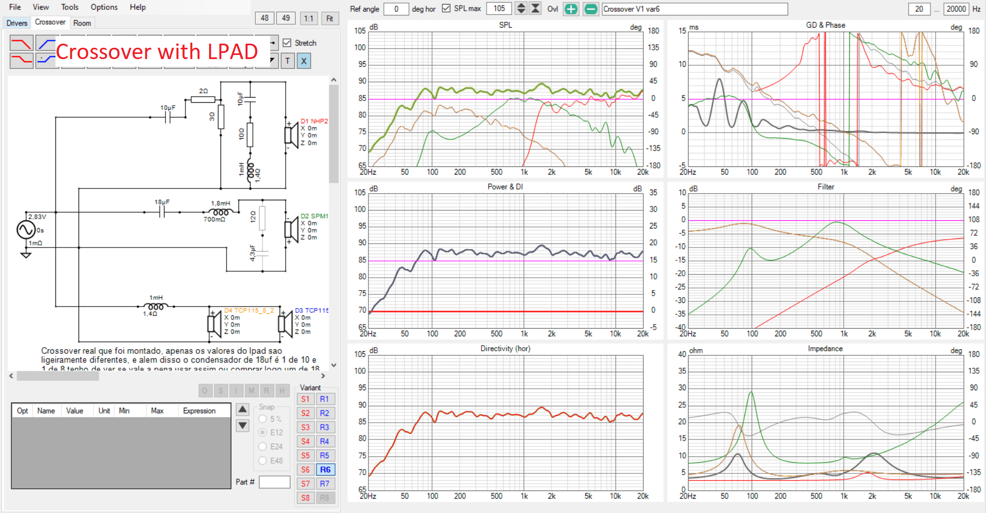

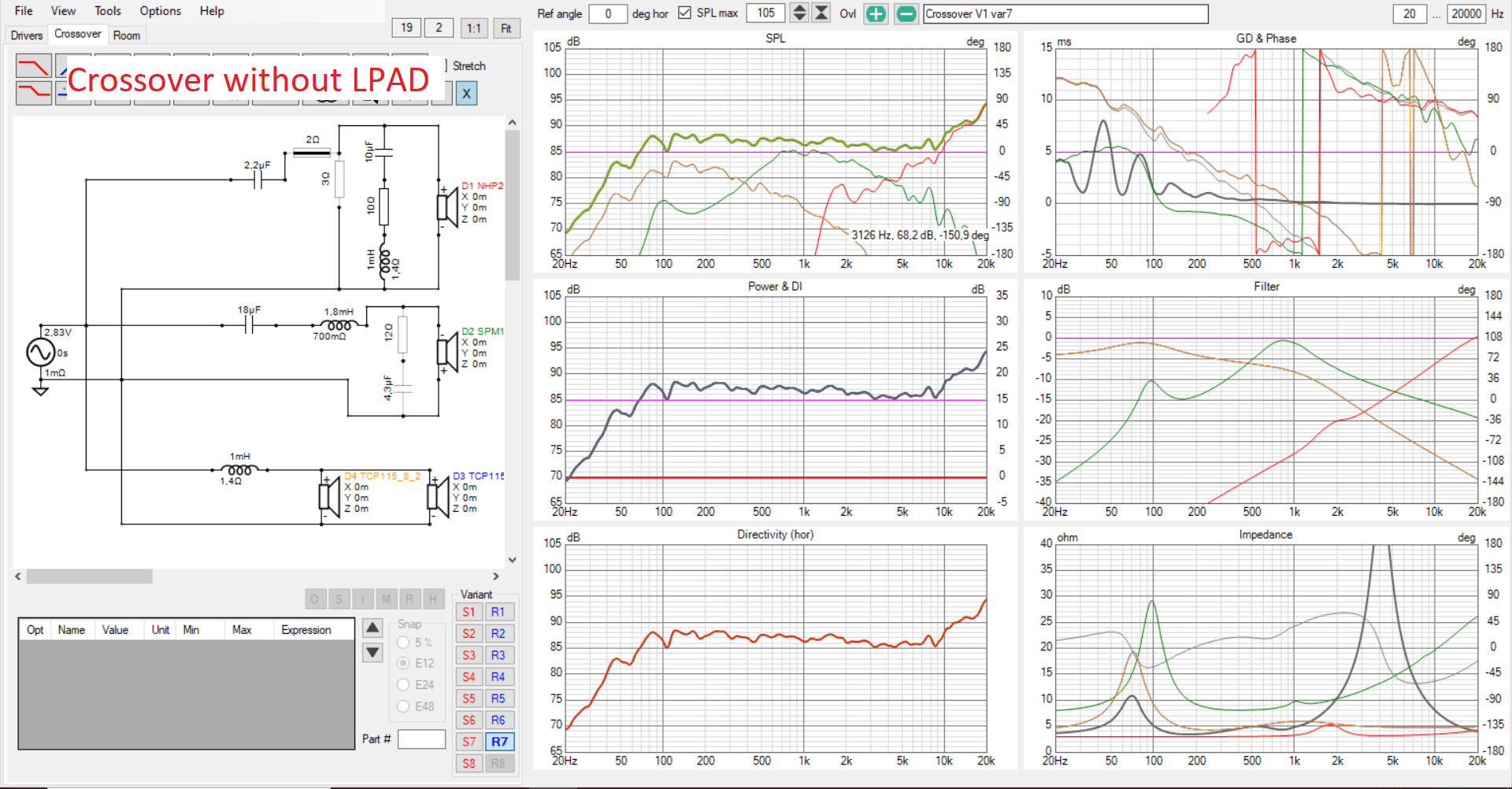

Here are the two crossover variants that im trying to decide between.
I listened to both of them and i can hear the diference but im not sure what is the most correct.
I also dont like the impedance spike caused by the 2,2uF capacitor, is this bad for the amplifier and speakers?
The Lpad makes the tweeter sound muffled, not using it solves that problem but now im worried that it is too much what should i do?

thanks for the info, but im not sure what to do next, i think i will try just using a resistor in series instead of a lpad, does that even work? idk i have to go to work, i will think about it during the day, im happy with the overall result of the build, its only my 2nd attempt at speaker build!
In your first simulation, it looks like tweeter level is a bit too low, hence the muffled sound.
You can adjust L-pad attenuation by changing resistor values. Current combination gives -6,7dB attenuation and 3,7ohm final impedance.
Try 1,5ohm series / 7,5ohm parallel. That gives -4db / 4,1ohm respectively.
I guess LCR across tweeter is impedance compensation at Fs?
The L-pad will flatten the tweeter impedance seen by crossover, so I believe LCR isnt necessary. Try to disconnect it.
10uF series cap for tweeter seems ok, but you may try slightly lower value to fine tune the crossing.
hello, just a quick update, i stuck to the lpad but changed the series resistor value to 1ohm and i liked it, without lpad it just sounds too bright, i wanted to avoid using it but oh well.
So rn im just trying to hear the diference between the original lpad (2ohm series resistor and 3ohm parallel resistor) and a new lpad with 1ohm series resistor and 3ohm parallel.
Here is what the "new" lpad looks like
