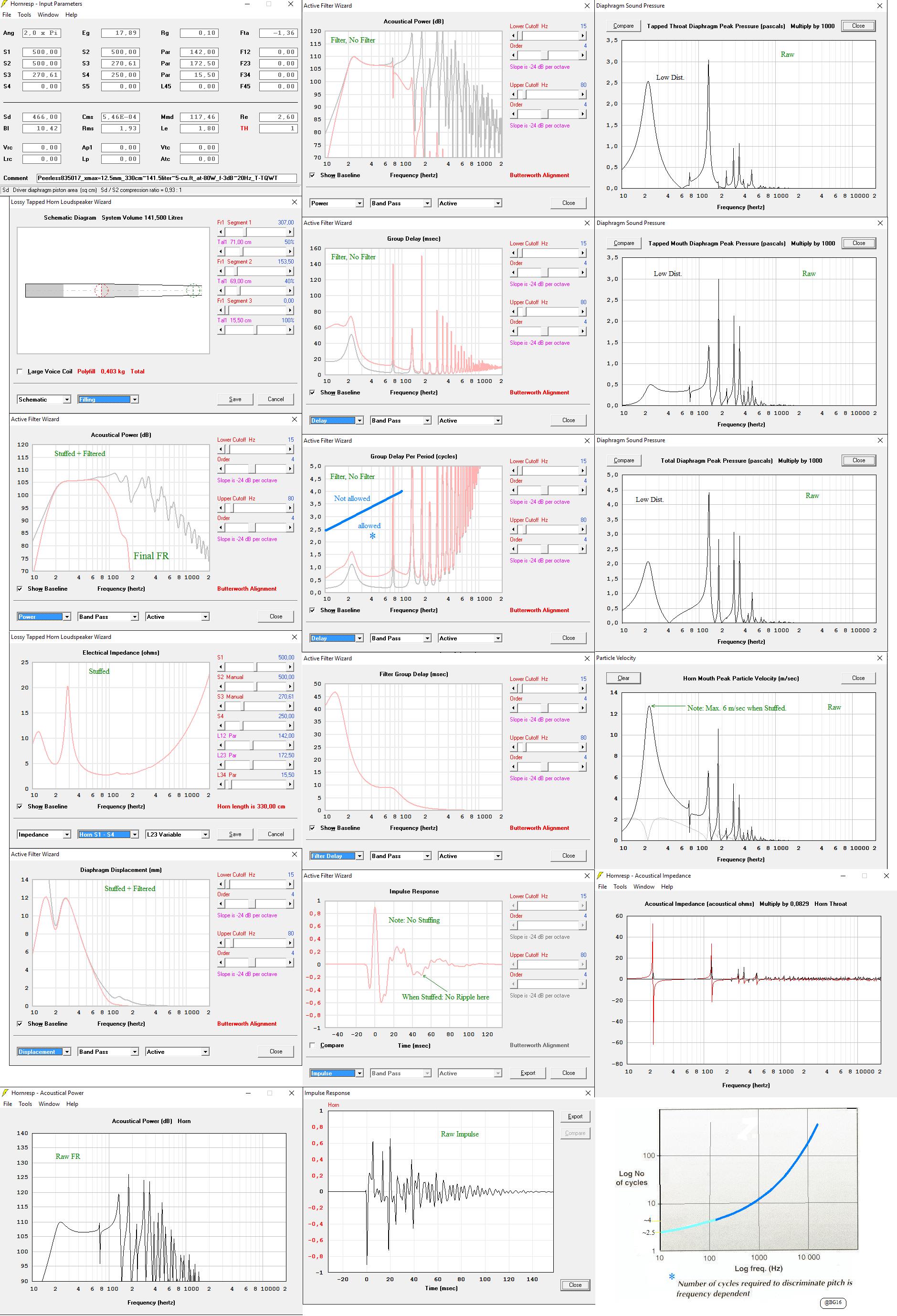

The data-bass web site has a great page on room gain. The pic below is from there. Your room is smaller than their test room, so I'd imagine your gain would start at a higher frequency.
Note that their measured gain was very uneven, even when multiple sub locations and measuring positions were used
... so you may have a 10dB boost or a 10dB notch at 20Hz, depending on where you sit, how your room is arranged and so on. Meaning some experimentation may be needed for you to get ~6dB gain at 20Hz.
In some of my own tests, I have measured big bass notches that vanish (for the same mic and speaker position) when I simply open a side door. You might find that changing the sub's position, adding or shifting bookshelves etc makes a similarly big difference for you.

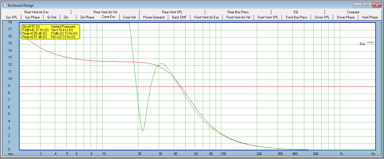

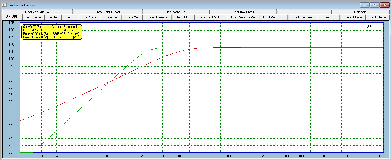

Obvious, another nice project for pros (op) John. Difficult to calibrate to taste, what might take a couple of years of fun with all the basics already set, meaning the xover components and sizes of enclosures.😀
3.5 - 4 cubic feet tuned to 22hz gets you an f3 in the low 20s. You will hit xmax at 30hz@175 watts and about 108db. This is maximally flat configuration.... For music, I'd go sealed 1-1.5 cubic feet. This puts your f3 in the 40s but you have room gain. This is perfect for music if you ask me. However the trade off here is you lose bottom octave. You can always use a minidsp or plate amp with a 6db bump on the bottom but you will hi excursion limits at around 100dB at 30hz sealed. Note though that you can still hit 108db in at 175 watts above 50hz... Obviously group delay for the sealed configuration is much better! Personally, I have a 12 inch HSU for home theater plus a stereo pair of peerless 10" subs sealed and crossed to bookshelf fronts! A pretty great sounding setup in my opinion. Since I'm a music guy, I'd rather have 1 od my peerless sealed subs over 1 ported HSU sub... Not to say ported can't sound great, but it's harder to get right the first time....

See attached graphs for model showing response, excursion and group delay at 175 watts for sealed 42 liter and ported 100 liter tuned to 22 hz.
