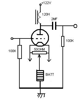

No circuit parafeed.Were you aiming to use the choke in a parafeed type circuit with feedback, as there are then other low frequency resonances to work through.
Something simple.
Like this circuit here:
The diagram published is only indicative, as are the values of the components shown. These will be decided after the choice of the driver tube.Is there another load than the 100k? 2mF is a substantial capacitance, and e-caps may add some complexity if output dc offset is a concern.
Something simple.
If you use a simply attenuator, like 20 and 40 dB, you can check with Arta o REW the performance of the real circuit taking the output signal.
MAinly at low and high frequency
With a 24bit/192 kHz sound card ( tha have a not an great headroon in input) you can have a bw of 96 kHz that is enough to understand the way.
The response and the Thd vs freq are the basics tests
If you use a simply variable negative bias you can see also the results at low frequency changing the bias current of the tube.
