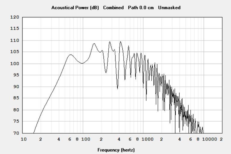

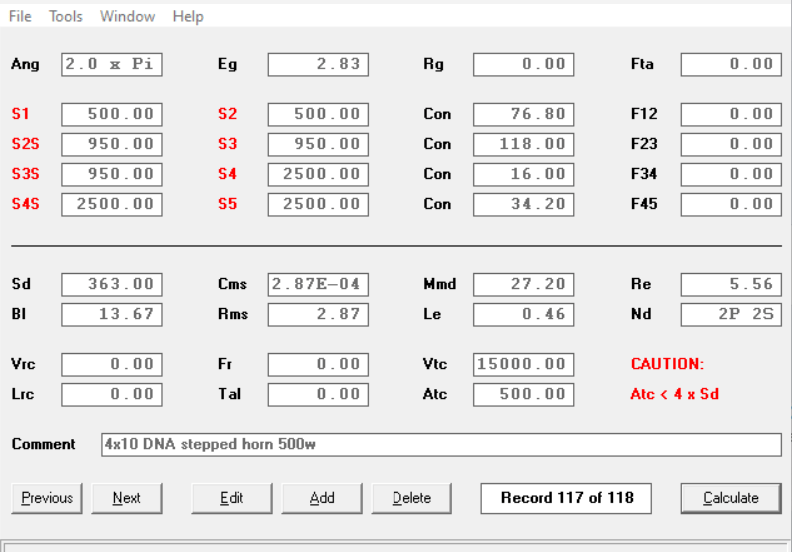

Hi Folks,

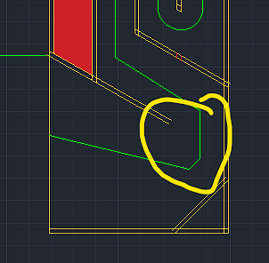

Giving up on the idea of a 4 driver TL for bass guitar use, I have set about designing a rear loaded horn. It is not a subwoofer, but I thought this would be the best subforum to post this.
Design goals are as loud and low as I can get without exceeding ~350l (constructed box volume) in a full range enclosure.

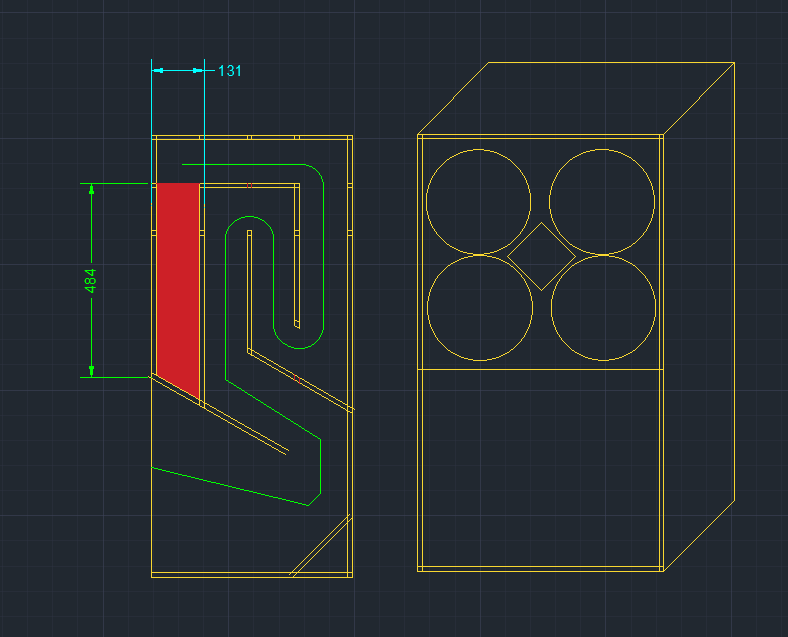

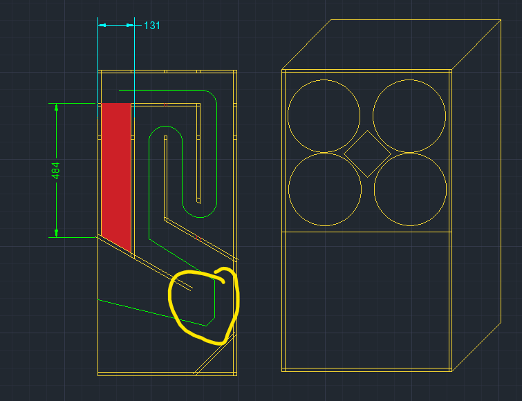

I have a problem modelling the rear chamber (red section in the above photo)
With VTC set at he right value and ATC set at zero, I get a response I like
My problem arises when using any value other than zero for ATC. It doesn't matter whether I set the figure at 0.01 or 99999, I get the same response, which looks quite a bit different. I would have thought tweaking ATC should change the response.
Perhaps the correct way to model this is as an OD, but can someone explain why the value of ATC changes nothing once it's over zero? The same happens with VRC and LRC.
Also, I'm very open to suggestions for design improvement. This application is not hifi, so a smooth response is not required. I'm trying to keep the constructed box volume below 350l, and the drivers are intended to be run full range. I don't need excellent performance in the 30hz range, but some loading down there is very desirable.
My hornresp file is attached
You have resonances masked
@Brian Steele it’s roughly the volume of an Ampeg 8x10, which is an extremely common bass cab. I set it as the upper limit of size for this project. I’ve got plenty of smaller cabs I can roll out if I don’t want to get the big guns out.
There might be some posts on effect of throat chamber volume/shape. MJK at his quarter-wave site has detailed discussion papers including guidance on and reasons for coupling chamber sizing in a BLH. Hornresp loudspeaker wizard allows simulations that almost in real time, displays the spl impact at the horn mouth/driver/combined of the chamber volume. Listening will be the real judge. If you set the “path” distance in the loudspeaker wizard the response will look smoother.

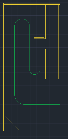

In the example below, which is the correct measurement of Ltc the green or blue dimension?
Neither in that you have to adjust all the bends, termination per this bend computation (71.4 cm, attached)......BTW, at a glance your HR sim needs to be ~ completely redone, hence the inability to add a low pass filter, so first switch to offset driver (OD), then switch the 214 cm spec with the 27.80 cm to get the drivers to the end of the pipe and then you'll likely find that you'll have to redo the horn construction to add one of any (if any) worthwhile use due to its high CR IIRC. 🙁In the example below, which is the correct measurement of Ltc the green or blue dimension?
edit: driver for my records? '10DNA' returned nothing audio related
@GM The 27.8 section at S2 relates to the second last bend in the horn (circled below), not the segment that the drivers are in.

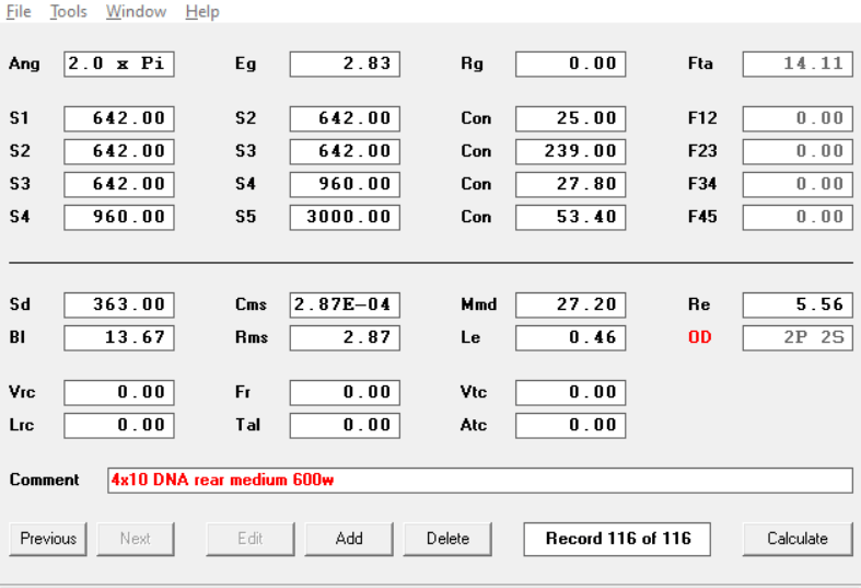

Are you suggesting that I should model this without a throat chamber, and instead modelling as an offset driver horn?
If I do this, do I need to model Vtc at all?
This adds ~50cm to the horn length, and presumably, I model the location of the drivers at the midpoint of the two sets (~25cm from the start).
Doing to gives me this, which is much less pretty than modelling with a throat chamber and a shorter horn. Still useable, but the dip at 100hz is not great for bass guitar.
The drivers are from a commercial bass guitar cabinet (DNA) and have been measured with DATS v3,
As from compression ratio it currently sits a whisker under 2:1 - I was of the view that this as not at all high.

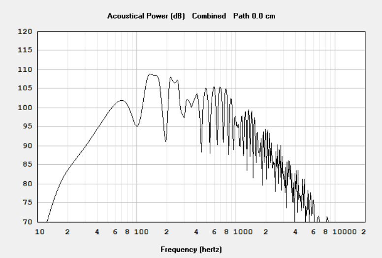

I have attached the Hornresp file for the OD model. Feedback is very welcome. I would especially like to know how I would tweak the design to get a response per the throat chamber model, rather than the OD model.
FWIW, the path through this section of the horn could probably be mapped a bit better. I'm not sure how much difference it's going to make however.
The dips at 200, 300, 420, 550 and above are also not great for bass guitar.Still useable, but the dip at 100hz is not great for bass guitar.

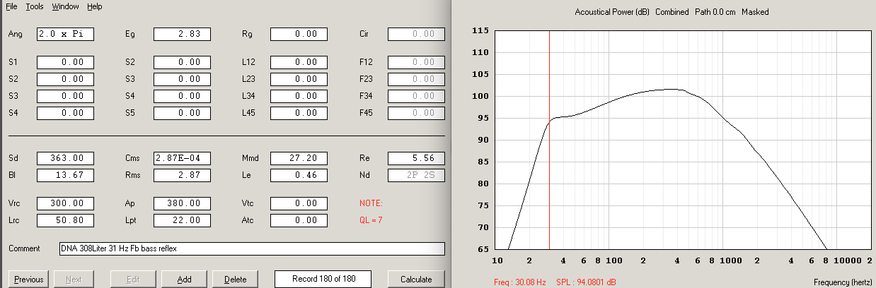

The big peaks around 160 Hz and 200Hz often are where room resonance occurs, I've found excess in that range sounds "muddy" on stage or in low ceiling venues.

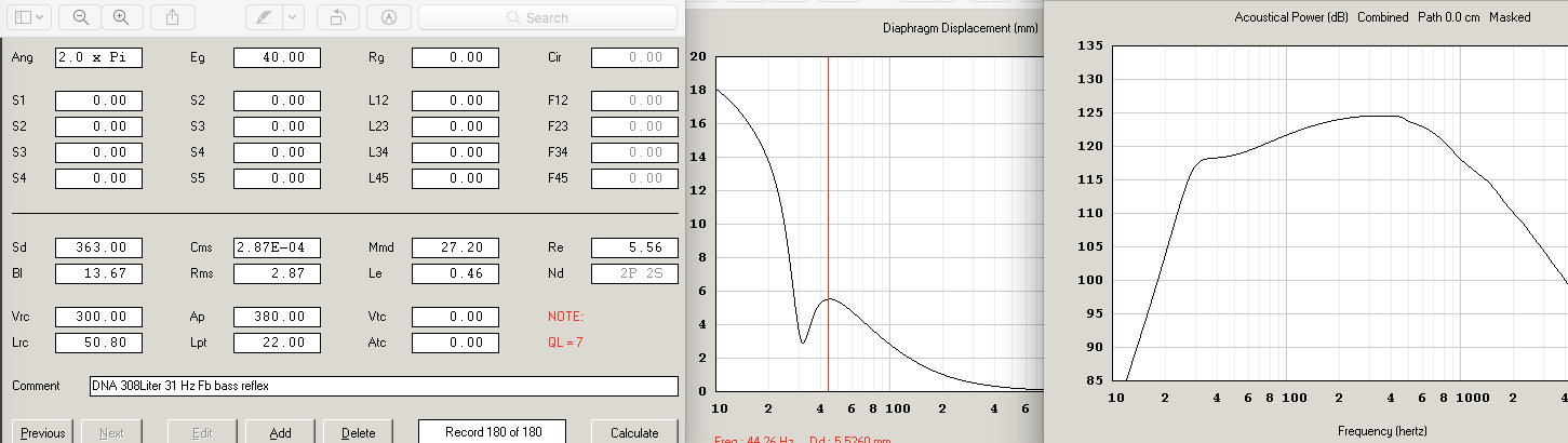

A bass reflex of similar size would have about 4dB more output at 30Hz, sounding over twice as loud down at the low B, and smooth rising response above, close to the same average sensitivity other than the octave from 160 to 320Hz.
At 40 volts (around 200 watts into "8 ohms") the BR would keep up to a loud drum set, and have way more low end than an Ampeg 8x10".
It would do better regarding your design goal of "as loud and low without exceeding ~350l (constructed box volume)" than the back loaded horn, and its weight would be about a sheet of plywood less 😉

I had considered a large bass reflex, but had written the idea off due to poor power handling. While you are quite right that 200w into a large bass reflex 4x10 will keep up with a loud drummer, I already have several cabs that will do that 🙂. I was really wanting to do something different and more efficient than a regular bass reflex.
I hadn't considered the peaks and troughs above 200hz, as I had assumed that the folds in the horn would filter much of these highest frequency resonances out. I know JBL quoted that their 4530 and 4520 speakers essentially became direct radiators above 150hz. Has this not been your experience?
One more comment on your bass reflex proposal is that it is very much limited to 200w, and comparing maximum spl curves between it and a BLH, it's only around 35hz where the BR becomes louder. I don't need louder, and probably won't use louder in a live setting, but half the fun is "having louder" if I want it.

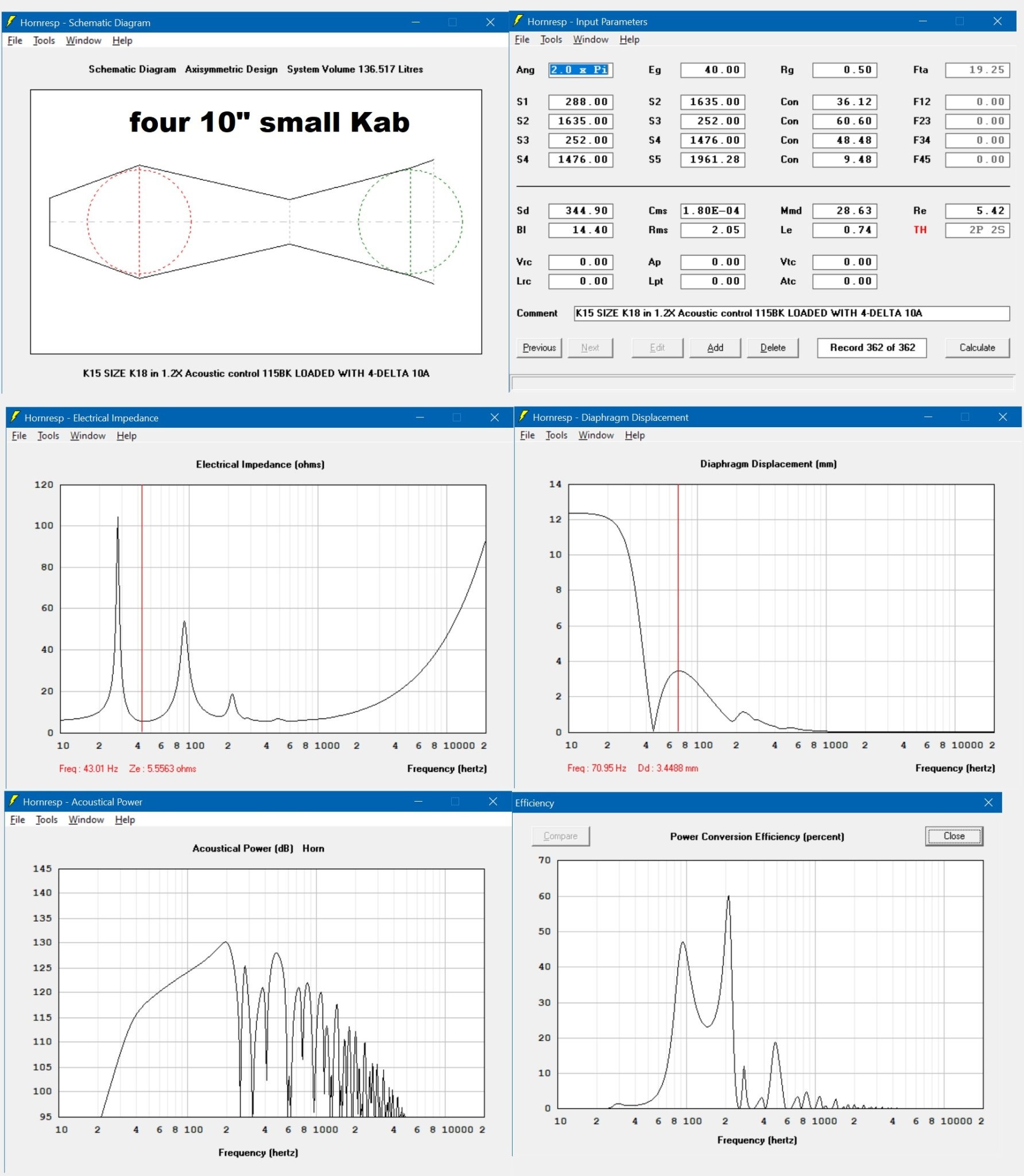

in ~210 liters external bulk you could make a Karlson style box - it should have good "hit"if not dig loud down low. Here's a rough sim of a K15 sized Acoustic Control 115BK with 4-Delta 10A in 2pi /40v. You could adjust K15's dimensions to accommodate the 4x10 baffle.

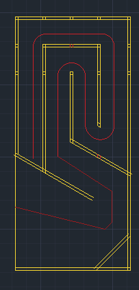

I've made some revisions to the back loaded horn, essentially making it a series of stepped sections to aid in construction simplicity.

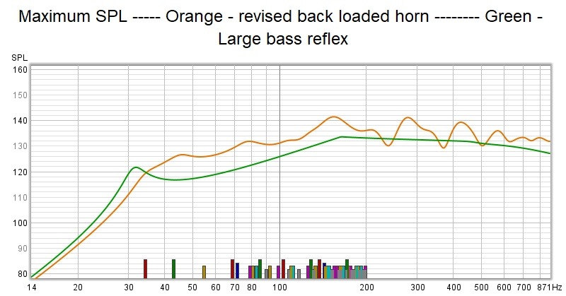

And here's a maximum SPL comparison between a large bass reflex and this current iteration. While sensitivity gain might not be significant, power handling/max spl seems to be.
This box (whichever way I go, and that might be a simple bass reflex yet) with be powered using a module bought from Aliexpress that has 31 fully parametric eq bands, so nasty peaks can be dealt with, troughs not so much.
I'd like to go with a rear loaded horn if I can get it to work. There's a cool factor that comes with it, but my concern remains the nulls at ~250hz and up. I would be interested to know whether these appear in practice.
There is, of course a reasonable likelihood that I haven't modelled everything quite correctly yet
set the path to be center of the 2x2 speaker array to center of the mouth. I think with some bracing that most of the cabinet could be made of good half-inch - 15mm plywood.
