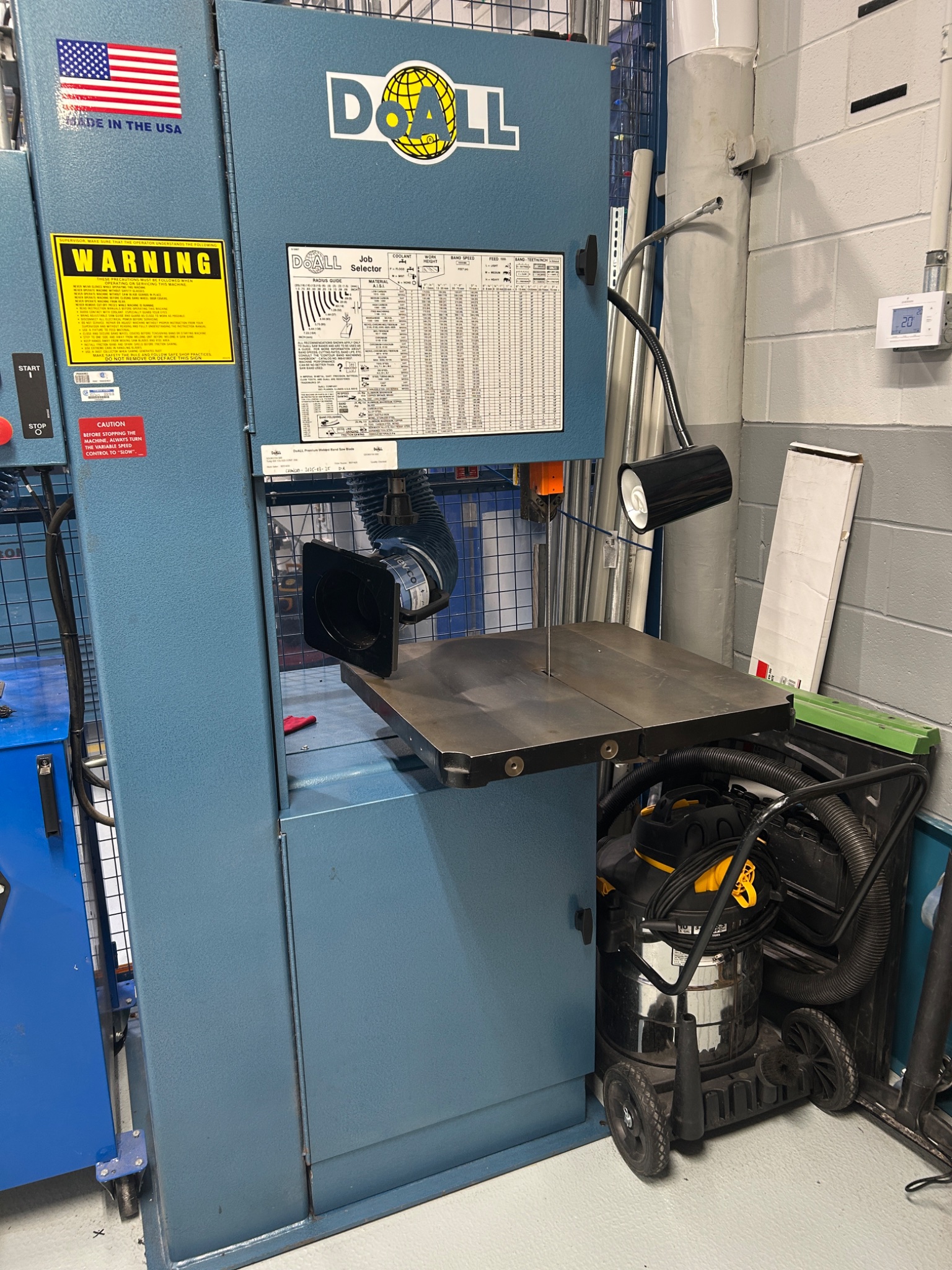

search either for waterjet or band saw, if you want to avoid additional milling

Find a machining shop that does work for tool makers, it is a fairly common machine.
