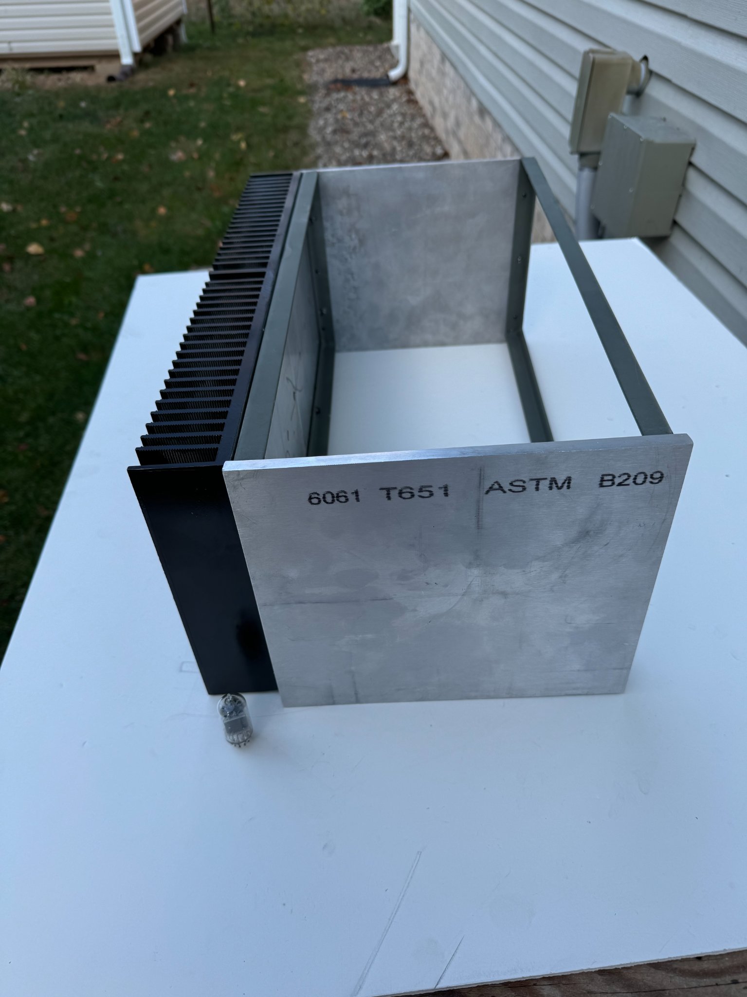

My main concern were that it’s 83mm thick (3.25”) and the machine must be able to hold a piece that is 10” from front to back.

WEAR SAFETY GOGGLES! My sinks were 17 pounders.
Wire cut (wire EDM).
Find a machining shop that does work for tool makers, it is a fairly common machine.
I also have access to a laser cutting facility that will cut 16 mm in steel, and abrasive water jet. Both will work.
Wire EDM will be ideal, gentle, no metal flying around, good finish.

How do you want to cut it exactly? Along the fins or across the fins? I have done such cuts using a miter saw with Al blade and it came out nearly as nice as if milled BUT it's a dangerous 😱 operation and requires some equipment and setup. If you want to cut across you will need to insert wood shims in between the fins so they don't vibrate while cutting. The miter saw is the type needs to be able to run horizontally so you can take passes. Take it to a metal shop I would say.
The appropriately named Mr. Metal in Toronto (not sure what part of eastern Canada you are in) will do this type of work for a reasonable price (tens of dollars - certainly less than the cost of a non-ferrous blade). They have water jet cutting equipment. Originally thought about doing it on a table saw but after one too many sudden and painful kickbacks with wood, I feared a kickback cutting metal.
