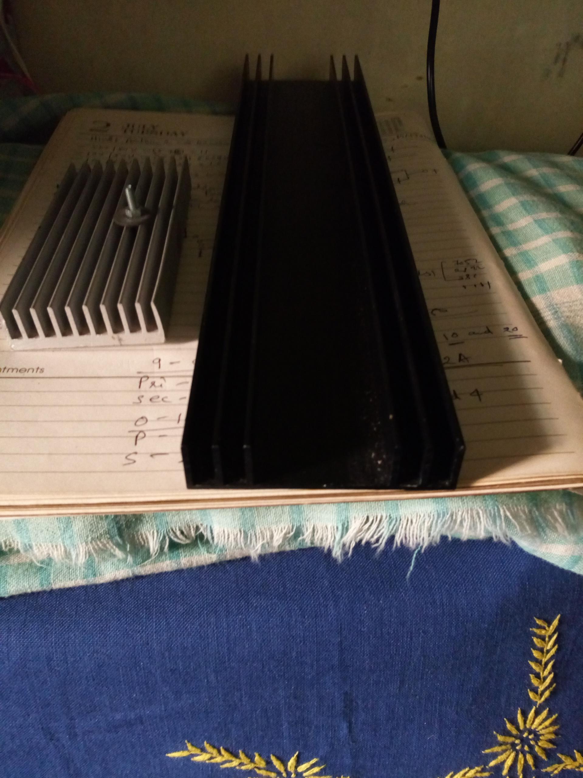

This time I have a query about the heatsink size for different types of chip amps like tda2030A, tda2050 etc..

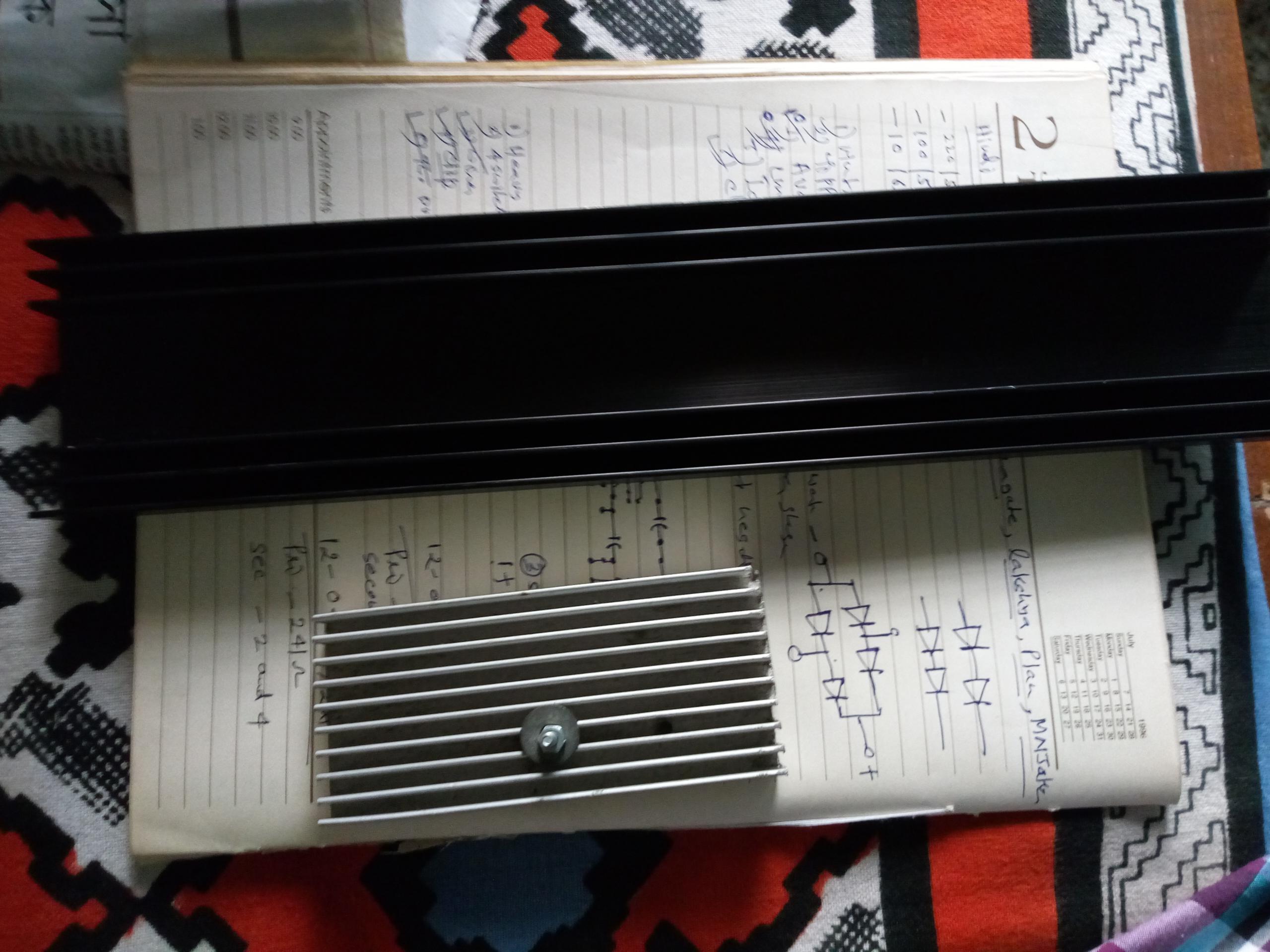

I have a couple of Heatsinks with me but don't know which should be right one for these chips. So I want to know if I use two of tda2030A or tda2050 chips to build a stereo amp then what size would be correct ?
I have one 4 inches x 2 inches and one 12 inches x 2.5 inches but I know that obviously it would not require too big to fit into a metal cabinet. So please help me about the size.

For 2 chip amps i would use the big heat sink.

i use a 2,3K/W small heat sink:
%product-title% kaufen
this is good for lab test and music listening at normal level...if i push at the max in 8R this gets really hot. use a temp measurement tool that at all condition the chip do not get more then 70°C!! during normal listening 1Watt - 10W the heat sink it is luke warm.

If you can cut the sink, chop the big one and mount each channel to a separate one. The smaller one might work for one channel.
I have used smaller and had no issues. But normally do not listen loud or have demanding speakers.

You can work out heat sink size from power dissipated and how degrees/c the heatsink temp rises by. For class ab this is about 40% of power output by amp.
I would aim for 20 degree rise max.
