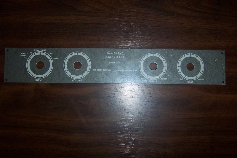

BTW- I have a close to mint A-9 face plate. Need it to have matching pair? I will mail it to you.
Thanks Amperex! That'd be great.. As far as i can tell, the only difference between the A-9 and the A-9C are the fact that the C has a light on it.
