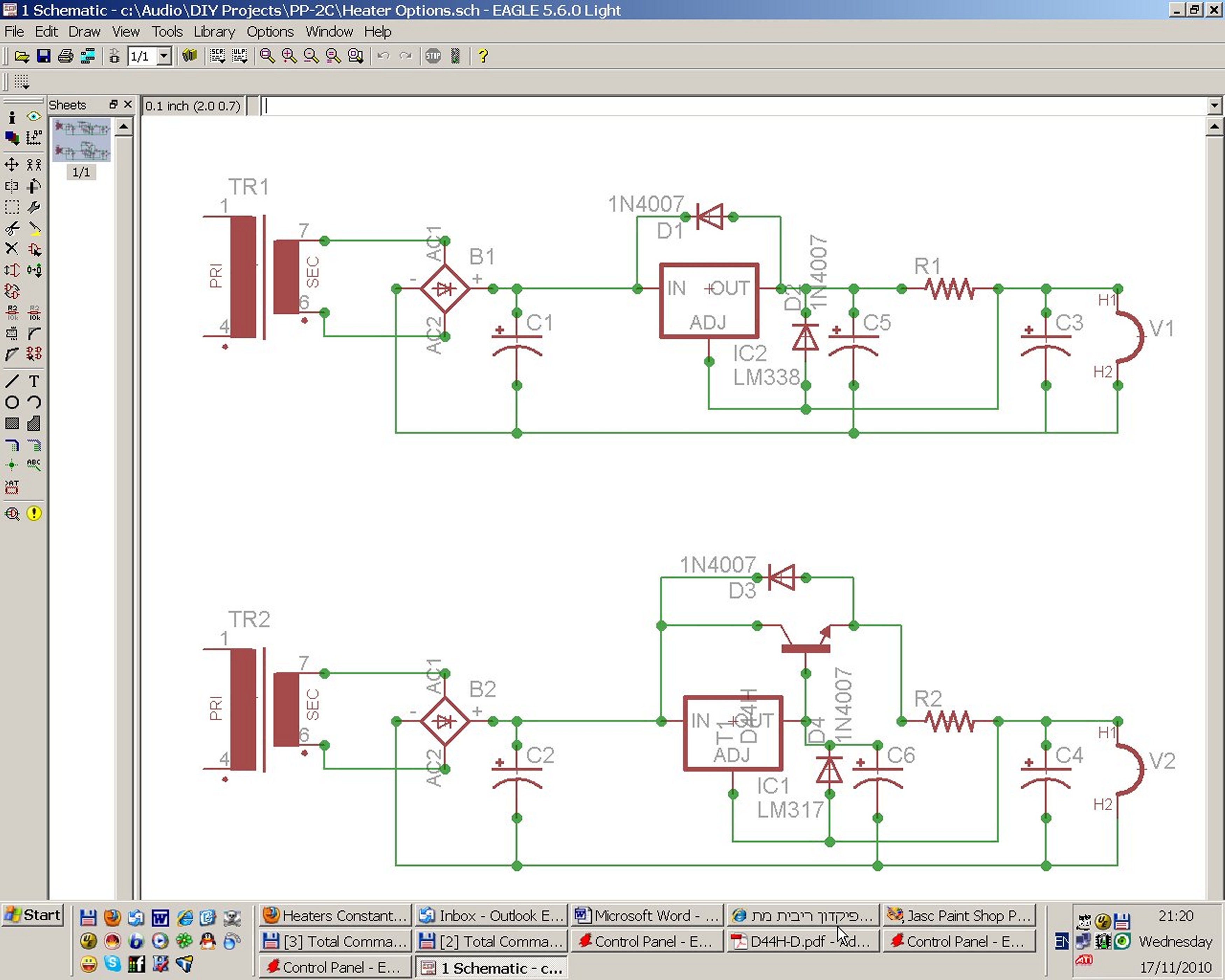

I need Heaters Constant Current Regulator for EL156, which draws 1.9A.
I can use LM338 regulator, alas, it is quite expensive.
The other option I have in mind is using LM317 regulator, which is limited to 1.5A, with power transistor.
Will it work properly, the way drawn in the attached schematic?

Updated schematic is attached.
I don't see any reason why that should not work. The output current will depend on the temperature of the pass transistor, though, as the LM317 will maintain 1.25 V across the Vbe + the resistor. As the temperature of the NPN rises, the Vbe will drop (-2 mV/deg C), hence the current will increase slightly. If this is acceptable to you, then great. If not, I suggest looking at an op-amp based solution. One op-amp + NPN + 1~2 resistors = current source (see attached).
Note that the resistor in your new circuit should be calculated from R = (1.25 - Vbe)/I and not the equation in the LM317 datasheet. So it's more like R = 0.6/I or 315 mOhm in your case.

Thank you very much, Tom.
I believe the transistor's temperature will be stabilized after a while, probably after about 10 minutes, or so. I can adjust the current and voltage when the temperature is stable. Unless the transistor's temperature doesn't stabilize in reasonable time.
A viable solution. It takes a stabilized voltage feeding the op-amp.
Thanks, that's obvious. 3 1Ohm resistors in parallel plus another one for accurate adjustment should do it.
