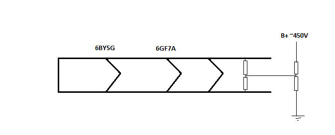

Is it possible to run the heaters of a indirectly heated rectifier tube and the other tubes in the circuit off the same winding without tying the cathode to the heater on the rectifier as long as you elevate the "center tap" reference to ground? Say, I have a B+ of around 450V, but no additional filament winding.
Will this work?
Will this work?

The 6BY5 is a indirectly heated rectifier isn't it?
I just figured applying the same heater elevation method as used for small signal tubes might work.

So, theoretically, to close the heater to cathode potential I could reference the heater center tap at 1/4 B+?

So, you think it will work? What value cap, and what wattage resistors? On line stages, I usually use 1W resistors.

Arbitrary 'large' value, say 22µF or 47µF. A smaller would suffice, but no matter.
Wattage of resistors can be calculated using ohm's law. Let's say the resistors are 220k and 33k, and B+ is 300V.
Total current of thru resistor string is I = 300 / (220k + 33k)
Then calculate voltage drop over 220k resistor U = I x 220k
Power dissipation is then U x I, so around 0.3 W. 1W resistors are fine.

As to the concept in general; on paper, it should work. Whether or not it's a good idea I cannot say. When I used tube rectifiers, I always had a separate winding for their heater.
EZ80 seems to have 500V cathode insulation. There might be some other recs that have more safety headroom.

What's the safety concern if it is properly fused and the heater cathode tolerance is 900V?
I'm serious. Just asking. I do not know.
There is no safety concern. Just use the recto like any other valve and elevate the heaters accordingly. Job done.

Maybe. There are some power diodes that are indirectly heated, but internally the cathode is connected to the heater. These types are no different from DH diodes like the 5U4GB, and that heater winding mustt float.
The only power diodes with separated, insulated, IDH cathodes are the TV damper diodes. These can be operated off the same PTX windings, and that was routine in television practice. Even so, it would still be a good idea to use a separate heater PTX to avoid capacitive coupling of AC noise into the heater supply of the signal tubes. It wasn't such a big deal in TV sets since the horizontal scan rate was very much higher in frequency than AC mains ripple.
