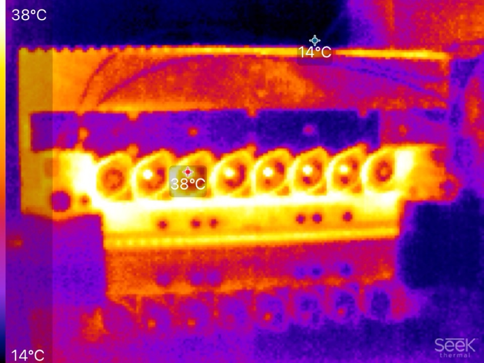

I did exactly this in my Pass F5TurboV2. It works very well.
Beautiful.
I see you have a copper bar for several transistors, so they cannot be mounted without insulation onto the copper. Do I miss something ?

The F5 takes the audio output from the MOSFET drains so the drains are all conviently electrical tied together and no dielectric is used between the transistor case and the copper. There is a thermal interface product between the copper and the aluminum bar. All the screws are electrically isolated using nylon bushings through the copper.
Note, bare copper and bare aluminum do not play well together when they are bolted together. Always use an interface product or some sort of plating on the metals.
