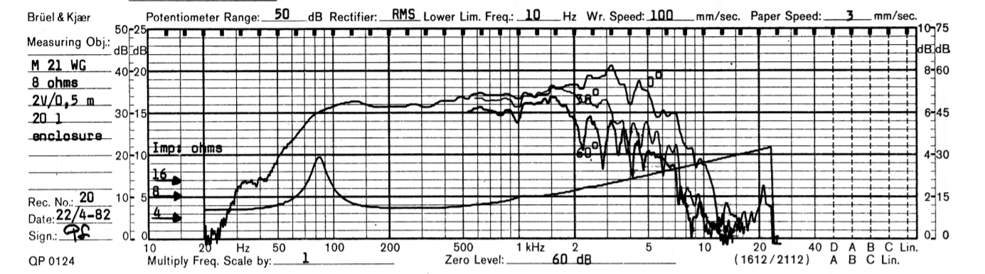

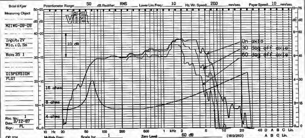

I've attributed this, I thought, to the old tweeters and started looking for an alternative tweak perhaps. I also went to look at the specs of the M21 and the HB1 (speakers before my time)... The M21's graph response looks close to a bass woofer's to me and Heybrook crosses the tweeter at 4khz?? Shows really what I dont know or understand about crossover points...
Now I'm thinking that the 'male voice funkiness' I'm picking up is the the cone break up or xover perhaps (someone correct me). This then has got me thinking of whether its worth looking for tweeters that can cross lower than the original vifa D25, from say 2k-2.5khz LR2 to keep simple. Am I thinking about this the right way?
The M21 are new production, not refoamed. It looks like they were used by Snell and JPW as well. Where did the other designers choose to cross along that graph?

A 4KHz crossover point is clearly not optimal for the woofer as it already beams at this frequency, but I don't think there is a breakup problem, as in this respect the woofer seems controlled.

Giralfino is absolutely correct about beaming, for a 8" driver this can occur at approx. 1.8Khz or thereabouts. Not many cheap tweeters will allow that crossover point and it takes time to weed out the ones that will do it and give a sensible match to the woofer's crossover slope.
Within the original design constraints they work well. Applying modern day practices and knowledge exposes some weaknesses.
Can you easily disconnect the tweeter and listen to the bass on its own? Does it still fail your criteria when you turn up the volume?
With the original bass roll off at circa 4Khz you might be amazed how well it does without the tweeter. However walk around the listening area and you should be able to hear the beaming effect of the 8" cone as the image collapses as you walk past the 30 degree points of a speaker
