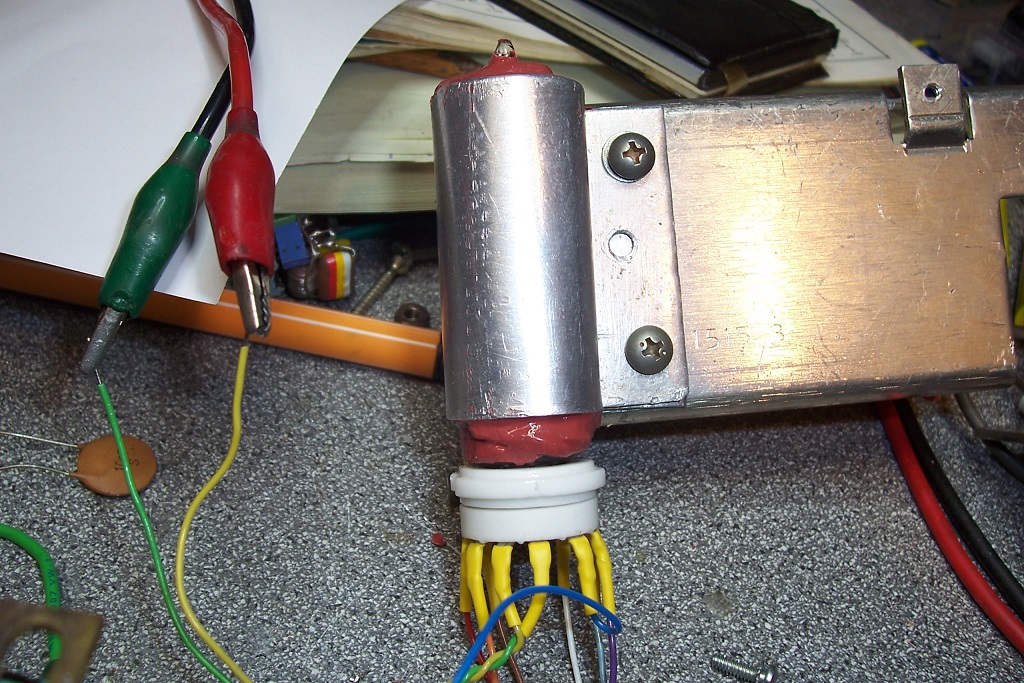

The trick I used is to fit the tube with a cooling clip, attached to a large heatsink, exactly as for a transistor:
attachment.php
The aluminum clip is 1~2mm larger than the tube, and a home-made compound of silicone 145 (high-temp) and MgO ensures the thermal connection and the mechanical protection of the tube.
The heatsinking arrangement keeps the glass surface at ~60°C, instead of ~260°C under free air conditions.

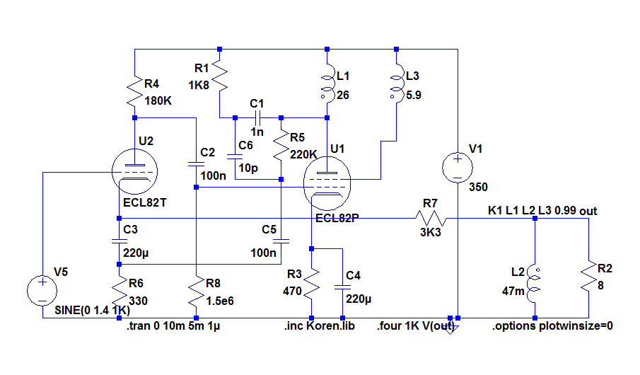

This is the circuit:
attachment.php
The supply voltage is 350V: taking into account the resistive loss in the transformer and the cathode resistor, it result in a 300V anode voltage.

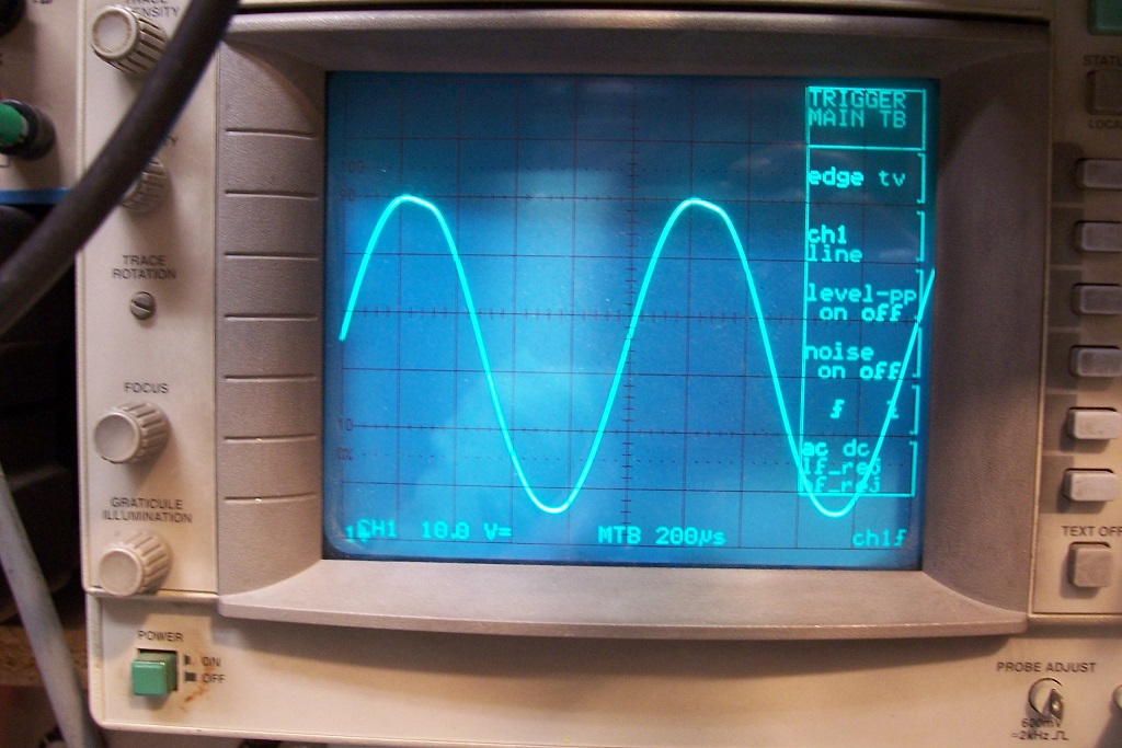

At a THD of 2.5%, the output power is 5.8W. This is the waveform at the anode in those conditions:

At 3W, the THD is 1.1%, and 0.25% @1W.
The 3dB BW at 1W is 10Hz to 26kHz.

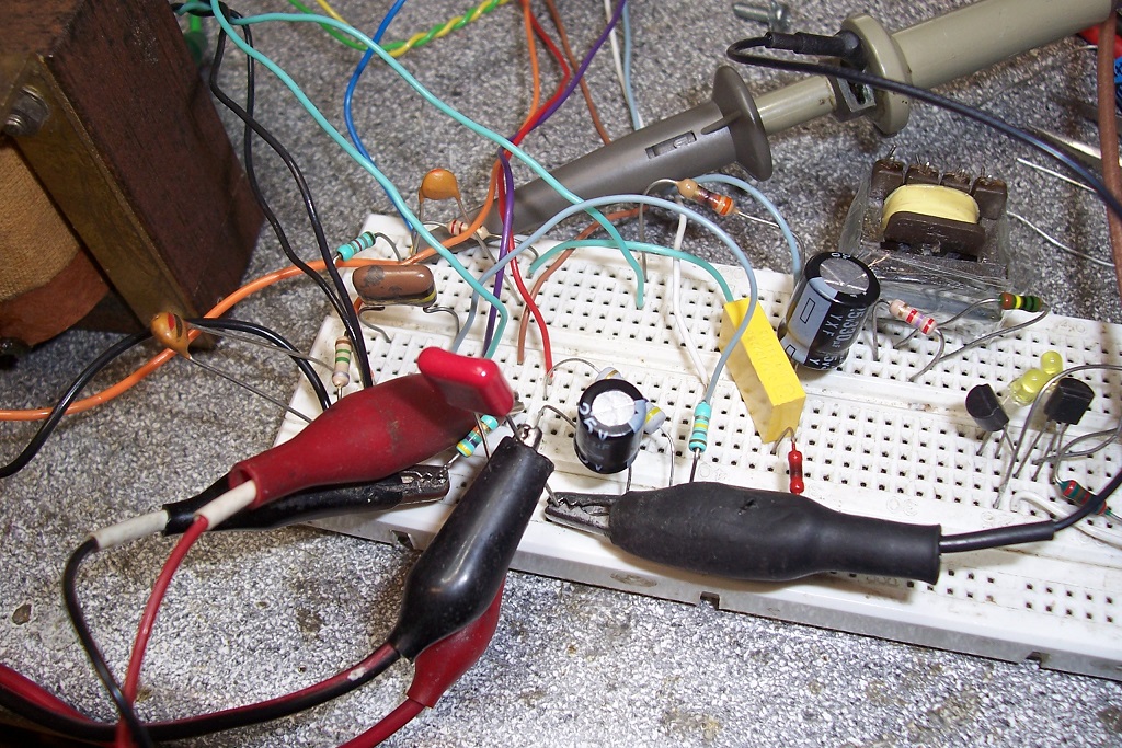

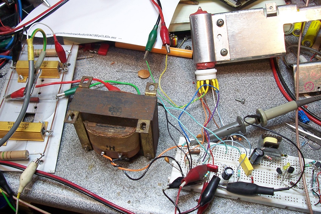

Here are some pics of the breadboard test:
attachment.php
attachment.php
Note that it is a true, bona-fide tube amplifier: no semiconductor cheat of any kind, not even a diode.

Also an interesting scope shot...
What was the THD at that signal level (54Vpp)?
It looks way more than 1%....I can't see any waveform distortion visually, at 1% THD, probably more.

The Vao is slightly exceeded as the scope shot shows:
There is a X10 probe in circuit, so the pp voltage is 540V, and reaches ~600V on the positive peaks.
That's 50V more than the allowed 550V Vao, but the amp is pushed to the limits and it is a deflection tube, with a 2500V peak anode voltage limit, so it should be reasonably safe.
Honestly, I was surprised to read only 2.5% on my THD meter: I would have thought it was twice as much.
If you look carefully, you can see an obvious clipping on the positive peaks... but it amount to 2.5%. Instruments do not lie.

I also measured the frequency response: at a 1W level, it is <10Hz to 26kHz (in fact it goes lower than 10Hz).
The 26kHz limit is probably related to the damping network: the 1K8 resistor smoked during the test.
The heatsink assembly looks pretty definitive, impossible to take apart, but it is not the case: contrary to 1-component silicone sealant, the 2-component casting silicone like the 145 has practically no adherence on smooth surfaces, like glass or aluminum.
I include the asc of this version, the only difference is the 560 ohm cathode resistor: I had to use a 470 ohm to arrive at 50mA, as my tube is used and probably a little tired.
