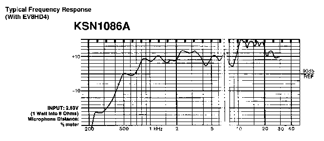

Some time ago, I sent away to Motorola and got a stack of flyers for their various models since then. I do not have the 1197 driver, but I do have the 1086 driver flyer. This might well be similar.
This 1086 driver is designed to play through an ElectroVoice horn. I wonder if the KSN 1196 horn is not similar to the ElectroVoice.
At any rate, I thought I would include the frequency response chart for the 1086 in case they are similar.
Note: the measurements were conducted, for some reason, with 2.83 V, (1 watt for an 8 ohm speaker) at a distance of one half meter, instead of one meter which it normally is. Therefore, the reading will be 6 dB higher than normal.
In other words, this speaker is playing around 94 dB, not 100 dB, for most of it's range, (except above 10,000 Hz).
If such a speaker were mated to your Eminence Beta 15's, they would indeed be shy in the midrange/treble area. Unless they were hooked up in parallel with a second driver/horn combo.

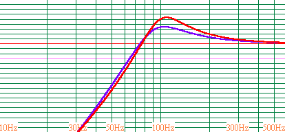

Well, Bull, I did some research.
The AC Euro 115 website gives the dimensions of the cabinet. Assuming it is one inch thich plywood, the internal volume should be something around 2.2 cubic feet.
The AC Euro site did not give frequency response charts.

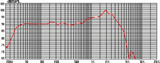

The Eminence site gave the chart for the Beta 15. It is below. You will see a huge peak at 2,000 Hz.
I ran the parameters for the Beta in a closed and a ported box, tuned to 50 Hz-most PA systems are tuned to about that.
The blue line is the lower frequency response for a closed box of 2.2 cubic ft.
The red line is the response for the 2.2 cubic ft. box tuned to 50 Hz.
As you can see, there is a pronounced hump in the response around 100 Hz. When you add it to the huge peak at 2,000 Hz that the Eminence gives, you have a reaponse with two pronounced peaks, one in the midbass and one in the treble. The midrange will suffer in comparison.
Here is the response for the Eminence. Only the response above 200 need be noticed here-the bass is not important in this graph.

Please look at the graph for the Eminence Beta. If you want to double check, here is the link:
http://editweb.iglou.com/eminence/eminence/pages/products02/speakers/beta15.htm
It would appear that huge peak at 2000 Hz plus a substantial hump at 100 Hz is leaving your midrange, (where most of the music is located), de-emphasized compared to the other ranges! If this is true, then this problem must be dealt with before you go changing piezo tweeters.
Remember that middle A on the piano is 440 Hz-piano manufacturers really slugged it out over this-and that is right in the middle of the de-emphasized area.
Question A: You say that you have four holes in the box. Could you please give me the diameter of those holes? It would help me find out to which frequency your box is tuned. Is there any tube attached to them, or are they simply holes in the wall? There is nothing wrong if they are simply holes-I have seen many PA cabinets tuned that way. Of course, a hole in a 1 inch wall counts as a 1" long port in the computer program.
Question B: Is there any crossover components attached to the Eminence woofer in your cabinet? If so, can you please give the values of the components? It could be that the manufacturer took the 10 dB peak at 2000 Hz out in the crossover. If not, then it is still there and will definitely affect the sound.
Djdan might be right. You might want to consider a different box entirely.
I am not convinced that a new piezo driver would necessarily solve your situation. Don't forget that they are all made by the same company, Motorola, and they are largely geared for PA work.

1. Yes the 4 holes measure 3 inches,and they at each corncer of the cabinet,the baffle board is 1 inch thick laminated plywood.
2. No crossover,except a 2w 30 ohm resistor on the positive terminal of the piezo horn driver.
3.The internal wiring is not soldered to the drivers,but it uses spade clips,the bass cable is 12 gauge ofc,and the treble cable is 16 gauge ofc.
4. Twin i/4 inch jack socket at back,connectors made by Neutrik

Among other questions, we have an new enigma here: just what is the cutoff of your horn?
The 1196 horn accepts a driver with a 1 3/8" threaded piece. Motorola makes three horn drivers with 1 3/8" threaded pieces:
A) The 1188A, rated 800 to 20,000 Hz, presumably when mated with the proper horn
B) The 1142A, rated 1,800 to 20,000, also presumably when mated with the proper horn
C) The 1197A, rated 3,500 to 20,000, also when mated to the proper horn.
The larger the horn, the lower the cutoff. You should be able to get good performance down to 3,500 Hz with just a 2" square horn. There should be no need for a giant 15" by 5" horn if you are only going down to 3,500 Hz.
Yet, the 1197A is mated with the giant 1196 horn, which can go down to 800 Hz with other Motorolas horn drivers.
Nobody is telling us if the 1197A driver will go down to 800 Hz when matched with the large 1196 horn. Of course, a horn driver with a number like 1197A implies a match with a horn numbered 1196, but the specs seem to indicate otherwise. Why, oh why, would they list the 1197A horn driver as being useful down to 3,500 Hz if it is designed to go down to 800 Hz when matched to an 1196 horn?
There is no Email address to the CTS Automotive Division, which apparently handles the piezoelectric speakers for CTS. I will give them a quick call and see what they say tomorrow, assuming they are open. It is Columbus Day over here-they possibly could be closed.
