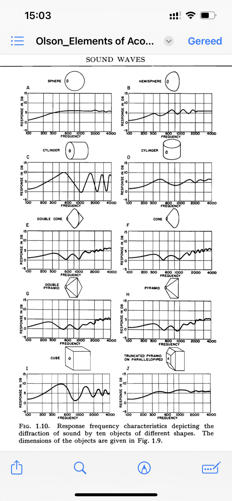

Have you ever thought of rotating the CABAFFLE?
I have just the glimpse of an idea we could benefit more than expectating from making a special stand (primitive prototype) where for instance the diagonal lines running from the corners are now horizontal or vertical located . (a square baffle is then a special solution with 45 deg angled lines)
The effect on the freq resp is probably quite dramatic , onaxis/offaxis!
It is like shifting the tweeter position but not to the edges , to the corners!

Need I say more?
Olson primitives are outdated , Sir Linkwitz has much more to offer :
https://www.linkwitzlab.com/diffraction.htm
The 45 deg cab/baffle is a good starting point .. I would not excluded it until some more hard evidence/facts?
