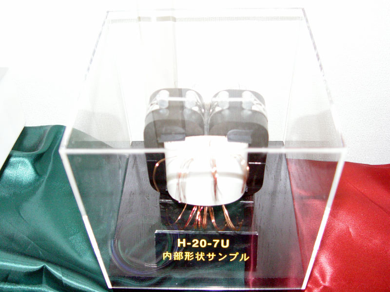

Too expensive, this model are C core or EI?I just went with Hashimoto H-20-7U for 1 watt amp, albiet it will also have O-Netics level II IT's. But will let you know how the H-20-7U sound. I should have them by next week & am ready for install. I struggled with same delima, so I flipped a coin in my head & called Isao Asakura & placed the order. Now I can relax.
J & G
His site are missing these important details.
C core.this model are C core or EI?
Oh nice, as this core not laminated wonder what steel is this?C core.
I have see our coleague Aldovan member are doing similar transformers for 300B.
Steel-Lab HIFI audio transformers
https://www.ebay.com/sch/aldovanr/m...ELcAAOSwwAda~bvh&rt=nc&_trksid=p2047675.l2562
They ARE laminated. Can't you look at the pictures?
The non laminated cores are the amorphous ones for example.
