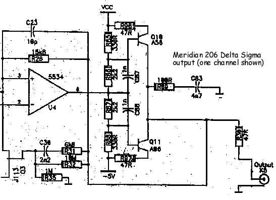

I have just received the schematic from Meridian Audio (see image attached to this post) and I've measured the DC offset of my 206DS CD player.
I have read in my multimeter a DC voltage between 0.000 and 0.001 volts in both channels but I can't see an output capacitor in series with the RCA sockets to blocking DC.
I think 1mV is a very low offset, but I'm still concerned about the possibility of drifting in these values. What do you think about this?
Is there any situation that can induce an anormally increased DC offset? If so, what are the possible effects on the equiment connected to the CD player? (remember that the amplifier has no input capacitor)

R85, R86, R87 and R88 are to adjust DC offset to near zero. That's why it does not need a capacitor.
If you put a DC into the amp input. This DC may be amplified and output to speakers/headphone. Large DC into speakers/headphone will damage them.
In your case the DC offset is quite low. That's is within Meridian intention in this design. It will not cause problems unless the CDP is deffective.
Just one point left to consider.
At switching the power on or off on Meridian might create momentary offset in output. This is the condition where power supply lines may start or drop differently and the output might have an offset !! But any good headphone should survive it without any damage.
