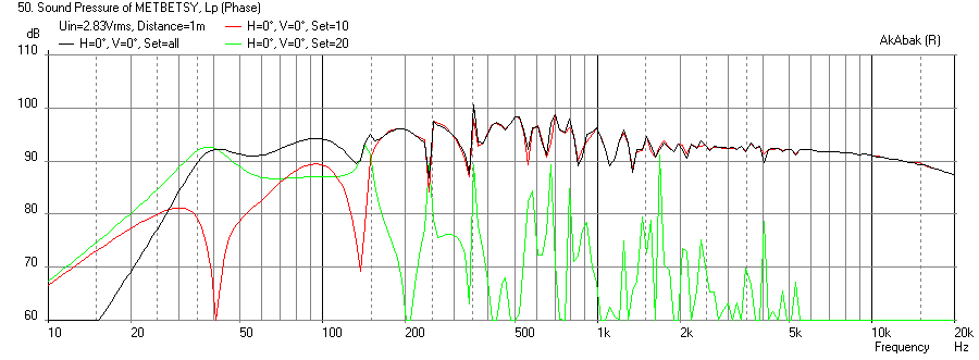

Here is a design that might work - it is big though as you would expect for an 8 inch driver. Dimensions in inches. Use a 1.5 mH + 4 ohm BSC.
Code:
Width_top = (8.00 * 0.0254);
Depth_top = (2.00 * 0.0254);
Height = (60.0 * 0.0254);
Width_bot =(26.0 * 0.0254);
Depth_bot = (16.00 * 0.0254);
Leg_Height = (3.0 * 0.0254);
Driver_pos = (23.0 * 0.0254);   | Distance from top
| Port depth and length
Port_len = (2.6 * 0.0254);
Port_dia = (5.0 * 0.0254);

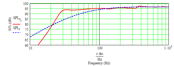

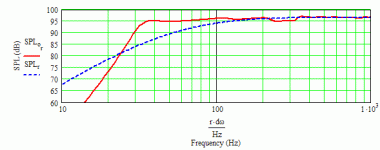

Very close to a MLTL I posted/was built the other year on the WBAL forum, which performed quite well [1st plot], so looks like a winner. Note that minimal damping sims a full 10 Hz shift lower than AkAbak! Not sure if I believe it though.
GM

It's 60" tall same as your Met with a constant [rectangular] taper, dual 6" dia. x 3" vents, driver down 24" Vs your 23", 267.466"^2 CSA Vs your 416"^2, so ~9.287 ft^3 Vs your ~5.944 ft^3.
Smaller footprint, much larger net Vb for greater acoustic efficiency and easier to make, so other than for cosmetic related considerations, positive tapered cabs rarely make sense to me.
I call a positive taper like the Met a ML-horn Vs MJK's ML-TQWT.
