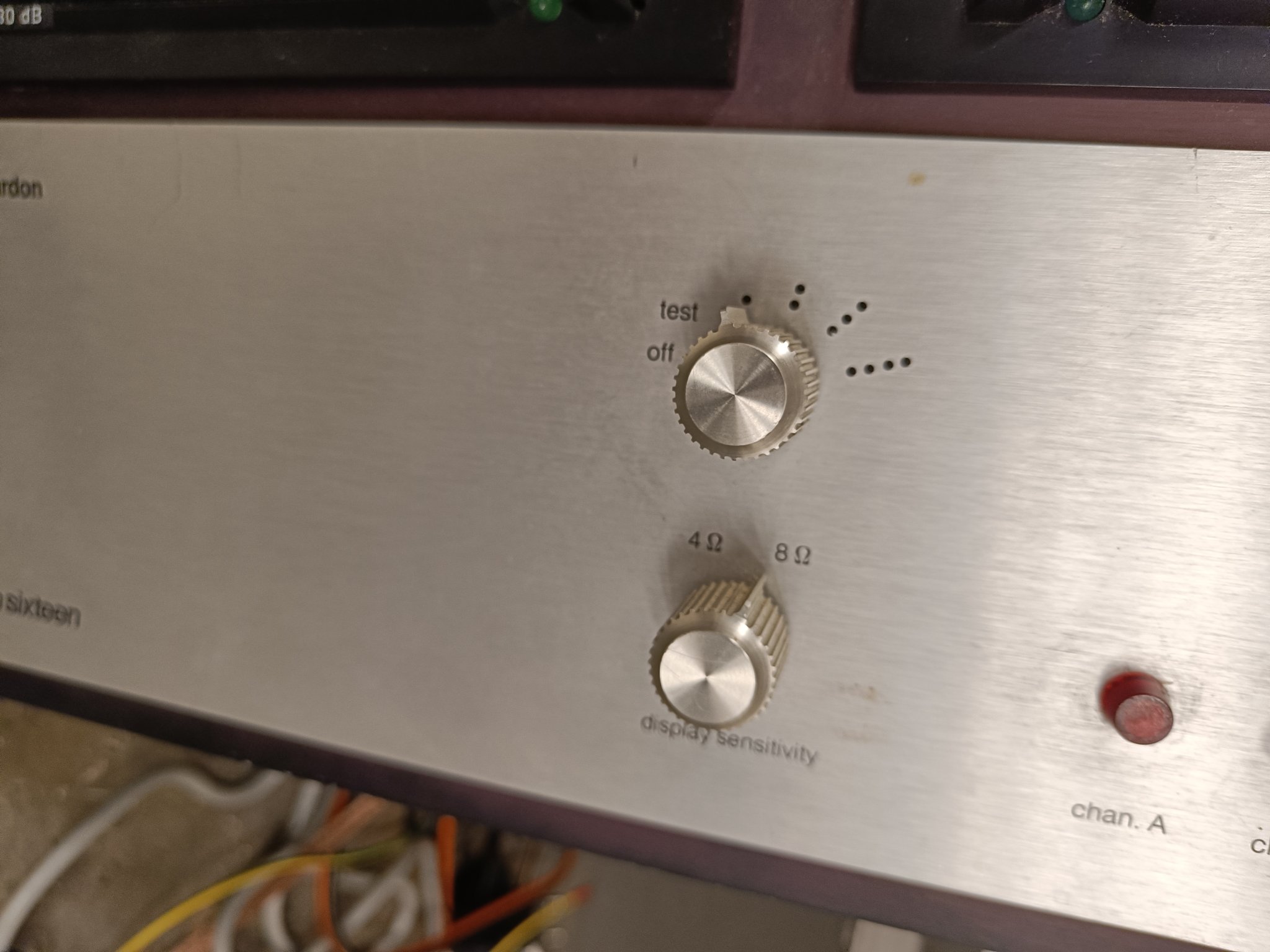

Channel A is on the first picture

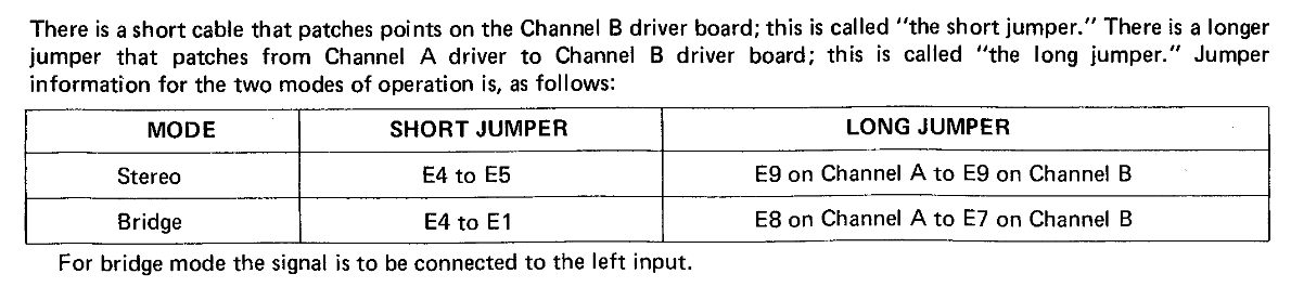

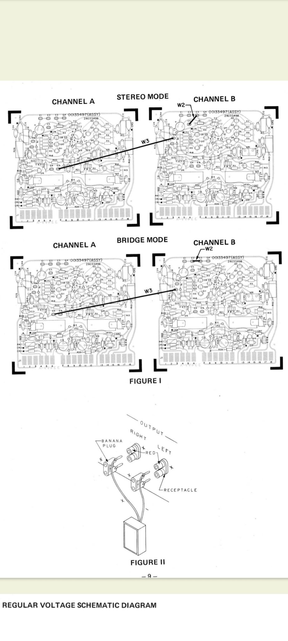

The wiring It don't end upp...dose anyone have the manual for this amp. It's a 220/240v
How to wire from stereo and bridge ?
