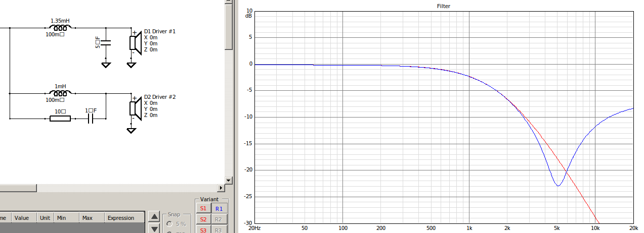

I thought I'd share something I made for another thread. It shows the idea of fitting one filter to another. It shows that the other filter type can be fairly simple and doesn't always need to be the same type. It also shows prioritising of the higher level output.
No claims that this is helpful and it is a starting point not a finished example.

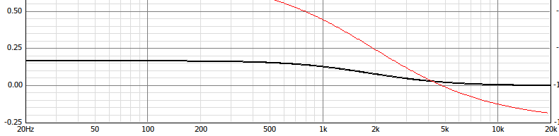

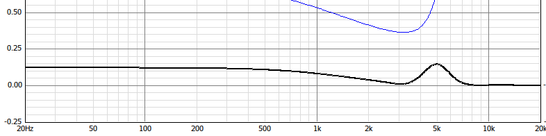

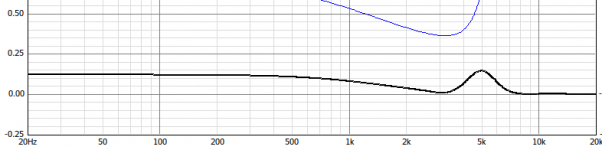

For example, the above plot.. The article says group delay was preferred in the Hardman crossover. I've shown two plots below (group delay is shown black). The one with the red phase trace is the normal looking filter from above and the one with the blue phase trace is the hardman type.
If you assume that the below 4k region is the more important, the group delay is more relaxed for the hardman type. By the way, don't be put off because I didn't make the dip more sharp like the example. Changing it to do this is not hard.
Some like to take out the axial peak around driver breakup, and would line that up with the filter dip if the resulting crossover frequency fits in with the tweeter.
