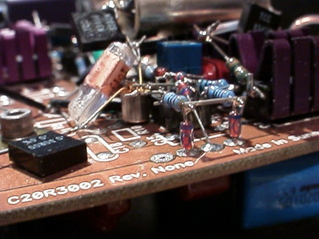

Personally, I would suggest that rather than using wire, as much as possible you use the component leads. Solder joints definitely degrade the sound, and their number therefore should be minimized.

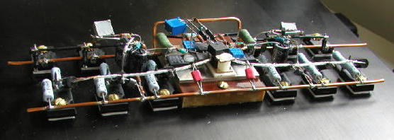

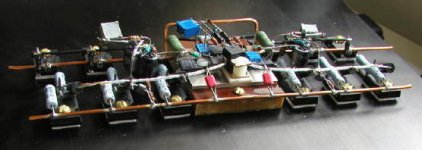

Check my thread here http://www.diyaudio.com/forums/showthread.php?s=&threadid=3840 to see how I wired Aleph X. For rails I like to use 14 ga. solid copper wire used for in wall AC installations. I also use the components leads whenever possible. I like Kimber 19ga wire for signals and 14 ga wire for high current. I don't take the insulations off, but heard it improves sonics. Recently started to use silver wire, because I bought it cheap.
