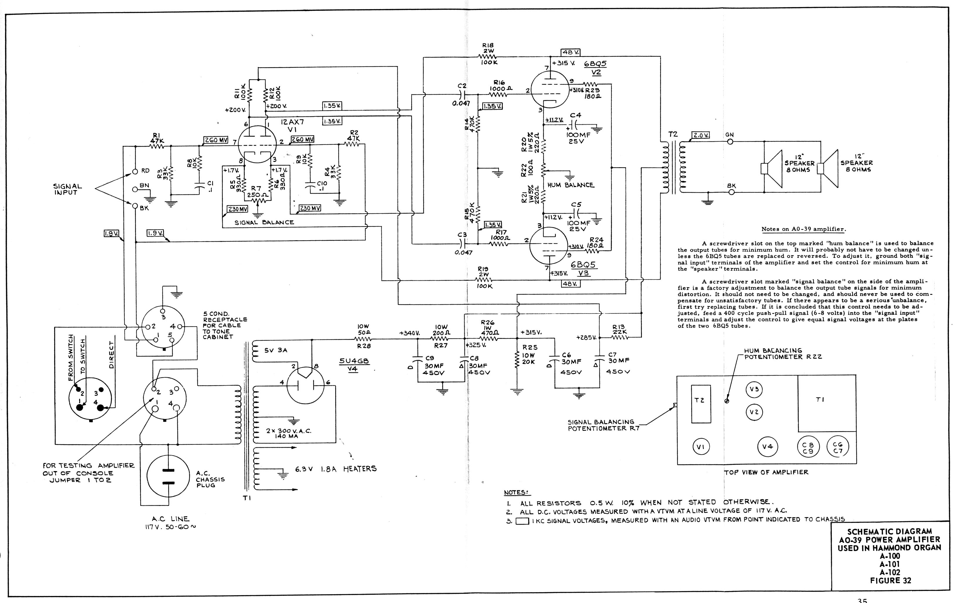

I've got a Hammond AO-39-2 I would like to use as a simple power amp. I don't really need to make it a self contained guitar amp, just a basic power amp that I might stick in a nice old radio wooden cabinet or something for general use.
Firstly, is there any difference between an AO-39-1 and an AO-39-2? I can't find any reference to this online.
I would probably be looking to use the line level output of something like a guitar preamp pedal or guitar amp line out to feed the Hammond.
The speaker connection is obvious. For the input can I just wire a jack to the "sig input" wires (red and black) and use it that way or should I fit a capacitor inline or use something like a 500k pot to adjust the input signal?
Also I have read that these amps have the high frequencies limited somehow as standard. Is there a simple way to undo this?
Most of the info I find is for converting this type of amp to something else, like a guitar amp, but I would like to keep it as simple as possible if it will work like that, with any volume or tone adjustment done at the input source.

First, there is very little difference if any at all in the -1 and -2 versions.
You are correct in your thinking of needing a line level input as this was the power amp for the A series organs. But you can't input on the black and red because the signal input to these has already been inverted in the preamp. That 12AX7 is just the driver stage for the 6BQ5s. This is why the amp is a good candidate for a conversion because it's constructed this way. That 12AX7 is not the phase inverter.
I've attached the schematic. See how the red and black each go to one half of the 12AX7 and each plate of the 12AX7 connects to one 6BQ5 via C2,3? So each half of the 12AX7 is driving one 6BQ5. You will need to provide an already phase inverted signal to use the amp as is and to input the signal as you describe.
So to do a conversion, you re-wire that 12AX7 as the phase inverter and add a preamp. An EF86 works nice and the power tranny will handle the extra tube fine.

The problem you face with wanting to just add a preamp on the front of this amp is that all the preamps I know of don't come with a phase inverter at it's output, so you are faced with somehow adding a phase inverter to the preamp. It might occur to do a stereo input and just use this as a two channel amp but you run into problems with the two 6BQ5s running their outputs into one output tranny. With both tubes sending the positive AND the negative halves of it's signal to one OT, you run into problems. So the only solution I can think of is to either turn the existing 12AX7 into a phase inverter or add one to the end of the preamp you get.
Just a note to think about for more gain from the existing AO-39 amp, remove R8 and C1 on one half and R9 and C10 on the other half of the 12AX7. This gets rid of that filtering you were wondering about. Then increase the grid leak resistors, R3,4 from 33k to either 500k or 1 meg ohm. This will increase the gain considerably. See the input given as 1.9 volts but only 260mV getting to the grids? Doing the above two changes will give you the maximum gain as the amp sits right now. So a much smaller than 1.9 volt input should drive the amp fairly well. But you still will need to split the signal(add phase inverter).

Yes, as I see it now the easiest way for use as a mono amp is to use the existing 12AX7 as an inverter. I would like to find a nice old radio cabinet or something to bung it in, keeping it simple by only needing an on/off power switch and a vol pot on the input.
That's good info about the filter/gain part. I was unsure what was going on there and I probably wouldn't need the filtering anyway for my purposes.

Those AO numbers means you have original OEM speakers for Hammond by Rola. And regarding your resistance measurements from before one time reading 12 ohms and the other 9 ohms, if you look at the schematic, it says both speakers are 8 ohms, so your output tranny is for 4 ohms since they are wired in parallel. You might need to check the battery in your meter for possibly needing replacement. Those speakers should read about 6-7 ohms. Or they could also have been replaced with other Hammond speakers. But that schematic dictates a 4 ohm load. Usually these amps can handle the mismatch OK but for best operation and max power out, you should match the speakers to the OT.
