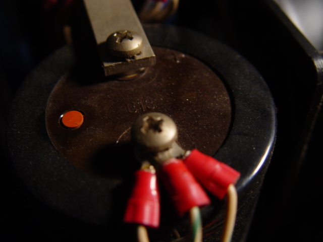

I did open the amp and the two power cap are the original ones I think, I have attached the picture. I noticed that on the negative rail cap the pressure valve is released (?) by the looks of it. The orange rubber is popped out. The positive rail cap looked okay as you can see in the attached images. I also checked the ripple with an o'scope and found it to be 180mV on positive side and 160mV on negative side. Is this okay? Are the caps busted which is causing hum.... Also I noticed that the caps discharge within a minute of turning off the amp. There is not bleeding resistor. Isn't this quick for a 20KuF cap? This is what I could test so far.
I couldn't get to this before today... thats why delayed replies from me as well. I hope this helps... I have also attached the input connectors picture, where the level control pots can be seen for both channels...

I think the caps are OK for now. If a cap vents I would expect to see a pin hole in the rubber and residue around it. There is probably 2 100mfd/100v caps on the driver board that can open up. As I recall there used to be a 47ohm resistor from the input ground to output that used open up.
