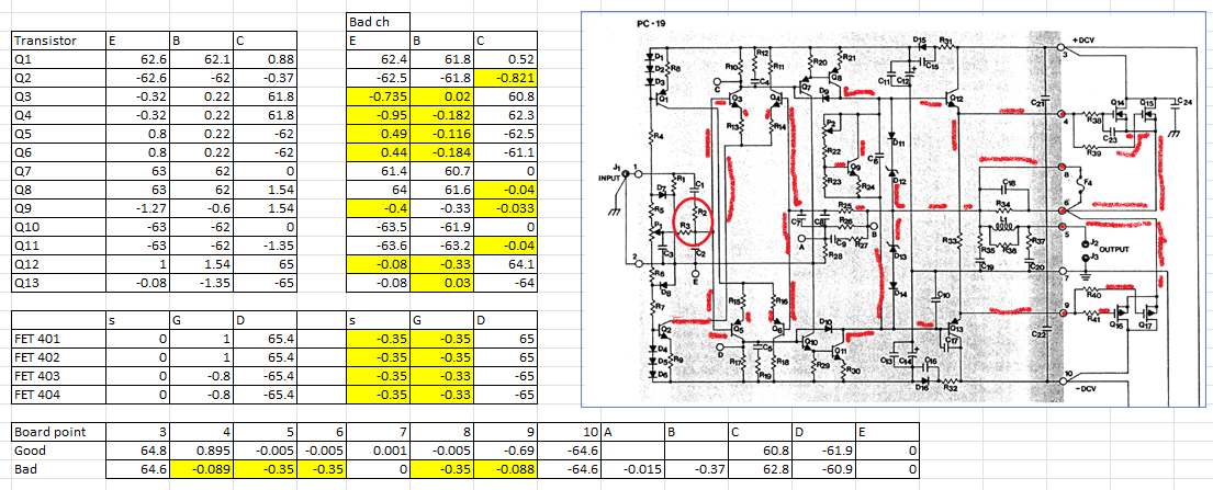

I have pulled all my voltages to compare to the voltages listed in the service manual. It seems all the small signal levels are off (rail voltages and ground are expected). I made a pdf with both the transistor voltages and the voltages at all the terminals and test points.

You nailed it first try! I pulled Q8 and it tested as a diode. Replaced it and she biased like a champ! Thank you, sir!😀Q8 on the bad channel might be bad. The Vbe exceeds 0.7v, by a lot.
