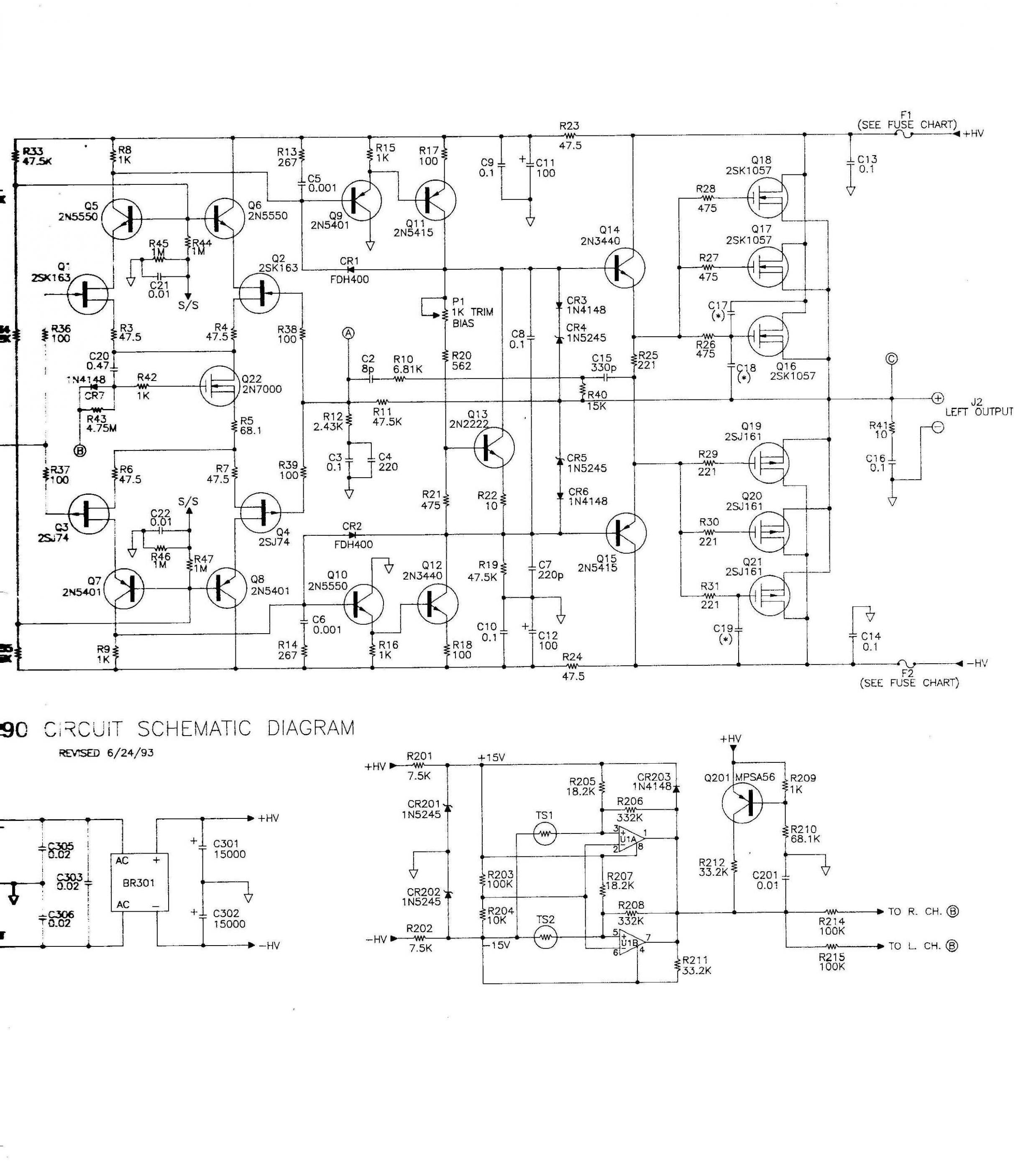

I've worked on a number of Haflers. They're fine amps. Most likely you've got a shorted FET or two in one or both channels. I'd remove both from one channel at a time and check if they're shorted. Keep track of where they came from. If you have only one channel blown, remove those outputs, and you should be able to bring it up.
It is the line fuse (10A, one and only) that was blown. There are 4 other fuses (2 each channel, 7A) that supplier power to the circuitry. 9290 has soft turn on feature. I do not think electric power ever got to pass the soft turn on stage. Attached are Hafler 9290 circuit diagram in two pages. Thanks for all experts help.
I think the problem is in the bridge and the filter capacitors. Reason is that your are not blowing the fuse for the negative/positive voltages. Check for a short in the pins for the ac voltage at the bridge to ground and at the filter capacitor positive side of the bridge to ground. In the way you described the blow of the fuse look like a direct short to ground. Also check the capacitors in the AC side of the bridge.
